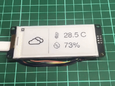

WeatherPaper is a minimalist, always-on e-paper display that shows real-time weather in a calm, battery-efficient way. No glowing screen. No notifications. Just a little glanceable window that quietly says, “Hey, bring an umbrella.”

For the enclosure, you can get as creative or as lazy as you want (no judgement!) I hot-glued the perfboard and the battery onto the back of the e-paper display. I went with a 3D printed enclosure with a translucent (or 'frosted') finish, which is manufactured by JLC3DP with 8001 Resin. Shout out to JLC3DP for making my project look fabulous!
The ESP32 has a tiny red LED as a power indicator. To save power and make it more aesthetic, I carefully flicked it off using a craft knife. Be careful not to damage the PCB trace and components!
Once everything was in place, I fitted the lid and powered it on. It honestly looked like a piece of modern tech art. You might even forget it's electronic.
