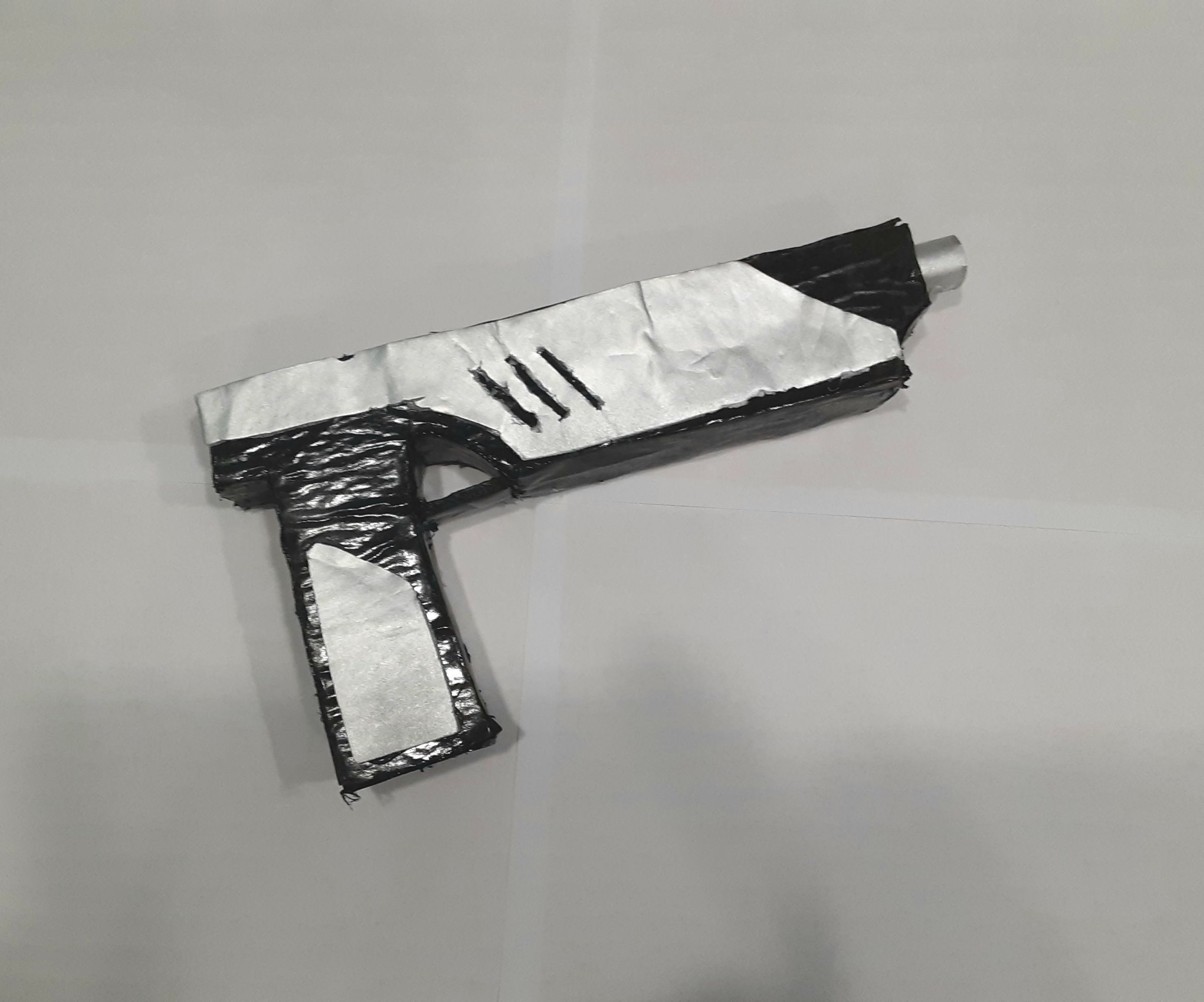

Step 1: Gashes and Scratches
This step may seem usless but really pays of when you do a brown/black wash. For deep gashes, draw a line where you want your gash to go, then use a craft knife and cut into the cardboard at angle on both sides of the line, after that is done paint over the gash is silver. For scratches use an craft knife and lightly, but not too lightly, run the tip of the blade at random over the surface you want scrached.

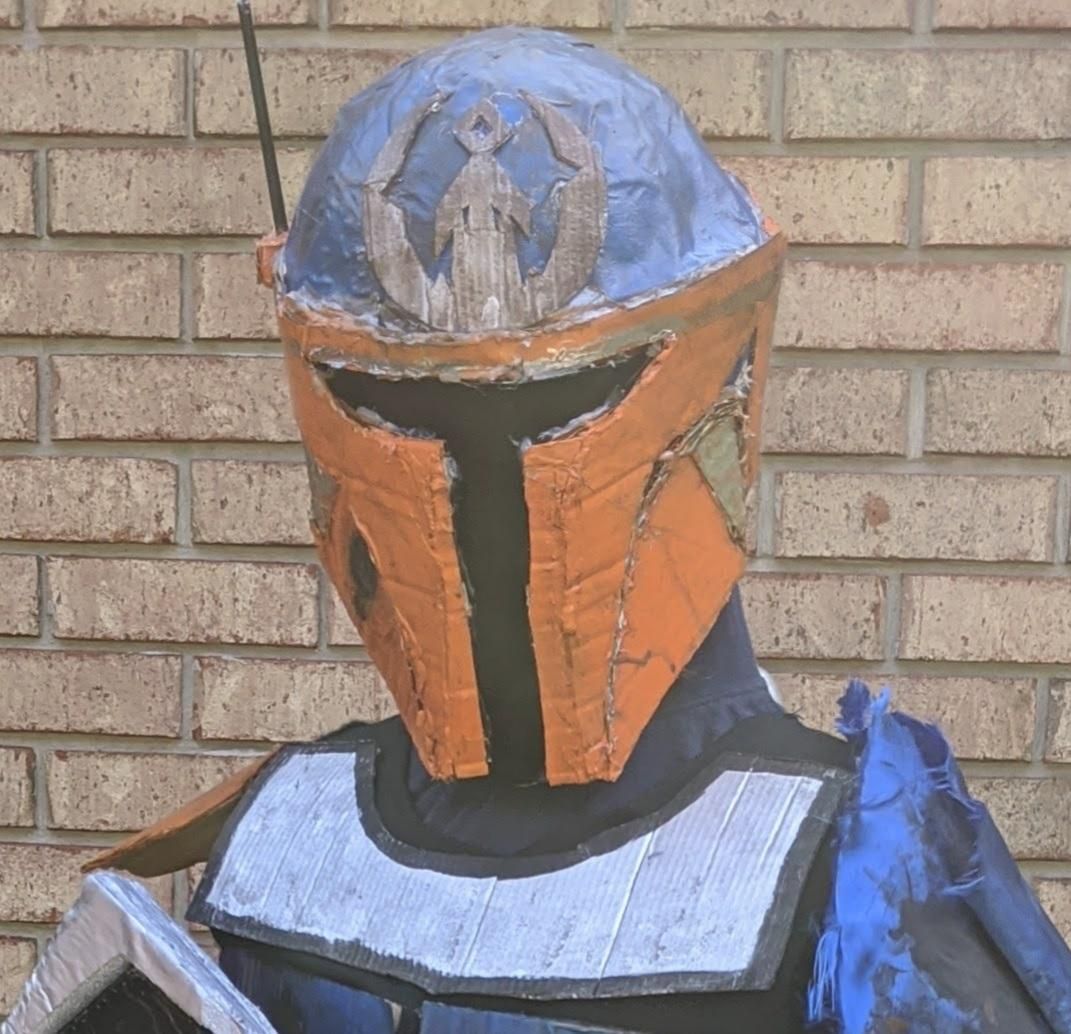

Step 3: Black/Brown Wash
For the black/brown wash take 2 parts water and 1 part black or brown paint and mix them together. Brush a thick layer of the paint mixture of your piece and wait about 15 seconds, this wait allows the paint to soak into to the gashes and really make them pop. After the fifteen seconds are up dab of most of the paint with your paper towel or rag.
