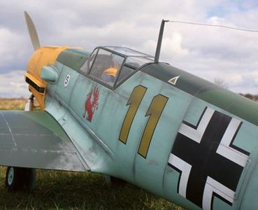

So, where to start? A little more interest in the cockpit would be great, I thought, especially when my clubmates are giving her the once-over in the pits. A bit of wear and tear to the exterior, and maybe a little extra surface detail here and there. Yes, that should do it. I could have gone further of course, but I wanted to keep things really simple and produce a practical finish that I’m not reluctant to take flying.

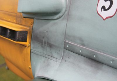

I particularly wanted to stay away from the airbrush this time - super low-tech, in fact! Arming myself with nothing more than a 2B pencil and a scrap of sandpaper, I set about dirtying up the exterior of the fuselage. It’s a simple trick. Rub the pencil on the sandpaper to create a pile of graphite dust, then dip your finger into it and rub the residue gently into panel lines and louvres, and in or around any areas you feel would get grubby - oil filler caps, service hatches etc. - anywhere that anyone would put their mitts. If you want a streaked effect to replicate oil runs and the like then simply wet your finger and wipe over the graphite - it’s simply amazing, giving a slightly metallic sheen at the same time. Try to imagine how the ingress of dirt and grime would be affected by airflow. If you overdo it then a simple pencil eraser or (even better) an artist’s putty rubber removes the offending splodge.
To add some highlights, get hold of a fine-nibbed silver paint pen from a stationer’s and hint at the edges of panel lines here and there. Don’t lavishly draw around every last detail - be a little ‘arty’. Tell yourself ‘less is more’ and you’ll wonder why you haven’t used this trick before.

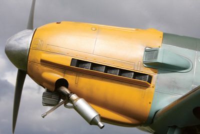

Moving forward a little, you’ll see there’s a nice cowling to play with. Here, exhaust stubs were suitably sooted up with flat black enamel and then dry-brushed with silver and rusty brown to give a little depth. The cowling also has two very prominent channels for machine guns, and lengths of brass tubing do just fine in representing the muzzles, with judicious dirtying-up to give that cordite-scorched look. Moulded recesses for cooling holes were opened up, and panel edges touched in with the silver paint pen to finish things off.

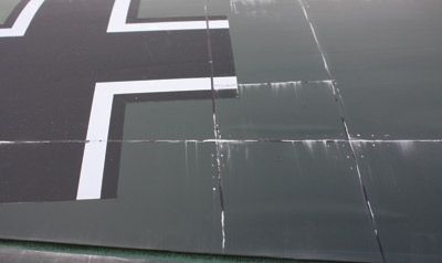

The wings are by far the largest part of the aeroplane to add a little life to, in fact I found these much more difficult to do than the fuselage. The ‘109s wings are Solartex covered, completely smooth, and devoid of any panel detail. A 3-view of the Messerschmitt downloaded from the internet gave me some pointers, and I eventually settled for hinting at the odd panel line and rivet with a mixture of black marker pen and silver paint pen highlights, scuffed with a finger whilst still wet to add a bit more interest. A strip of masking tape laid along the panel lines gives a nice edge to rub a bit of pencil lead into here and there, to break it up further. Mind you, it’s easy to overdo things and end up with something more toy-like than we started with. If you’re not comfortable at doing such detailing and don’t want to cock it all up, then my advice is to practice on something less important, or leave well alone!
The biggest visual impact you can add is to dry-brush some silver enamel onto the leading edges, representing wear from the airflow and debris damage from the prop. A chunk of sponge or foam rubber, dipped into the paint and then dabbed almost dry on a piece of kitchen tissue, gives a nice mottled effect for this. You could add extra surface detail, too (some marques of ‘109 had 20mm cannon in the wings) but I chose not to bother - just another thing to break off ‘twixt car and workshop! Finally, to seal the surface finish I sprayed on matt polyurethane lacquer, and that was that.

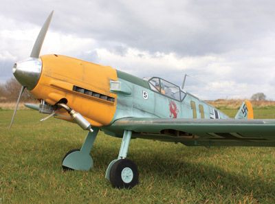

So there we have it. My ‘109 may not be F4C scale, but it no longer looks like a toy aeroplane. It oozes character and actually looks a little menacing. The model now draws a lot of admiring glances and really does appear more like the battle-weary tool it mimics. The cockpit section raises the most questions, particularly the instrument panel, which, ironically, took the least amount of time!
All the techniques employed here can be mastered with relative ease, and I hope I’ve proved that you just need a little imagination and some reference material to turn an everyday sport-scale ARTF into something quite special.
