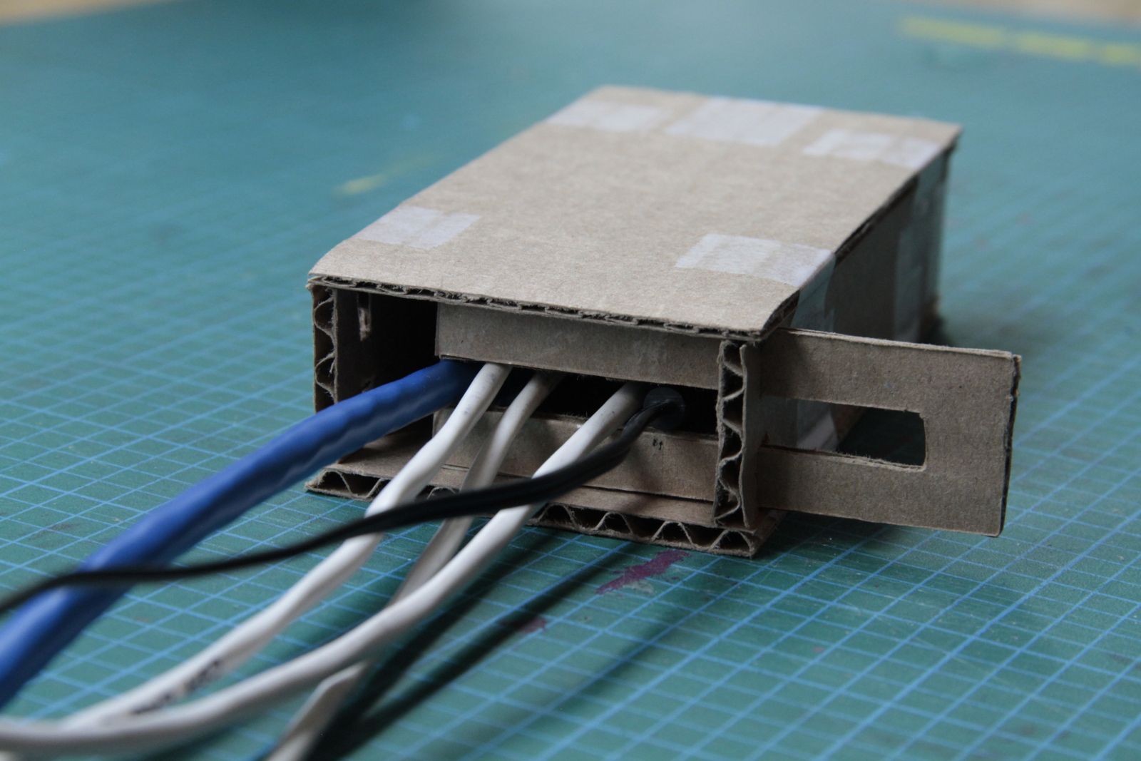

Step 2: Basic Design

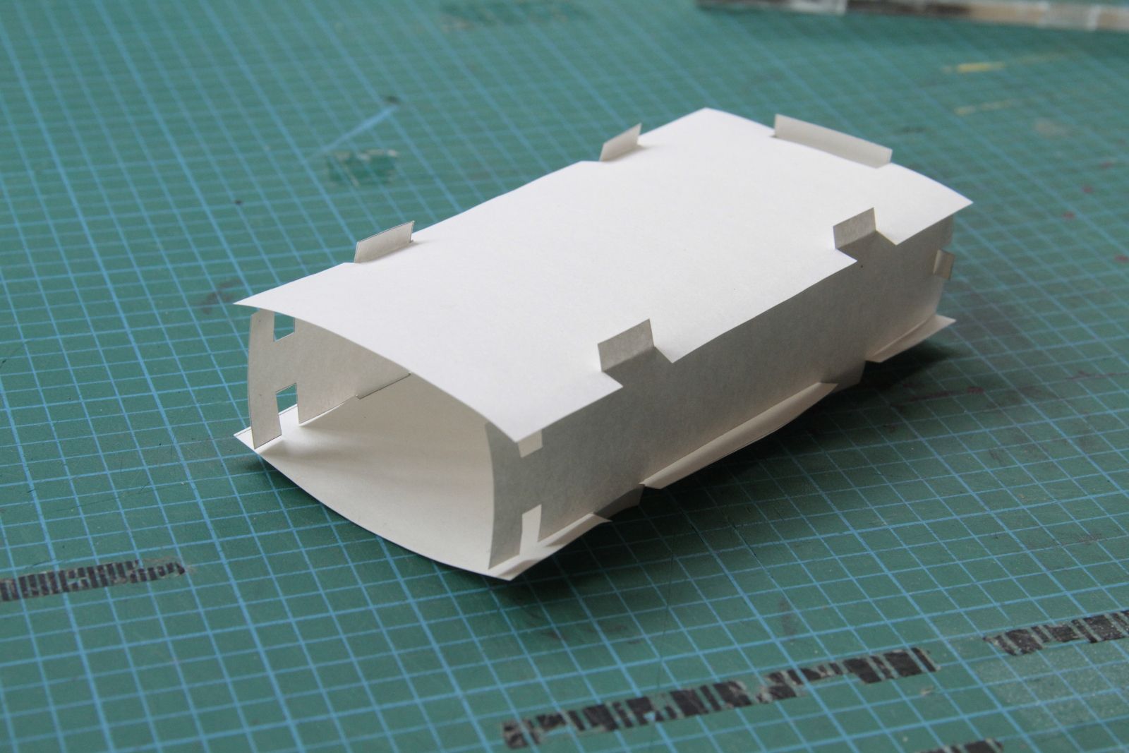

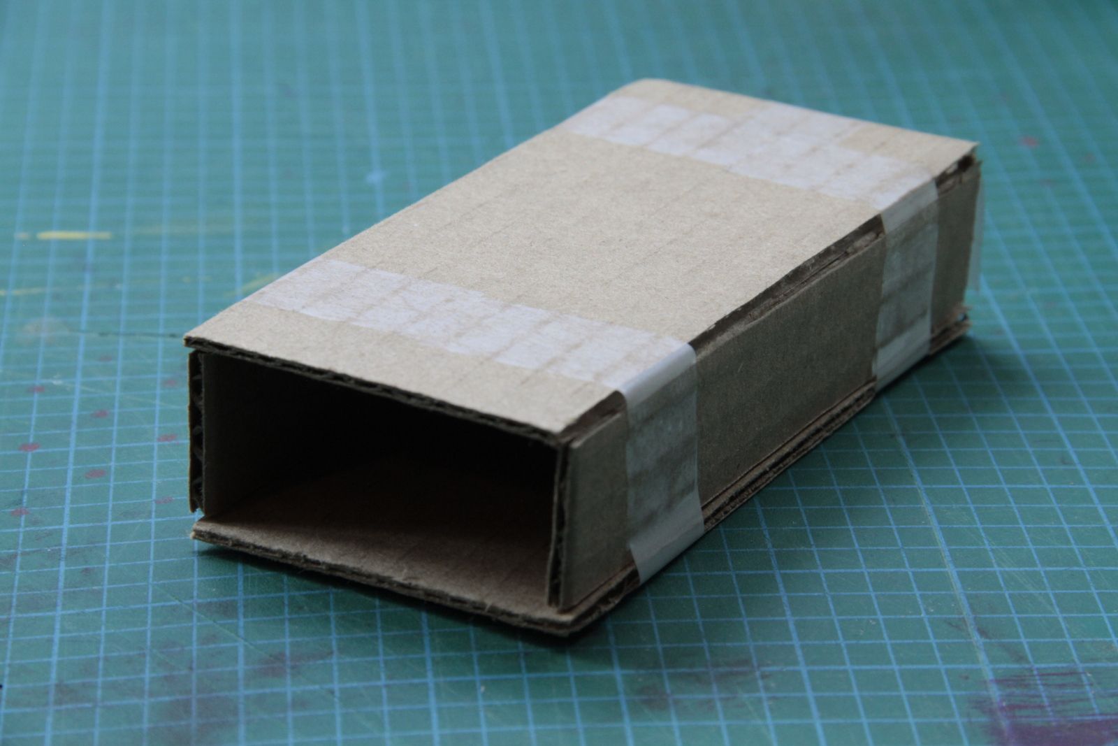

Cardboard prototype
First, measure the exact dimensions of your electronic components. That'll give you the inner dimension of your rectangular enclosure. In our case the enclosure was designed as tight as possible, to not allow for any movement of the Arduino inside the housing. We'd recommend you now tape together a first prototype box made from thick cardboard. Holding a box in hands always makes it easier to think about how to further design it's functionality.
How to open the enclosure
The first problem to solve: How are you going to open your enclosure? Instead of giving the enclosure a lid, like shown in the image above, we opted to only leave an opening on the shorter side. It allows to slide the Arduino in from that side, and leaves all the other panels and edges to be permanently closed and therefore waterproof.

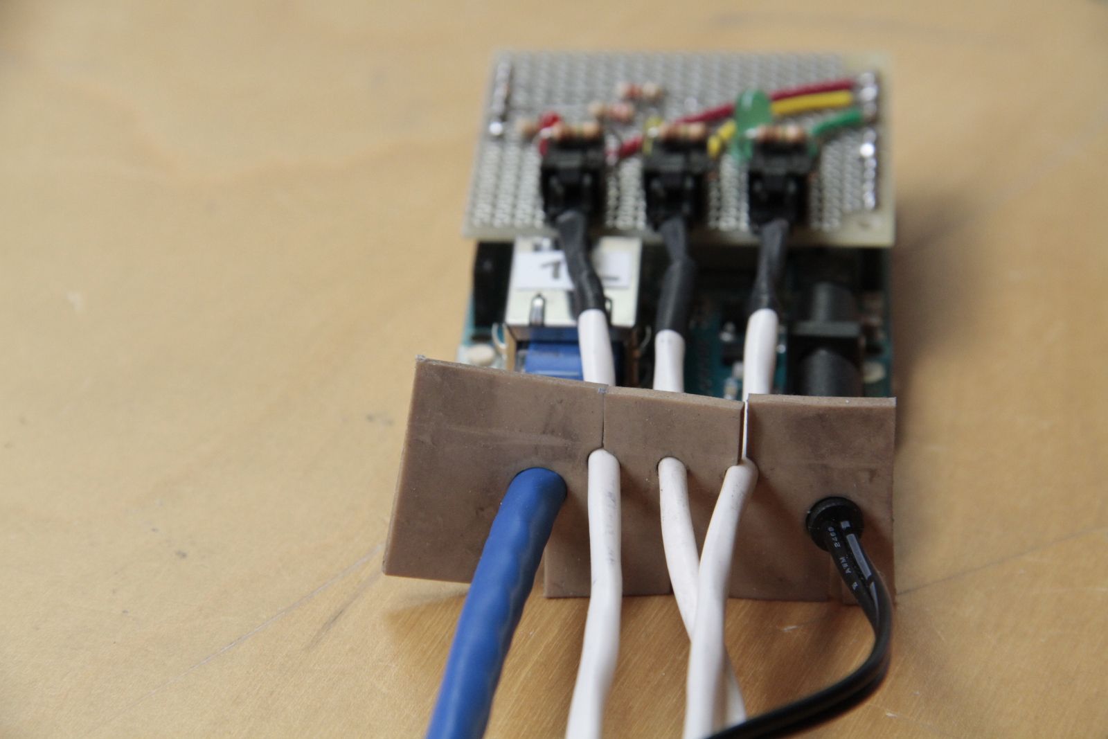

The locking gate
To block the open side of the enclosure that has all the cables exiting, we designed a “locking” gate that can be slit into the enclosure from the outside, and forms a locking wall with a narrow pathway in the middle for the cables. (To weatherproof the opening that still exists we'll add a rubber layer with exact cutouts later in Step 7!)

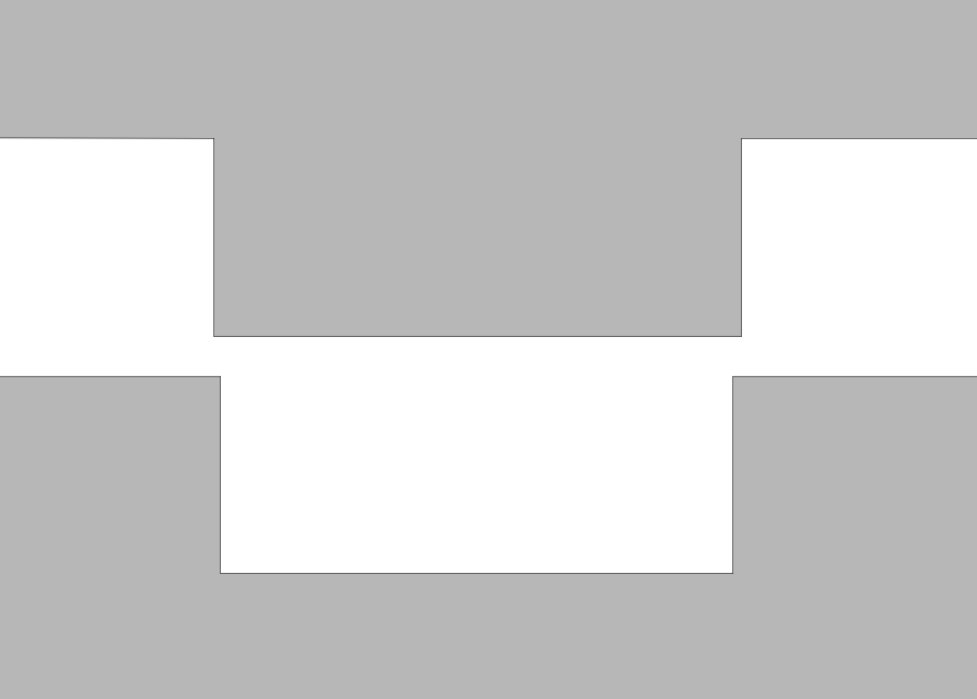

Design box joints with vector software
After the basic design is done, it is time to make the exact drawings with a vector software (free+opensource:inkscape). To join the enclosure walls to each other, we went with a basic box joint / finger joint method, where you cut your walls with square puzzle-edges that fit together perfectly. If you plan on having flush enclosure edges, you’ll need to know the exact depth of your acrylic sheet beforehand, to know how deep to draw the joints. For our enclosure we went with transparent 3/16 inch acrylic - mainly because it provided more glueing area than 1/8 inch acrylic and felt less bulky than 1/4 inch acrylic.
Don't forget to add flanges with screw holes, so you can mount the enclosure to a stable structure.
By the way: there are software options - like BoxMaker - out there that allow you to generate box joints easily. For more flexibility and custom needs though, you’ll be better off drawing your own design.

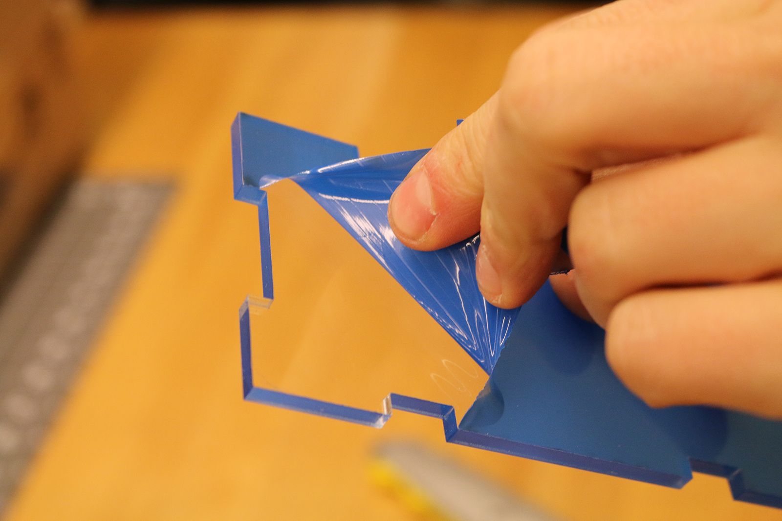

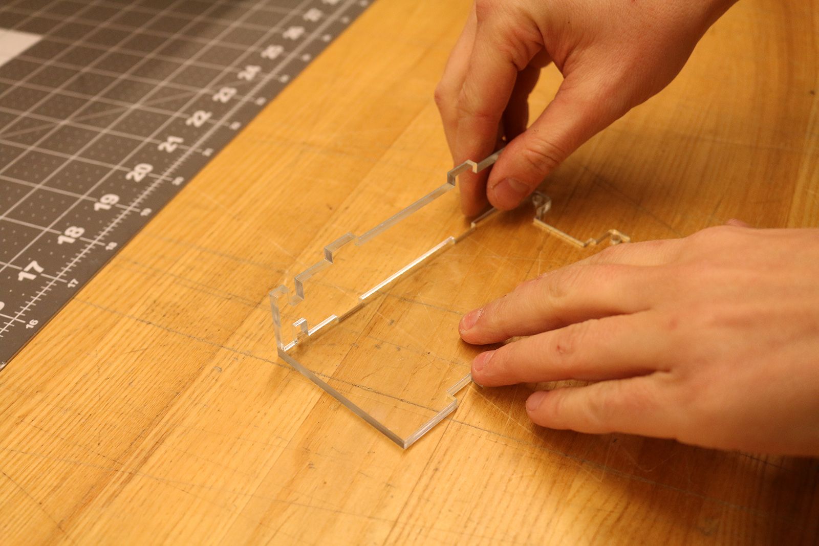

Dry assembly time
Once your are done cutting, peel off the protective plastic film off your lasercut parts. And now to the fun part: align the notches and snap your box together! If the notches are tight, the box will hold together by itself. Which is a good thing for the next step of gluing, because then you won’t need an extra hand or some clamps to hold it all steady.

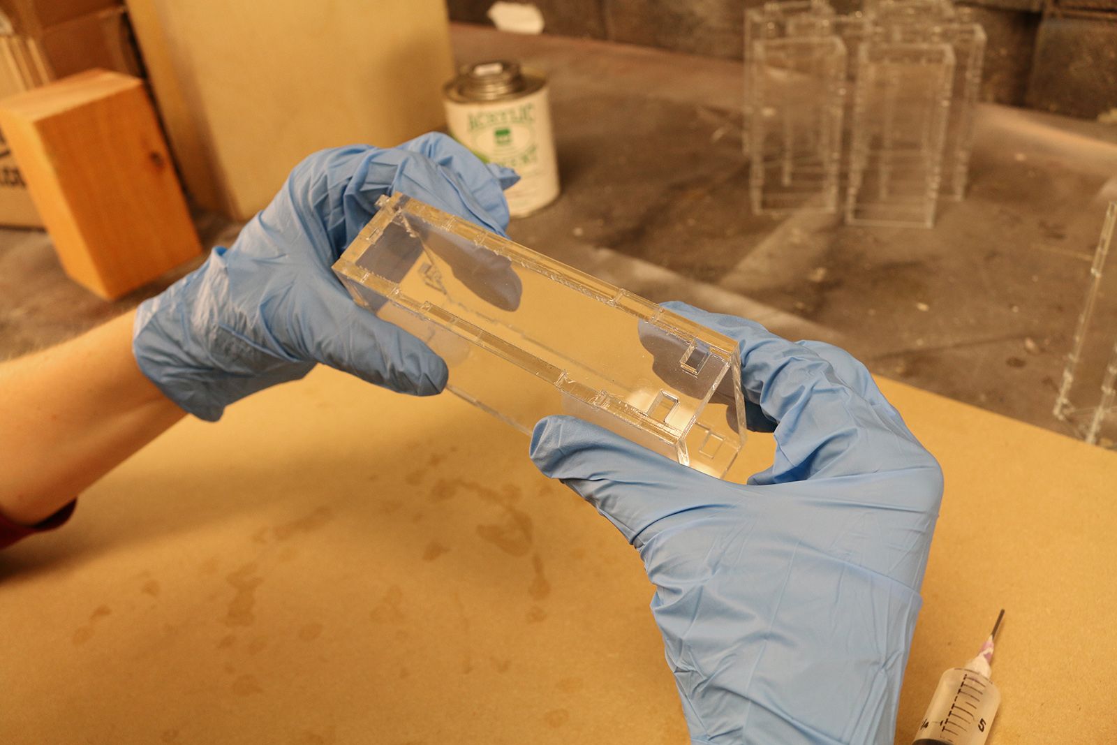

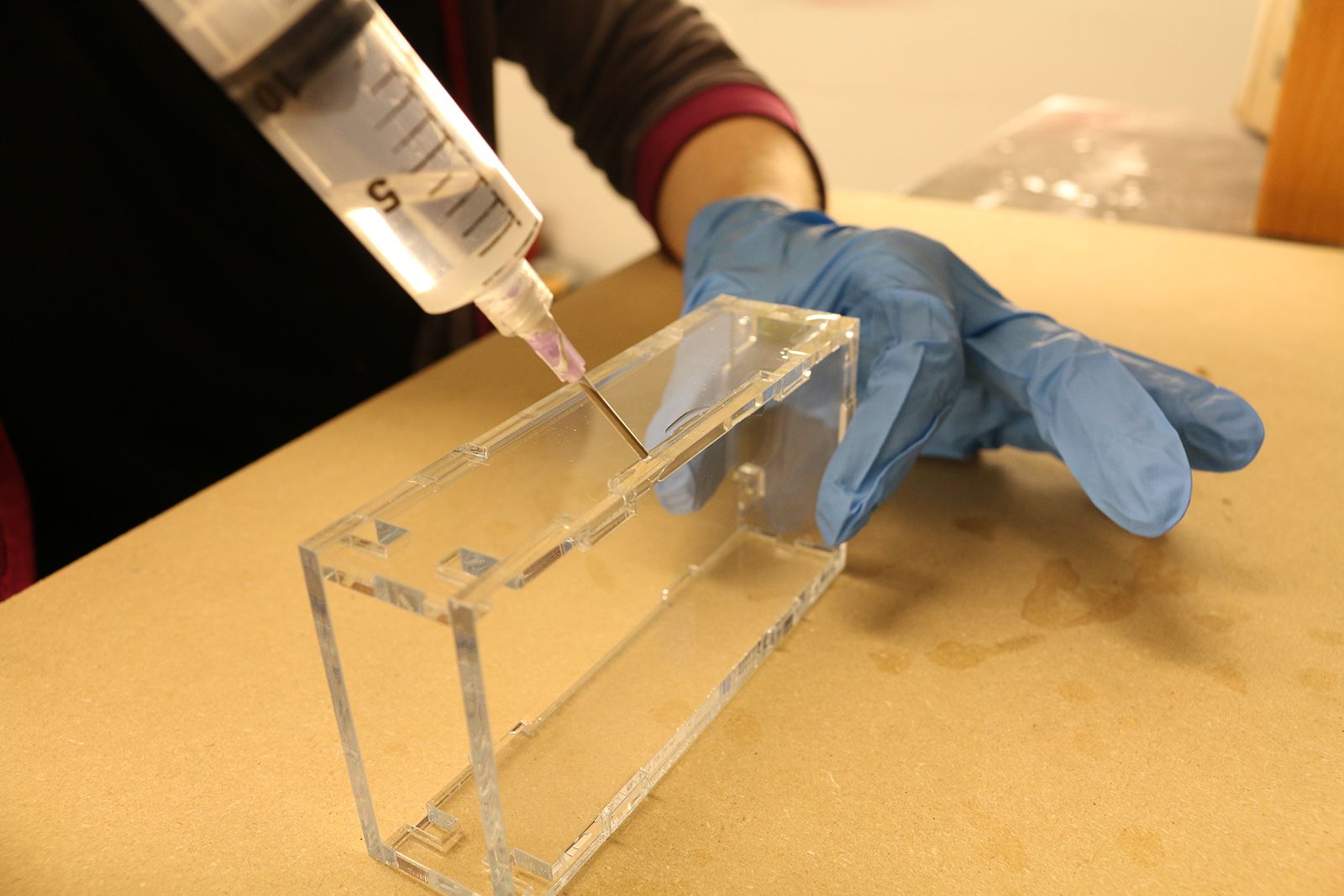

Step 5: Glue Acrylic
Chemical welding
Acrylic can be glued together with acrylic cement, which is a solvent that actually melts and chemically bonds acrylic surfaces to each other - hence name "chemical welding"! We used TAP Acrylic Cement. For applying it you’ll need an appropriate applicator (bottle or syringe), some disposable latex gloves and safety goggles.

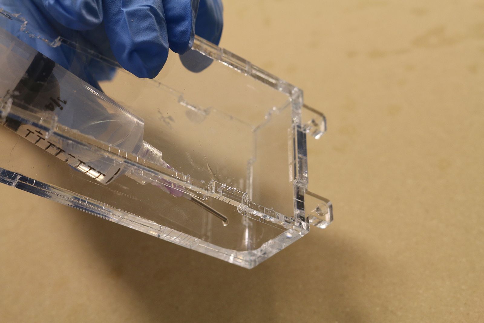

Glue along edges
Take your already assembled acrylic box and apply the glue along all the edges and notches. Even if your notches are tight, you will still see the glue spread in between them. It's better to apply more glue than less.
Once you've glued all the edges of the box, hold it tight for a little while, trying to apply pressure to all glued joints at once. The bonding should be already very strong after 10-15 seconds. After that you could put some extra weight on the box, while it sits for a bit. After 24 hours the bonds should be as-good-as-it-gets.

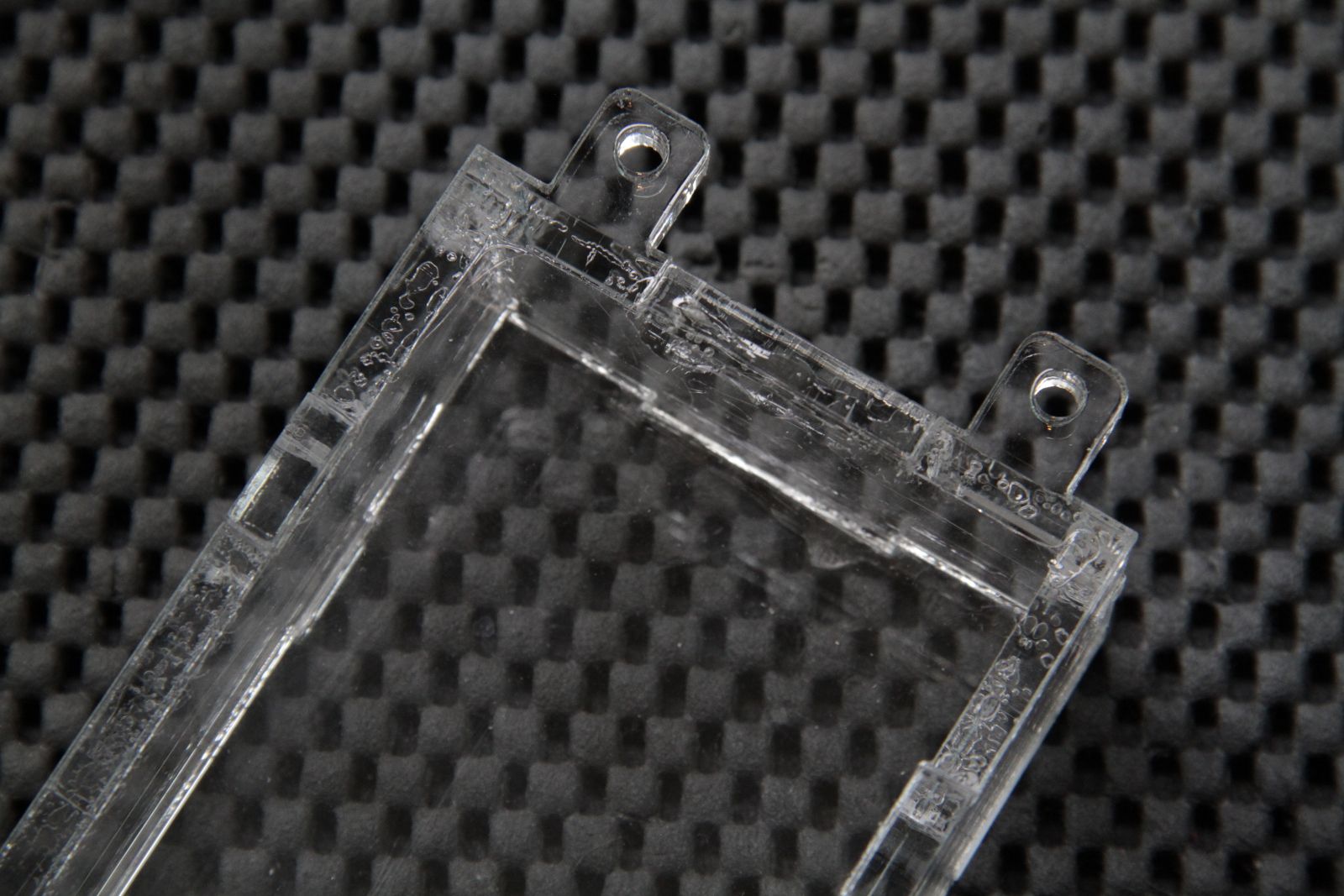

Double-glue the top panel
The mountable flanges on our box are on the top of our enclosure and therefore the surface most likely to be hit by rain. To make sure all the glued edges of the top panel are really solid, apply an extra layer of acrylic cement to it: After the first round of glueing and drying, drop a little pool of acrylic cement into one of the corners of the enclosure. Then slowly swivel the box around for the extra glue to reach and cover all the inner edges.
Waterproofness over prettiness
If you are - like us - more concerned with the waterproofness than the prettiness and cleanliness of your box, you should definitely use more glue than necessary. The extra glue that spills out will evaporate quickly. It’ll leave some smears on the surface, but at least you can be sure that no water-drop will be able to enter through those edges.
