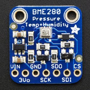

  • An Adafruit BME280 (temperature, humidity and pressure sensor)

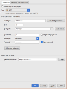

Go to file --> settings --> Build, Execution, Deployment --> Deployment
Create a new SFTP connection.
SFTP host --> ip address or hostname of the raspberry pi click on test SFTP connection if the connection has succeeded you can go to the next step.
port: 22
root path: /home/username
username : username of the root user of the raspberry pi
auth type: password
password: password of the root user

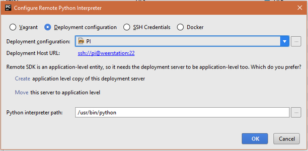

Go to file --> settings --> project:"project name" --> project: interpreter
click the cogwheel in the upper-right corner and select deployment configuration. In the drop down menu select the SFTP connection you just made and click on Create application level copy of this deployment server. apply everything and close the settings menu.
Now you should be able to upload python files from pycharm to your raspberry pi.

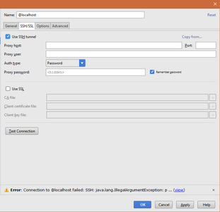

use the shortcut ctrl+shift+a and search for database, press enter. Now you should see a new screen on the right. press the green add button and select datasource-->mysql
In the general tab add the name of the database and username and password of the mysql user we created earlier.
In the ssh/ssl tab check use ssh tunnel.
  • Proxy host is the ip address of the raspberry pi
  • we use port 22
  • proxy user --> root user of the raspberry pi
  • auth type = password
  • proxy password --> password of the root user.

BME280
The BME280 is as combined digital humidity, pressure and temperature sensor. It works on I2C or SPI. In this project I used I2C because it needs fewer connections.
The BME280 consists of ADC output values. Each sensing element behaves differently. Therefore the actual pressure and temperature must be calculated using a set of calibration parameters.

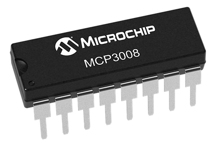

MCP3008
This chip will add 8 channels of 10-bit analog input. It uses SPI.

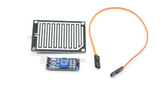

YL-83 water drop sensor and board
The YL-83 can be connected to a digital pin as well as to the MCP3008 to get an analog value. The digital output is a 0 or 1 and the analog output is in a range of 0-255
In this project I connected my YL-83 to a digital pin because I just wanted to know if it was raining or not.

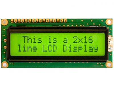

LCD
Last but not least is the 2*16 LCD that shows us some viable information on the housing of our project.

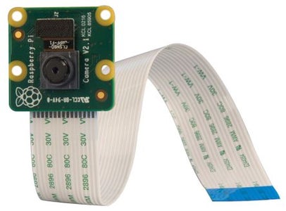

Gently push the picamera into the picamera slot.
BME280
  • Connect the vin pin to 3v3
  • Connect the GND pin to the ground
  • Connect the SCK pin to the SCL pin
  • Connect the SDI pin to the SDL pin
MCP3008 and anemometer
MCP3008
  • Connect the VDD pin to 3v3
  • Connect the VREF pin to 3v3
  • Connect the AGND pin to GND
  • Connect the CLK pin to SCLK
  • Connect the Dout pin to MISO
  • Connect the Din pin to MOSI
  • Connect the CS pin to CEO
  • Connect the DGND pin to GND

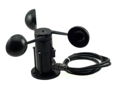

Anemometer
In order for the anemometer to work properly we will need a power supply of atleast 7Vdc and a maximum of 24Vdc
I used a regualr 9v battery.
  • Connect your 9v power supply's GND to the same GND rail your RasPi and MCP3008 are using.
  • Connect the anenometer's black wire to that same GND rail.
  • Connect the anenometer's brown wire to 9v.
  • Connect the anenometer's blue wire to the MCP3008's CH0 pin.
The YL-83 can both measure analog and digital values. Since we just want to know if it rains or not we will be connecting the digital pin. When we read a 0 it means it is not raining and when we read a 1 it means it is raining.
Control board
  • Connect the D0 to a GPIO pin I used #5 note if you use another gpio pin you will have to change this in the code aswell.
  • Connect the GND pin to GND
  • Connect the VCC pin to 3v3
Detection board
Connect one pin to the + on the control poard and the other to -

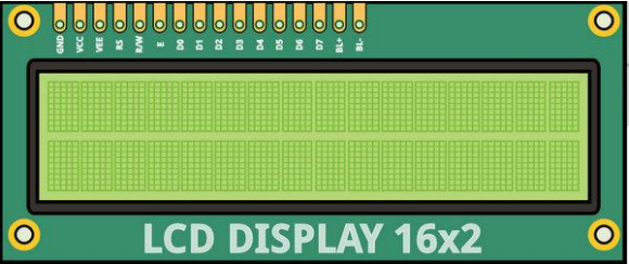

LCD
We will be using the LCD in 4bit mode. This means we will need less pins to interface the LCD.
  • Connect the VCC pin to 5v
  • Connect the VE pin to a trimmer
  • Connect the RS pin to GPIO-pin 21
  • Connect the RW pin to the GND
  • Connect the E pin to GPIO-pin 20
  • Do not connect D0 - D3
  • Connect D4 to GPIO-pin 16
  • Connect D5 to GPIO-pin 12
  • connect D6 to GPIO-pin 25
  • Connect D7 to GPIO-pin 24
