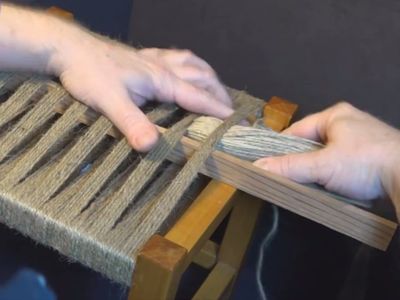

Step 3: Weave Weft
First you need to separates warp's even no. groups (goes up) with sticks.as shown in images. repeat it back side also .
Again wrap 5 times and sixth around for spacer.
Now take warp;s odd no. and separates with stick.see you will get odd-even cross lines.
again wrap around 5 times and repeat this procedure till its complete.
Tie final string with the help of needle.
This seat has 17 rows and 17 columns .
