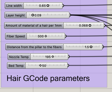

When I opened the program, it was so complex I didn't want to change much, but i first change the line width and added more material per hair. so I created a more dense weave than the original.

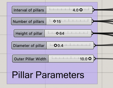

I couldn't figure out how to change the size at first, but with help I realized the Pillar params was where I could effect the size, I made the weaving longer and taller.

I noticed the data node, was not linked to the large full grasshopper system, so I linked them here. it turned a node from red to green and I was able to export the gcode, so I think it was the right thing to do!

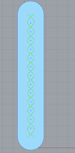

This is how my grasshopper code looked in Rhino before I exported the gcode, for the second larger version

The first print (before I realized I could adjust the size in grasshopper). came out ity bity and super dense.
So I created a larger one and spaced out the pillars more. it's currently printing and I will upload a picture when it's done.
