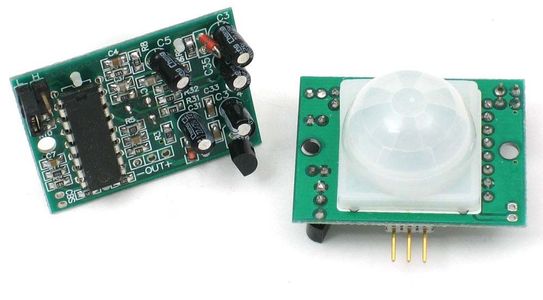

PIR Sensor:
PIR sensor senses the infrared radiation emitted by human beings thereby sending an equivalent signal to the arduino microcontroller.There are three pins on
the PIR sensor: voltage (a), digital out (b), and ground (c). For this project, the PIR sensor’s
digital out pin will be connected to PIN2, which is a digital PIN that reads a signal of 1 or 0. The
voltage pin and the ground pin will be connected to the 5V and GND pin slots, respectively
You can take the help of jumper wire to connects those pins, like I soldered in my case.

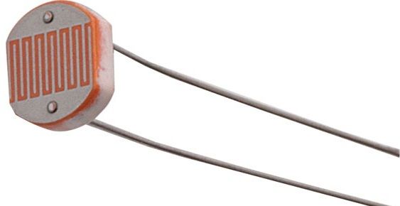

LDR:
Light Dependent Resistor, the resistance hence voltage varies according to the variable which is Light in this case.
The LDR used in this project determines the light intensity in the room, say when the room door is closed with no light source active, will have darkness(so the intensity shown will be less) and when one opens the door Light intensity increases.
The LED(which is pointed towards the LDR) simulates the lighting conditions in a room.

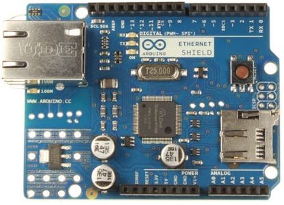

Ethernet Shield:
The Ethernet Shield is very crucial component in transmitting the results obtained via a network(here a LAN). This component acts as a server. And should be stacked upon the ARDUINO board(so that you can use the pin slots). You can find that out in the picture clearly.

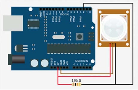

Step 4: How to Make the Connections
Connecting the wires may be a little bit tricky at times, I have used an LDR and LED for serving up as light detector and source of light respectively, in one go...
But for simplicity sake, I would suggest you to make it one after another, then summing them up will be child's play(those who know working with Arduino won't find it trickier).
Connect the GND wire to GND pin slot.
Connect the VCC wire to the 5 V pin slot.
Connect the output wire to PIN 2 slot with a 10 Kohm resistor.
I have shown the required connection in the diagram, you can find more convenient to follow it from there.

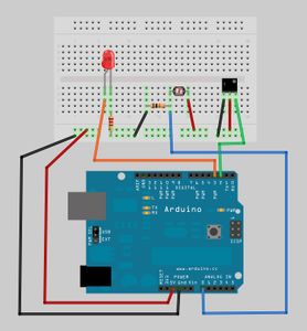

Step 5: Complete Connections
Here's the diagram involving all the components(the PIR sensor, LDR and LED)
There's no hard and fast rule that you should connect it in this way, I did my project few days ago, and the diagram later so, you should ensure connecting them in proper manner for the correct measurement.

-You can cover the portion of the white hemisphere of the PIR sensor, with a black tape if you want to concentrate the field of detection.
-and there are two pots on the PIR sensor one for sensitivity, and the other for time delay, you can adjust them according to your desired application.
