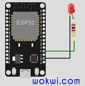

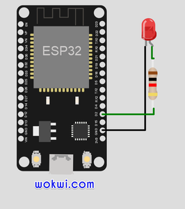

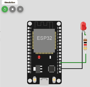

Blinking an LED on ESP32 is the "Hello World" program. In this project, you will see how easy it is to blink the LED present on the ESP32. Also, you will find out the comfort of having an ESP32 simulator instead of real hardware with wires, soldering, initial setup, power options hassles. It is always good to have a simulator handy when you don't have actual hardware.
In this section, you will see the connection diagram plus the simulator in action for the project to function properly. The resistor in series helps the LED current to be under safer limits.
The code for the Blink LED project is here:
#define LED 2
void setup() {
  pinMode(LED, OUTPUT);
void loop() {
  digitalWrite(LED, HIGH);
  delay(50);
  digitalWrite(LED, LOW);
  delay(50);
You can also tinker with the ESP32 Blink LED project online. Just click this Link! You will be able to modify the code and see the results instantly. Sharing the project is very easy when you are working with Wokwi ESP32 Simulator.

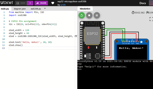

In this ESP32 simulator project, you will connect an OLED display to the ESP32. You can print status messages, temperature, distance etc. OLED displays are very bright and suitable for outdoor as well. They look great and will be a good addition to your next ESP32 simulator project.
Here is the code
from machine import Pin, I2C
import ssd1306
# ESP32 Pin assignment
i2c = I2C(0, scl=Pin(22), sda=Pin(21))
oled_width = 128
oled_height = 64
oled = ssd1306.SSD1306_I2C(oled_width, oled_height, i2c)
oled.text('Hello, Wokwi!', 10, 10)
oled.show()
You guessed it right! The Wokwi ESP32 simulator also supports programming ESP32 using Micropython! Try it out for yourself! Here is the link to the live simulation!
