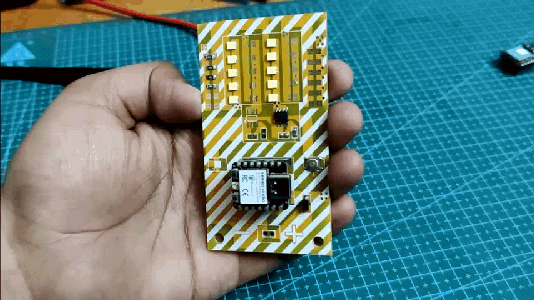

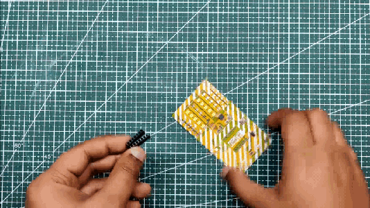

Step 4: PCB Assembly
  • We start first with the solder paste dispensing process by adding solder paste to each component pads one by one.
  • We then used an ESD tweezer to carefully pick and place all the SMD LEDs and components in their assigned places one by one.
  • After the "pick and place process, " we carefully lifted the whole circuit board and placed it on the Reflow hotplate.
  • Next, we place the header pin in the XIAO Pads and solder it with help of a soldering iron.
  • At last, we place XIAO in its place and the LED Board Assembly is completed.

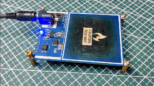

Assembly of the power board or base board is simple; we simply solder a USB Micro THT Port and a DIP ON/OFF Switch to their pads with a regular soldering iron.
For powering the LAMP, a USB cable will be connected to this board.

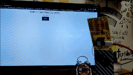

  • After uploading the sketch, we open the serial monitor and allow the ESP to connect to the local WIFI. Once connected, you will see its IP address in the serial monitor.
  • Copy the IP Address and open it into any browser which will let you access the Web page for controlling the LED LAMP.

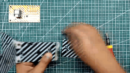

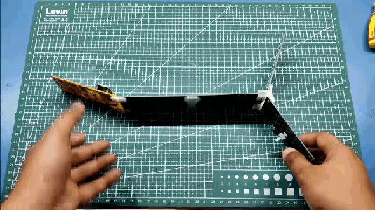

Step 9: Body Assembly
  • We begin the Main assembly by gathering all of the components after uploading and testing the LED Board.
  • We place the 3D Printed Circuit Holder on one PCB and connect it to the other two boards, which will form the bottom stand for the entire lamp structure.

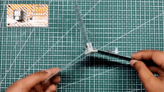

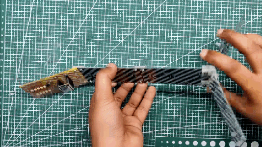

Step 10: Final Assembly
  • Following that, we connect the TOP LED Board to the base part using two 3D Printed circuit holders and M2 screws.
  • Finally, we connect two wires to the Base Board's USB In supply and the LED Board Power IN Port, which will be used later to power this setup via USB.

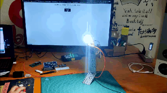

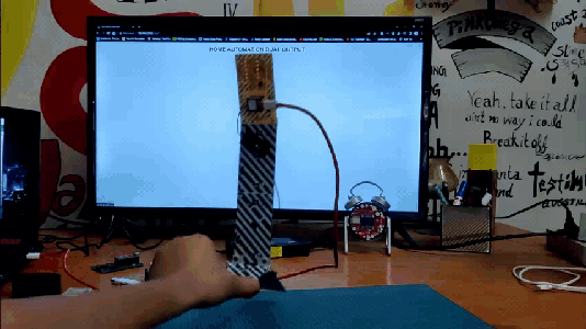

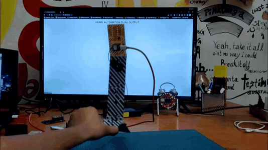

Step 11: RESULT
We copy the IP address we got earlier from the serial monitor and paste it into our web browser (Chrome).
This lamp's web server will open up and have a button for changing the state of the LED from low to high.
By making changes in code, we can add a slider to this webpage, which will allow us to alter the brightness level, which will improve this project a bit more.
Overall, this Web desk lamp, which uses Chrome to access its webpage, is a great example of the integration of electronics and software to create a functional and innovative device.
