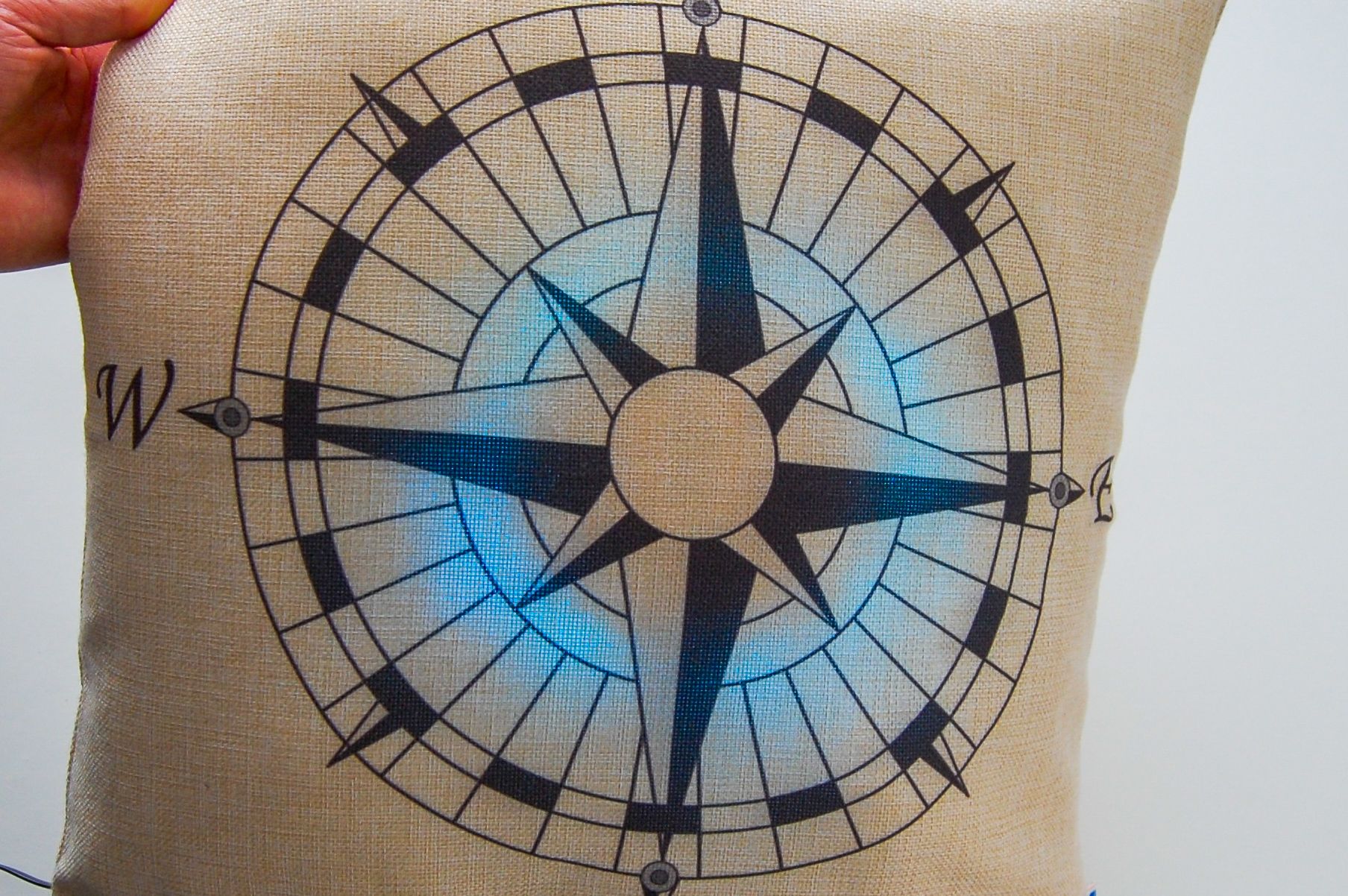

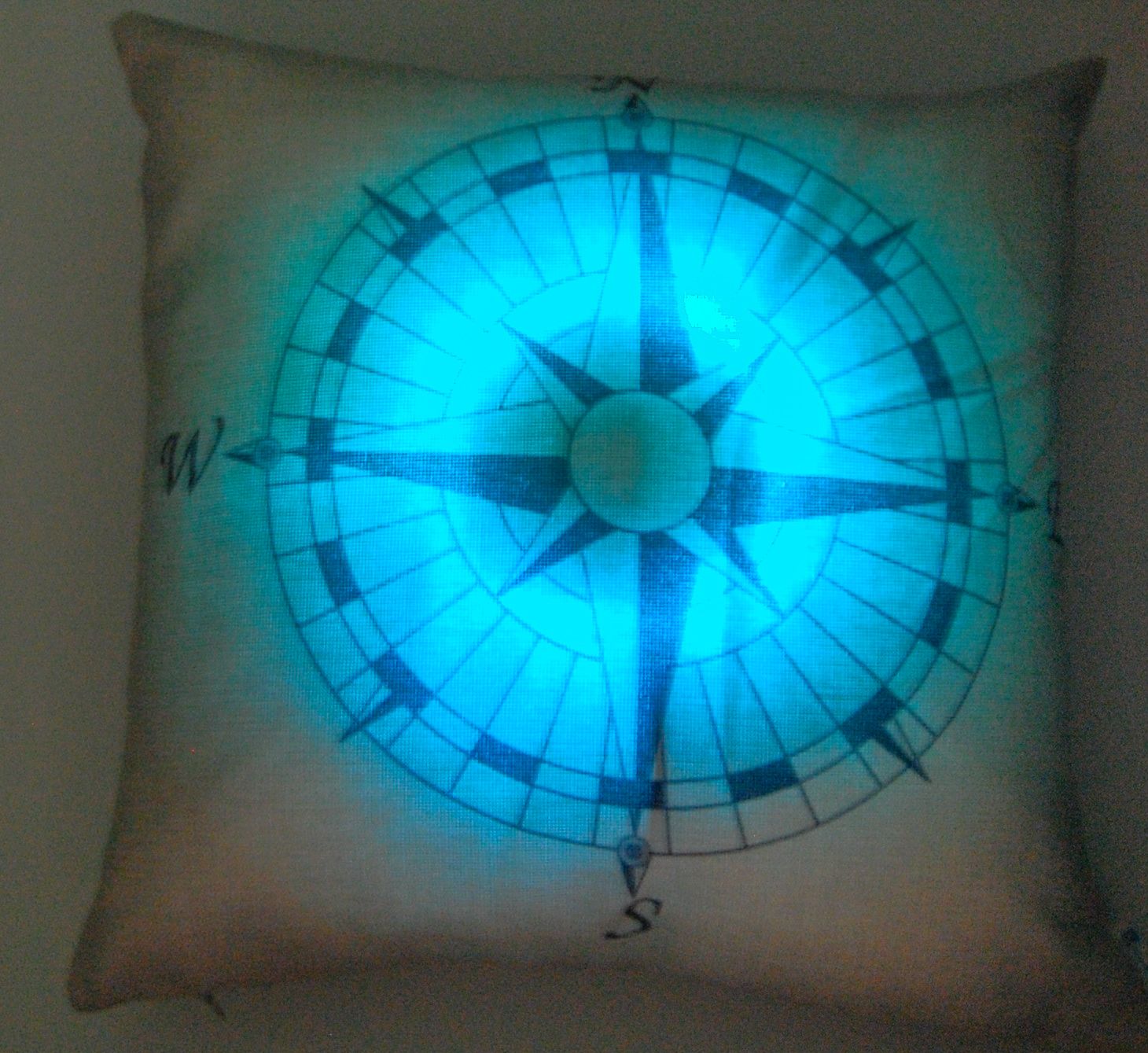

The end product made her (and me) very happy! She simply touches her pillow and mine sparkles, indicating a "call". If I touch mine in response, both pillows will glow cyan which shows we're connected. When I press again both pillows glow red, indicating that I'm "hanging up". Obviously, we both need to be around our pillows at the same time but that's the point; this is meant to be like I'm in the room with her.
We'll use it in the evenings when she's reading and I'm watching TV or on weekends when I'm running around and don't have time to chat. My kids are always "calling" her and get a thrill when she "answers". It's kind of surprising what a small gesture can do for your spirits.

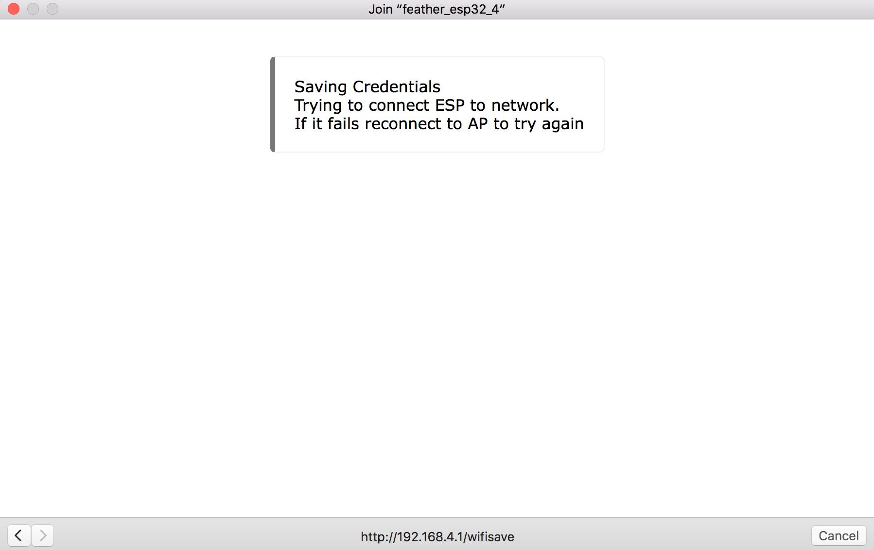

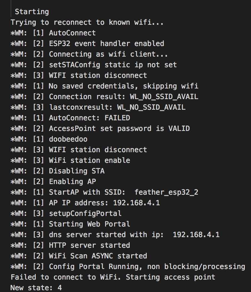

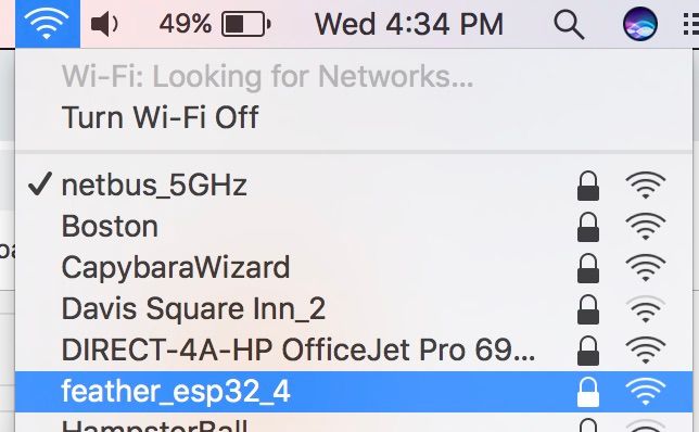

- WiFiManager development branch (supports ESP32 boards). I love the out-of-the-box access point; this makes it super easy to configure WiFi at run-time instead of hardcoding networks and passwords into the firmware. The upshot is I can walk my mom through setup over the phone :-)

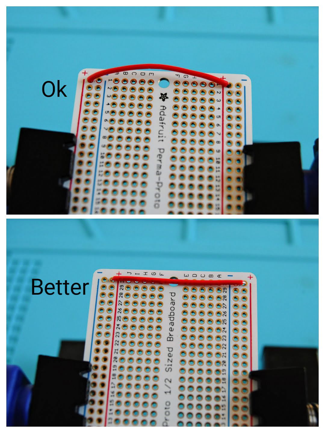

Solder wires and connectors to protoboard. Trim wires as needed. In these steps, hole numbers should be followed exactly when I include a row letter and used as guidelines when attaching to power and ground rails):
- Solder a red 5 cm wire from one power rail to the other across the board
- Solder a black 5 cm wire from one ground rail to the other across the board

- Click Upload and monitor the progress. Once 100% uploaded, open the Serial Monitor in your IDE and you should see the following output
If it worked, you'll see this in the Serial Monitor
Here you can see the network name is set to "feather_esp32_2" and the access point password is "doobeedoo".
Now repeat for the second board.

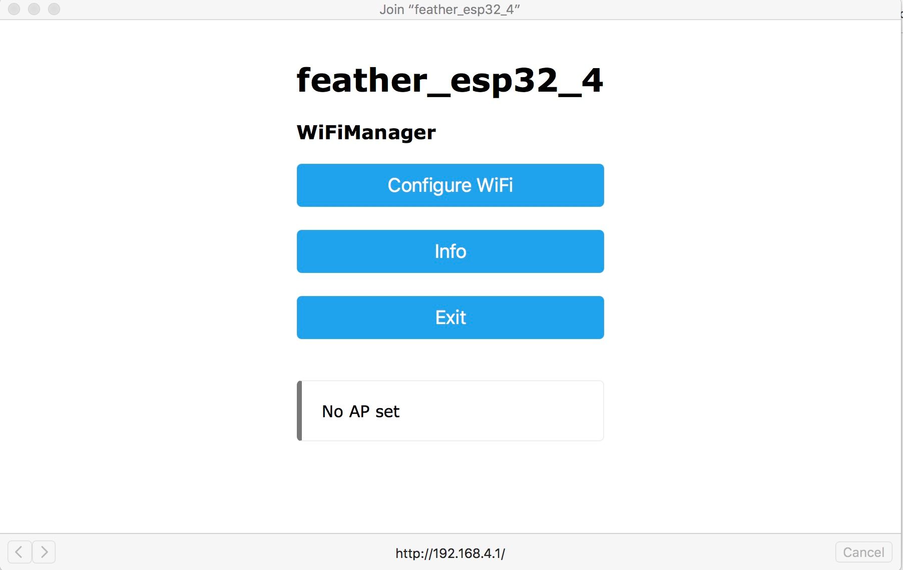

A word about Access Points
What's happening here is that the board wakes up and looks in memory for saved network credentials. If it can't find any, or if it can but the network isn't available, it will start its own web server called an "access point". This access points exists simply to give you a web page where you can tell the chip what network you want it to connect to, e.g. your home WiFi's 2.4Ghz network (note that ESP32 won't work on 5Ghz networks).
With your iOS or Android device, or your computer, check the available WiFi networks and you'll see one named after your thing.
Connect to it using the password you specified in the Config.h file. The animation will probably pause and after a couple of seconds you'll see a pop up screen like the one shown here. The pop-up is known as a "captive portal" and is similar to what you'd see when connecting to WiFi in a hotel. If you accidentally close the window, simply point your browser to http://192.168.4.1 and you'll see the same thing.

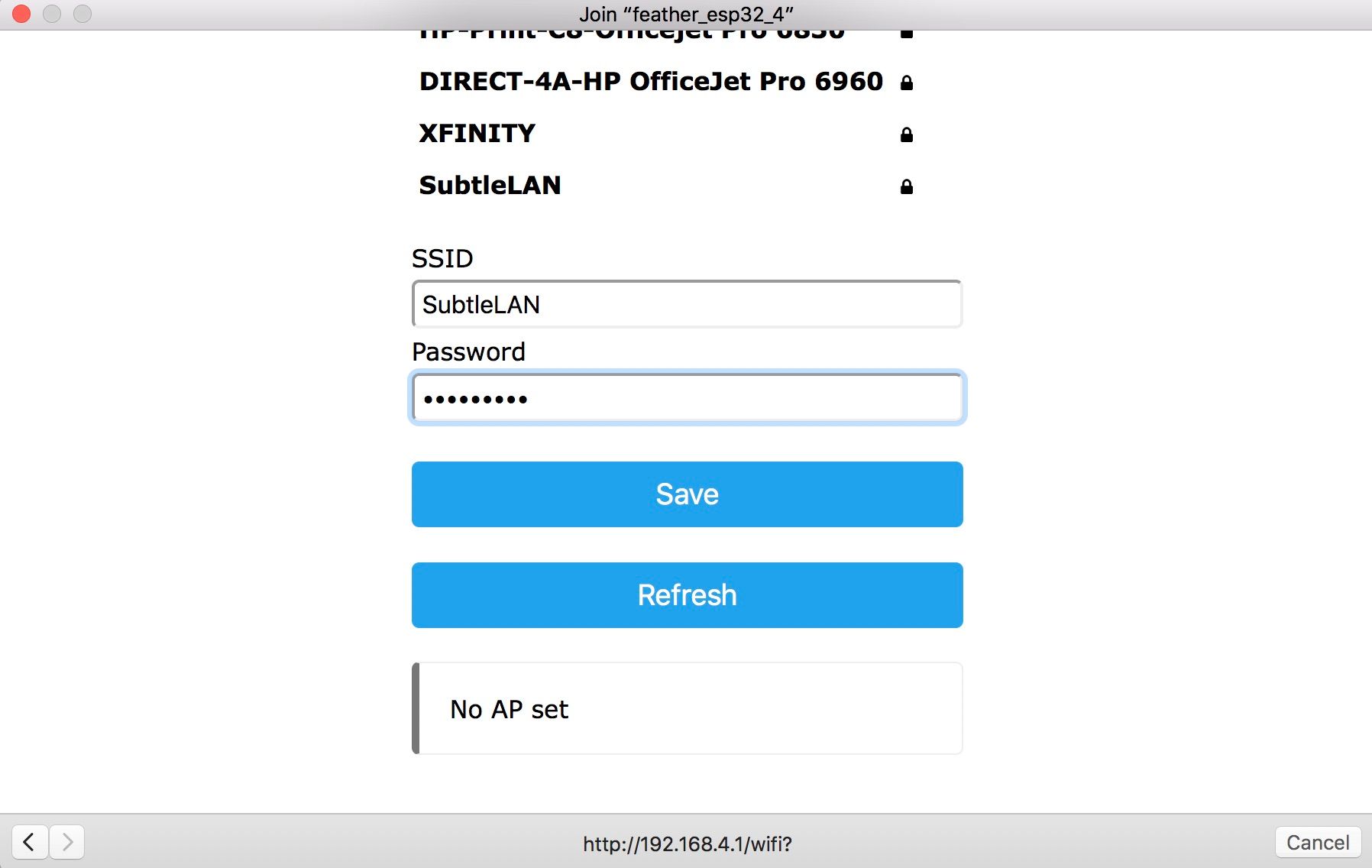

Click "Configure WiFi" and wait a few seconds while the Feather scans for nearby networks. It will automatically show you the list
Select your network (remember, it can only see 2.5Ghz networks), enter your WiFi password and click Save. IMPORTANT: This is the password you use to connect to your home WiFi, not the access point password you put into Config.h. If you don't see your network try moving your device closer to your router.
You'll see this screen next
Wait a few seconds and watch the NeoPixels - if it connects successfully to the WiFi and AWS, it will display a spinning GREEN animation for a few seconds.
The device you used to connect to the access point will automatically re-connect to your WiFi. If, after about ten seconds, you don't see this happening, you'll probably see the yellow spinning lights. This indicates something went wrong and you need to try again. The simplest way to do this is to connect to a different WiFI, then re-connect to the access point WiFi.

Here's one pillow on a partly-cloudy day
And here it is in a dark room
