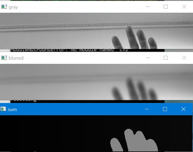

We now go to the heart of the key detection code, which is very simple:
    delta = compare(comparisonFrame, blurred)
    sum = keys+delta
This creates an 8-bit image called delta that is equal to COMPARISON_VALUE (=128) wherever comparisonFrame differs significantly from the current frame (both frames are blurred, remember) and 0 where there is no significant difference. Now, recall that mysterious keys bitmap, which had gray-scale values 1,2,...,numKeys? We add that bitmap to delta. The result is a bitmap that has gray-scale value COMPARISON_VALUE+1 wherever there is motion detected in the area of the first key, COMPARISON_VALUE+2 if there is motion in the area of the second key, and so on. This may not be the most efficient way of detecting motion in a rectangular area, but it very easily generalizes to arbitrary shapes if one wants.
The screenshot above (taken from motionpiano.py running in DEBUG=True mode) shows the acquired grayscale, blurred and sum images (the delta image looks almost exactly the same as the sum image).
