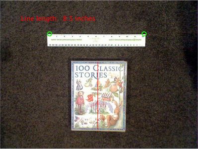

  • The length of the red line in the cover photo, as measured by the webcam, is 8.5 inches

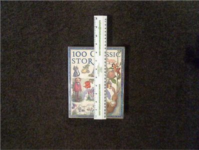

  • Photo 2 confirms that the distance is indeed 8.5 inches

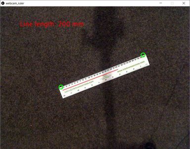

  • Photo 3 is a screen shot of a dimension being measured in mm

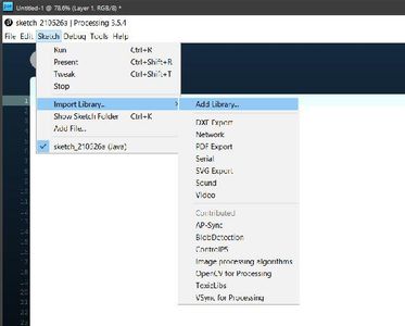

  • Left-click "Sketch | Import Library ... | Add library" (photo1)

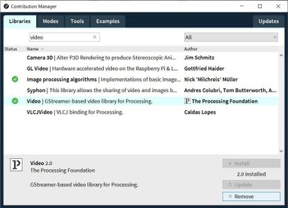

  • Type video in the search bar (photo 2)
  • Select "Video | GSteamer-based video library for Processing"
  • Now left-click "Install"
A green tick will appear when the process is complete.
