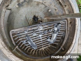

Step 5: Fire Basket:
First thing to do was getting more dept in the BBQ, so I made the BBQ ring 20cmm higher with some sheet steel, and bolted it to the bottom part.
This gave the problem the fire would always be deep inside the bowl, like the original green egg, which is very not good for very fast, very hot grilling of steak. I solved this by making a basket for the coal which is adjustable in height. I Fixed a tripod in the middle of the BBQ, with a 12cm tube sticking straight up. The tube is actually three tubes fitting loosely around another, and all cut with pipe cutter, so the have an edge going in. In the outside of the tubes, I made groves for the edges to glide in. I made a basket of round 10mm steel rod, one side round, one side straight, and welded the thickest tube to the straight side, and a 50 mm piece of 15mm tube for the handle. This way I could stick the handle in, pull up the basket, and when it’s released, it will, because its hanging on one side tilts a bit, so that the edge will fall in a groove and the basket stays in place.

I was a bit worried that because steel gets bigger when it’s getting hot the whole thing would crack, so I decided to make a small gap between the plaster and the steel with a thin hacksaw. Since the plaster wasn’t still totally dry this was easily done. Then off to the shop for a nice piece of rib-eye and the testing may begin.
Better than I could have hoped for, it gets with less than half of the coal I needed before, 150 degrees hotter, within 10 minutes to 400 degrees Celsius. There was a bit of a problem with air leaks trough the lid so I made a seal with silicone. Just the regular stuff for bathrooms and such. The outside of the Egg doesn’t get hot at all, just nice and warm to the touch, so no problem for the silicone.
The only downside for cooking is that, because the egg is so well insulated, the heat stays in, so it’s difficult to trim back the temp while cooking.
