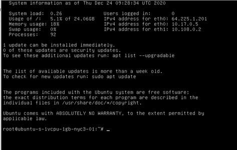

By clicking on the three dots on the right of the droplet you can click Access console, which will make you access your virtual computer.
A new small browser window will open. Now, this is not a desktop environment, like on your Windows 10 or Ubuntu with Graphical interface computer.
However, all can be done via a console interface.
It is not as scary as it looks :)

Login to your droplet console with username root and your password.
As we don`t have a graphical interface, we use commands to control your virtual machine. Here are some common commands you will use on Ubuntu (Linux):
• pwd – print my current directory
• ls – list files and folders in my current directory
• cd / – move to / directory (folder, which includes linux major directories like etc, bin, boot, dev, root, home, var and so on)
By run, I mean, enter the command and press enter.

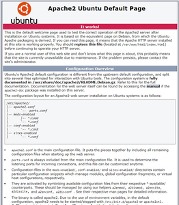

Run apt install apache2 -y to install Apache web server.
Your Apache welcome screen should be accessible on your http://virtual-machine-ip from your browser.
Replace virtual-machine-ip with your virtual machine ip, for example 165.12.45.123. You can also skip the http:// as it will be automatically added.
Congrats!

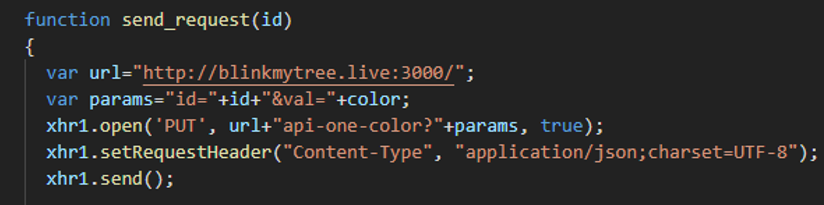

Inside the end of HTML body, in a < script > region, we put some JavaScript, to define the functions we call in onclick events. Globally, we define a XMLHttpRequest, which we use to send a PUT request
We have two functions:
function set_color(val)
function send_request(id)
For testing API request, I recommend a commonly used software tool called Postman https://www.postman.com/. It allows us to simply send API request to the server, without programming skills. It allows to mock a server, and accept requests as well.
