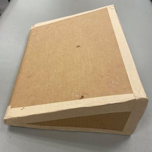

Wedges have lots of uses. They are great for sitting on, to promote a forward-leaning posture. They are also great as lap desks. And they can work as a footrest for someone that wants angled foot support.
The dimensions in this Instructable are the dimensions I use for my class. The dimensions should be adjusted for the specific person who is going to use it.

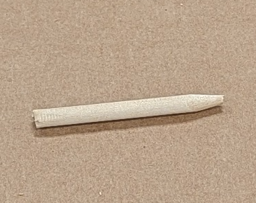

  3. Wooden "Nails"

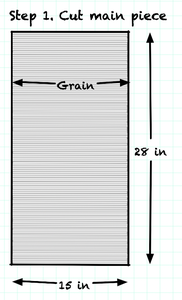

Step 1: Cut Main Piece
I like to cut a piece with a lot (6-inches or so) of excess cardboard to give me flexibility when making my folds.

A note on bending cardboard: Ideally, you will get the entire width of the cardboard to fold along a single "flute" (what I call the "grain") of the cardboard. One way to help this along is to take a box cutter and cut along a single flute.

Step 6: Add Nails
  1. Connect bottom and back with nails
  2. Connect back pieces to support pieces with nails
Step 7: Fixing Your Wedge When the Top and Back Don't Quite Line Up
It's possible that the top and back of your wedge won't line up exactly right. You can fix this problem by cutting off a strip of cardboard and gluing it in place before you apply edging.
Step 8: Edging
You need to seal off the edges to help keep water out. I use gummed packing tape. You can look at this video from the Adaptive Design AssociationYouTube channel
