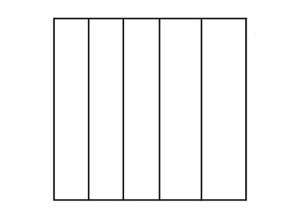

  1. You could use 3/4" plywood but I ripped two 2" x 4" x 8' boards in half and cut in 24" sections so you have 10 boards 3/4" x 3 1/2" x 24"
  2. Use wood glue to connect 5 board sections (top) and 5 board sections (shelf). Clamp and let glue dry

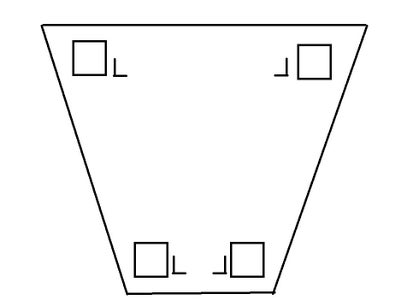

  3. Center a line drawing 15" x 24" x 8" on the top section
  4. cut out top with a circular saw

Step 6: Cut Shelf
Set 5 board shelf section on workbench/floor
Set completed top and leg assembly on top of shelf section
Mark inside corners of the legs and draw the shelf dimensions on the shelf section
Attach shelf to legs using #8 2 1/2" woods screws (making sure shelf is level)
