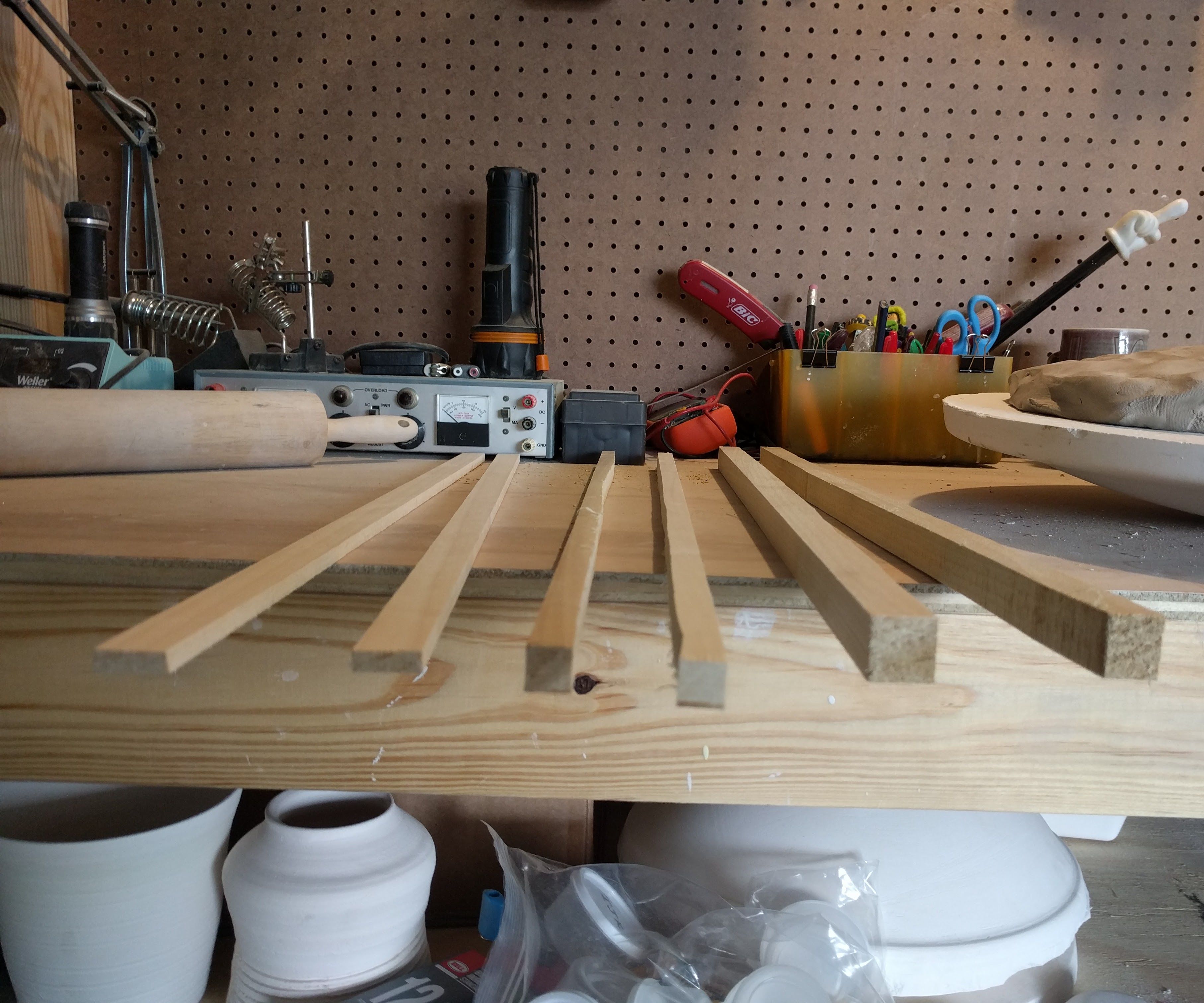

Step 5: Cut the Table Top From Wood and Screw On
I had some beautiful birch plywood left over from another project, so I chose this wood. It would also be acceptable to have this wood as the final wood and not cover it in canvas.
I cut my wood to 2 ft x 2 ft. And I placed screws every 3 -4 inches. I wanted as little banging as possible when I slam the clay to wedge it. ( I didn't take a picture of this process.)
