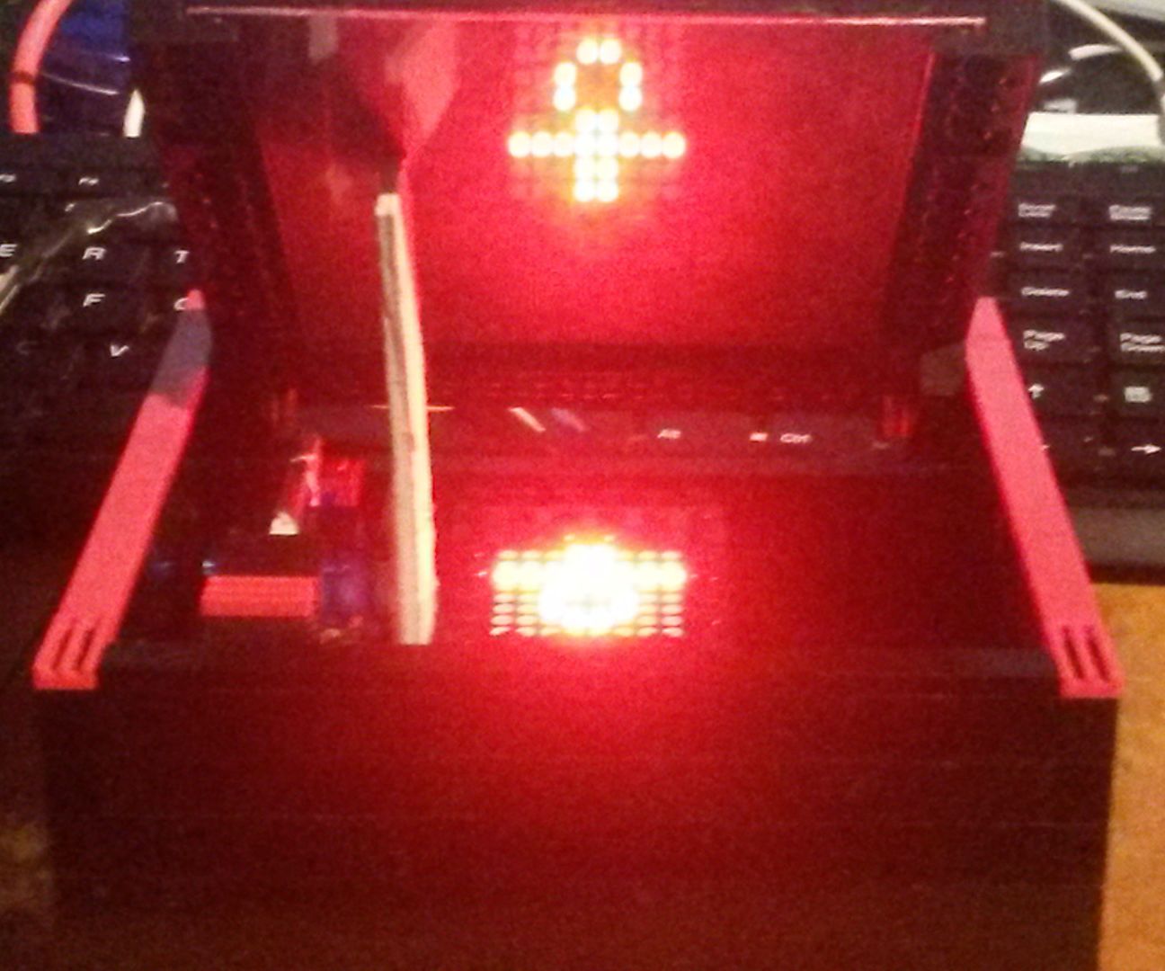

Step 2: WeeBee - the Lego Part
Made by Kees Versluis,
Lego’s and Placement
As you saw in the video, WeeBee is made up out of Lego’s. In this part of the Instructable I will explain how we made the shell for WeeBee and show you the essentials of attaching the Arduino parts to the lego casing.
I made everything in Lego Digital Designer, a freeware tool developed by Lego, to easily show you what parts the box is made up of. This shows you exactly how to build the casing we made for WeeBee, it differs slighty from ours in the sence that the one shown in the example is 18 wide and ours was 16, this is due to some limitations the Lego Builder imposed and my own lack of knowledge of its workings. Although the example is accurate enough to work.
Follow the link below to see the awesome step by step guide made possible by the Lego Builder!
As a final note:
The Arduino Servo's are attached to a piece of 2mm cardboard which we cut a rectangular hole in to fit the micro servo, the rest of the board is pierced by the 2 Lego Technic poles and pinched together by the plugs. This provides enough stability to counteract the servo's movement and keep it in place. Although you have to push it back into place after a few wobbles to get maximum cuteness. The 2 (red) Led's are fitted inside the lego technic brick that is attached to the lid and the matrix fits nice and flush into the hole on the front and is kept in place by the indented brick, you might need to wobble it a bit to get it nice and snug.
All this is based on the assumption that if you are reading this, you are capable enough to come up with your own solutions to these minor problems.
