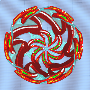

At first, I attempted to bring the entire baked geometry of one of my Week 1 models into the patch, which was so complex that the resulting geometry just looked solid. I eventually realized that Professor Jacobs' example was generated with just a simple wave curve as the source, so I started modifying that curve to see if I could get any interesting results. I compressed the curve and made it loop back on itself (seen in image 3), which generated some interesting geometric results. I exported the first result just to make sure I could successfully export something. After exporting this initial test, I went back in and adjusted the parametric sliders to get a more subtle result, which I was happy enough with to attempt to print. I unstacked the models in Rhino and exported them as three separate STL files. I wasn't sure how, or if, this delicate form would print, so I took it to the Cura slicer next.

I separated my resulting Rhino models into 3 STL files (small, medium, and large). I started with the smallest of my 3 nesting forms for my first test print. I decided to print with a raft to help those delicate first layers adhere, and I generated supports to help the hollow forms and overhangs at the top. I wasn't sure how hard the supports would be to separate from such a delicate and tiny object, but I was quite impressed by Cura's default support settings. I experimented with different nozzle temperatures and quality settings (detailed below).
