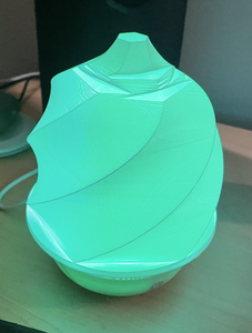

Here you can see the 'existing light fixture in my home'. It is a glowing diffuser. The plastic dome you see keeps the water in and releases the diffusing vapor out the top. It also glows at the same time. I hope to create a lampshade that will fit over this dome. My inspiration is to create something resembling the icecream-like spiral seen above using some of the pst approaches we have seen for creating a series of shapes and then rotating/revolving them.

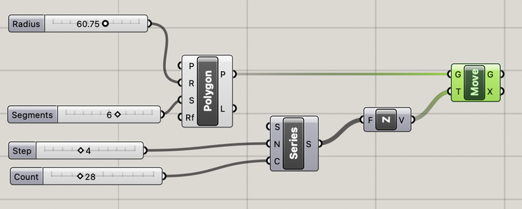

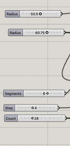

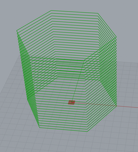

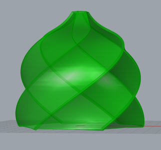

Step 2: Series of Stacked Polygons
I started by creating a series of identical polygons, translated vertically along the x-axis. I used controls to determine the size and number of vertices of the polygons as well as the distance between and total number of polygons

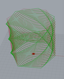

Step 3: Spiralling Polygons Using Rotation
I now edited the grasshopper flow to rotate (around the XY plane) each polygon in series by a controlled angle.

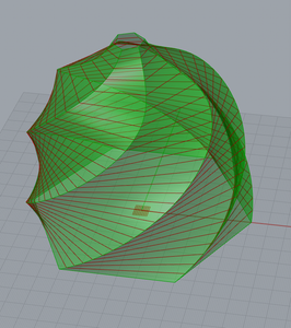

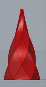

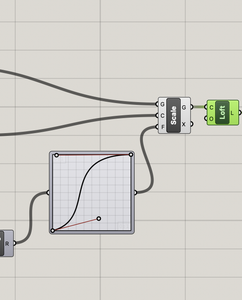

Step 4: Creating Curved Spiral Cone
In order to get the ice-cream-like spiral, and incorporated this shape into the series of polygons. I used a scaling factor block in Grasshopper. Each polygon is scaled separately depending on the curve function seen above. The domain controls the start and finishing scale for the 2 endpoints.
Step 5: Creating External Surface
Here I added a 'loft' in order to transform my series of polygons into an external surface resembling the kind of spiral I desire for my lamp.

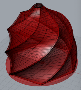

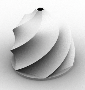

Step 6: Surface -> Solid
I used an offset in order to transform this lofted external surface into a solid (2mm thick).
Step 7: Circular Base
I added a circular fitting below the spiral. This will be tuned to fit the lampshade tight around the circular defuser in order to achieve a stable fit.
Step 8: Optimising Grasshopper Settings to Fit Lamp
At this stage, I had to tuning the settings within Grasshopper so that the lampshade would fit the diffuser cup/lamp. By measuring the cup. This involved tuning the inner radius of the polygon and circular base to fit relatively snug over the cup. The curve was the hardest thing to 'tune' in order to achieve the right shape since it is very difficult to measure the shape of the curve on the current cup. By measuring the diameter of the cup at different heights I gained a relative idea of what the curve should look like. I then used the 'Distance' tool in Rhino in order to determine if the lamp shade diameter matched that of the cup at different heights. I was sure to add a slight offset so that the shade fits over the cup.

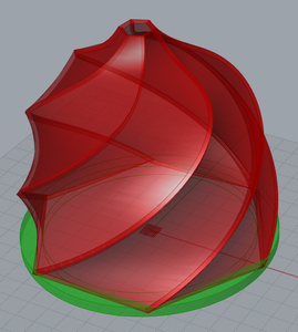

Step 9: Baking & BooleanUnion
I then baked the base and spiral lamp shade separately in Grasshopper. In order to combine the six 'swirls' that make up the lampshade and the circular base, I used a manual boolean union in Rhino. I had some difficulties achieving the union as it failed initially. As I realized in a previous week, the boolean can fail when dealing with two surfaces that are flush but not overlapping. I quickly spotted this has occurred during the 'offset surface' stage used the create the solid. I spotted the offset of 1.8mm connected to the adjacent surface 'flush'. By increasing this to 2mm all surfaces overlapped and the union was easily achieved.

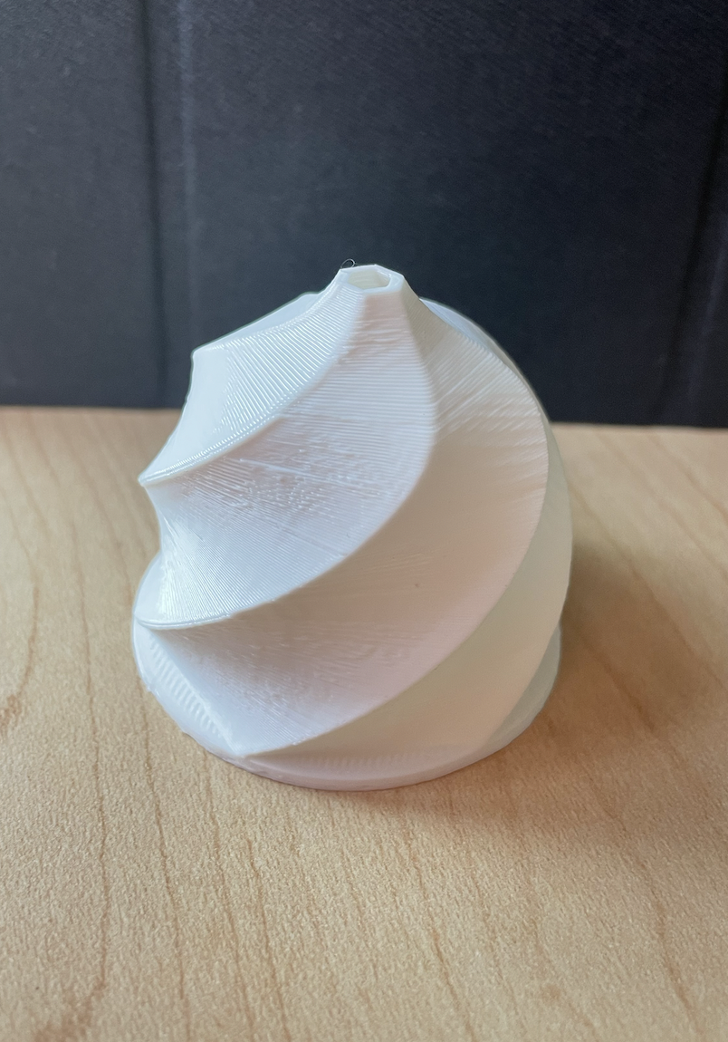

Step 10: 1/3 Scale Model Print
I printed the lamp shade at a 1:3 scale model in order to evaluate its print before doing the full scale. The print took 2.5 hours and was very successfull.

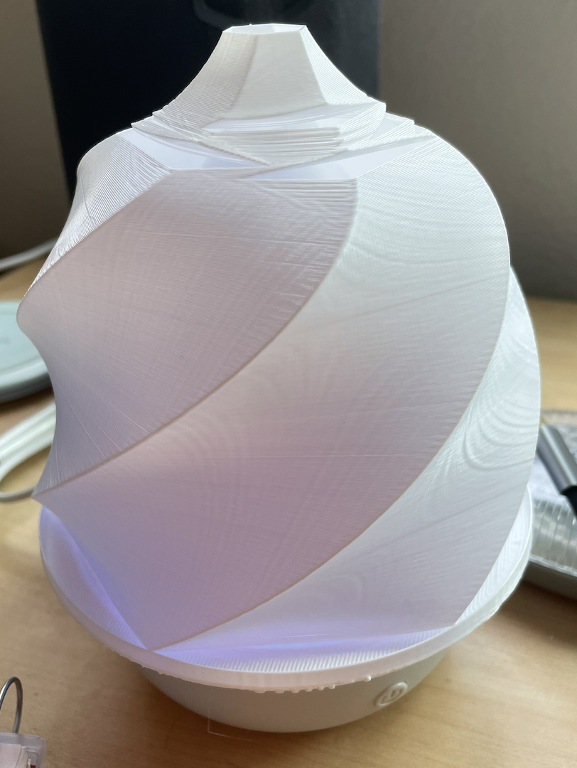

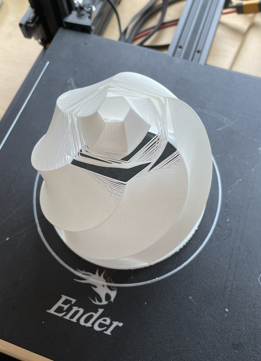

Step 11: Vase Mode
I was interested in the 'vase mode' for printing as suggested in class. I decided to try this for the fullscale model before I did the full print which would take >15 hours. The preview of the slice suggested it the printer may have some difficulties at the top of the lampshade where the overhang is greatest. After printing these difficulties were evident at the steep angle at the top. However, the print gave me a good idea of how the shade would fit. I adjusted the internal radius of the base ring by 1mm in order to improve the fit of this circular base around the lamp. I believe that supports will still not be needed as once the lampshade wall thickness is increased during the print, the printer should find a better connection point and avoid the separations seen in the photos above.
Step 12:
Whilst the full-scale print completes (~15 hours), here can be seen the 'vase mode' printed lampshade over the lamp whilst on.
My initial attempt to print the full model failed. I tried to pause the print before night and resume in the morning, however, the printer could not achieve adhesion in the morning. I am going to attempt the full print in one go now.
