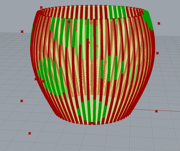

Step 2: Creating the Circle Pattern
I used the Populate 3D node in Grasshopper to generate 20 randomly placed points around my object. I then used the following code to determine if any of the points on my object was within a 10mm radius of a randomly generated point.
for idx, point in enumerate(vertices):
    # Check if the point is close to any of the pattern points within the specified radius
    if any(rs.Distance(point, pattern_point) <= proximity_radius for pattern_point in pattern_points):
        closePoints.append(point)
        closeIndices.append(idx)
This gave me a list of points that were in the proximity if the random points (for visualization) and the indices of these points.
