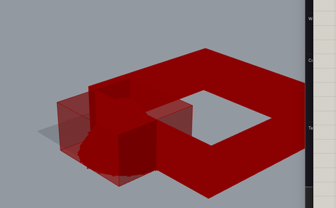

For this design I used a lampshade from Week 3's project (https://www.instructables.com/Week-3-3D-Parametric-Surfaces/). I imported the grasshopper workflow from this project into the example slicer provided. In the image, the workflow in green represents my imported lampshade workflow.
Step 2: GCode Generation
After confirming the design, I exported the GCode that contains all the necessary data for an Ender 3D printer to print my lampshade. I was able to export the gcode by either copying all data from the gcode generation or simply saving my gcode to a file through additional workflow steps included in the example slicer file (both methods are pictured). After creating a .gcode file the next step was to upload it to a chip that can be placed in the Ender to read and print.
