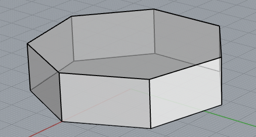

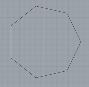

Step 1: Basket Shaped Object
In Rhino I created a polygon box shape to model my basket from.

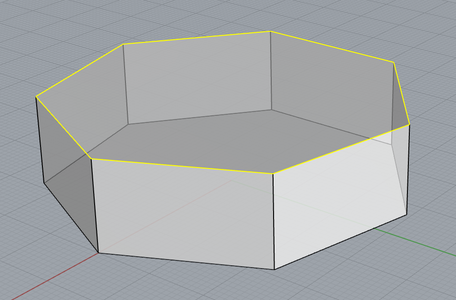

Step 2: Creating Basket Shell
I shelled the box to create something resembling a basket.

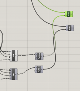

Step 4: Creating Spaced Cross Sections
I started in Grasshopper now to create a flow that could take cross-sections of the brep (basket shell) at evenly spaced intervals. I used sliders to control the spacing distance. I initially developed this code on a simple shelled cube.
Step 5: Extruding Cross Sections
I extruded these cross-sections at a controlled distance using a slider.
Step 6: Repeat Along Y-axis
I repeated the process using the same flow but now using the Y-axis to contour (take cross-sections) and extrude to gain crossing geometries resembling the basket.

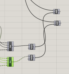

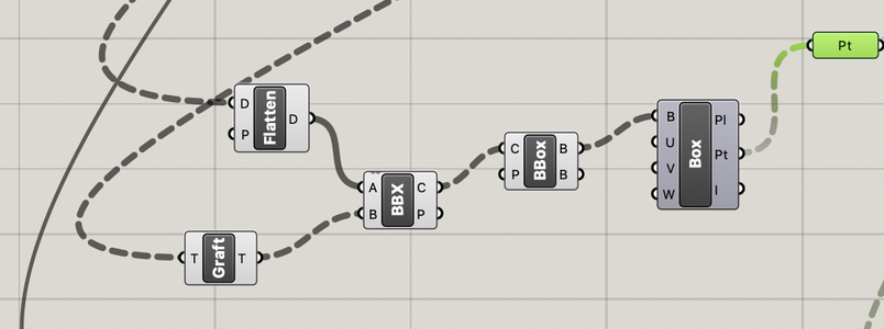

Step 7: Finding Points of Intersection
By comparing the cross-sections in both directions, I was able to use the 'BBX' block to 'solve intersection events for two breps'. Using the line of intersection I found the halfway point of each using a bounding box.
Step 8: Finding Areas of Intersection
I then separated the bounding box into two halves using the halfway point found in the previous step. The volumes below and above this point were defined depending on the slice thickness used in Step 5 to extrude the cross-sections.

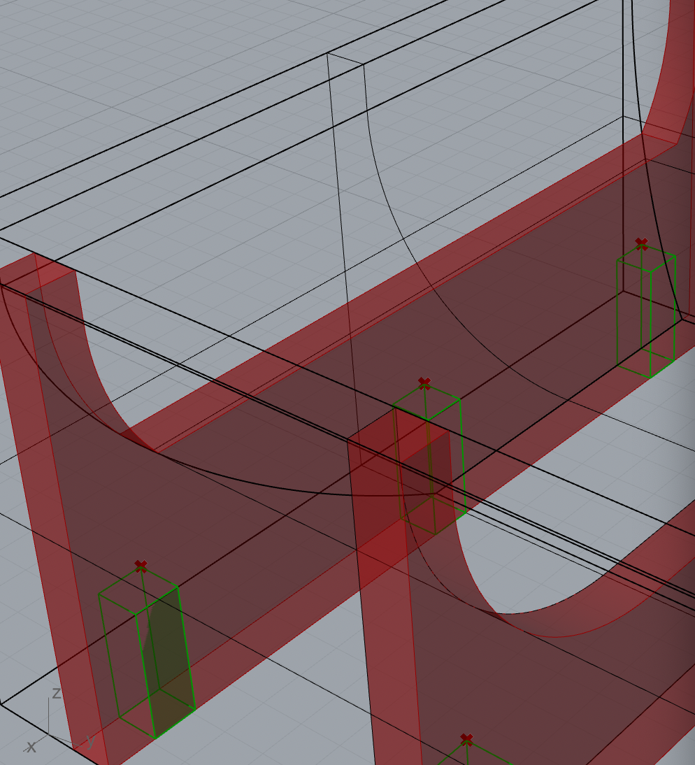

Step 9: Removing Areas of Intersection
Using a Solid Difference between the two volumes (the extruded cross-section + the bottom half of the intersecting volume), I was able to cut out the slots you can see above.
Step 10: Repeat for Y-Axis
The process is repeated for the perpendicular cross-sections. The opposite (top) cut-outs are used to cut out slots in the extrusions.

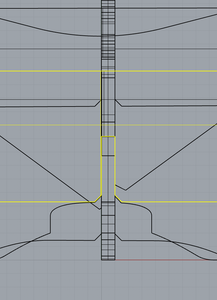

Challenge: Finding the area of intersection and the midpoint of this area was relatively simple, however in order to cut out a volume I struggled to find an appropriate boundary for the volume in the z-axis. Using a bounding box for the original brep, I was able to bound the top of the intersection volume as seen above.

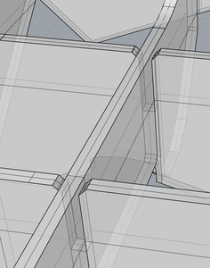

Step 11: Chamfering Slots
I then added chambers to the opening of each slot. As seen in class this should help two plates fits together.

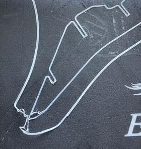

Step 14: Printing
I had some difficulty printing the plates. I struggled to achieve good plate adhesion at the sharp corners of the plates. After re-calibrating my plate bed and increasing temp from 55 - 65 degrees, the print worked better.
