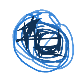

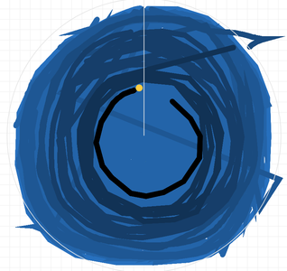

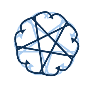

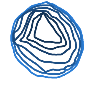

Step 1: Playing With SketchPath
Above are three examples of ideas I experimented with in SketchPath. My first design consisted of me mostly moving around the mouse (as I did not have a stylus) and pressing buttons and seeing what happened. After seeing my final output, I scrapped it and tried to design a detailed vase with a base and many layers on SketchPath. However, I quickly learned that I wasn't supposed to use SketchPad that way (and my computer crashed too), so I tried a third time to design with the software by going through the dots. That worked slightly, and I kept playing with that design.

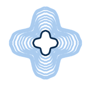

Step 2: Initial Designs
I further experimented with layers, height, rotations/scale/transformations, and I began to play with mirroring in order to create more pronounced and symmetric designs. I really enjoyed mirroring since it made the designs, which were mostly freehanded with my mouse, appear cleaner. I also liked that baking a rotation/scale/transformation quickly altered the design and raised the height without creating too much separation from the previous layer, which was an issue I ran into while free-handing.

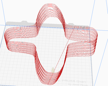

Step 3: Proposed Final Design
I eventually ended up with my proposed final vase, but when I showed it to the instructional staff on Friday, we decided not to print it because it was likely the vase would fail since many of the layers were too far from each other (I had done a lot of scaling, and I realized I should have put less gap between layers).

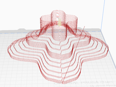

Step 4: Final Design
I ended up printing this design, which I made with mirroring and adding a 1 degree rotation every 5 layers, as it was more likely to succeed in the printer since the layers were close together. The design resembles a tray, and I thought it was pretty, so I gave it for printing.
Step 5: Base Slab Making and 3D Printing
Before I started the print, I created a base for my tray by kneading together clay with water and the rolling pin. I realized when looking at my GCode that my design was very large, so I made sure to create a base slab that would cover basically the whole bed. When I gave my design for printing, it printed well except for the fact that one of my edges of my tray was too close to the edge (so the clay began to fall off). Consequently, we pushed the bed back, and we decided to scrape/smoothen the extra pieces afterward. Once we fixed that, the print ran smoothly and only took a couple of minutes.
