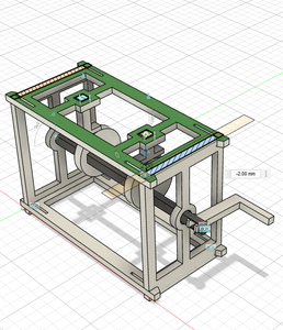

Step 1: Fusion 360 Exploration
I began my CAM toy design by decreasing the size of the top (highlighted in green) by 0.2 mm and the walls by 0.5 mm after consulting with the instructional staff (Alejandro). My initial goal was to add a dog on top of the followers!

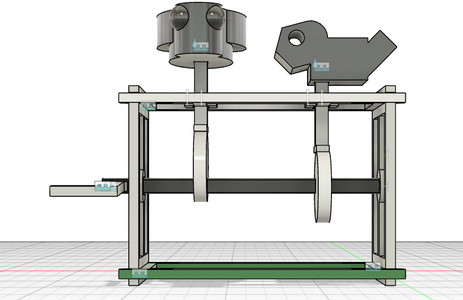

Step 3: Finalized CAM Toy Design
Since I gave the initial prints on Friday, I spent the weekend designing my finalized CAM toy, so I could print the remaining parts (including the top) again on Monday. After realizing that attaching a singular dog to be put on two followers at different heights did not make much logical sense, I designed an oversized fly in Fusion 360 and used the software's Assemble Joint feature to test out the joints/how big the dog and fly could be. Once finished, I lowered the bottom's tolerance by 0.2 mm and exported all my designs to Cura.

The walls and the top/bottom fit together really well. Since I did not edit the tolerance of the CAM/shaft/lever/follower, they were a tight fit, but after some pressing, I got them to fit nice and snugly. However, I realized my 0.6 mm per side extra space on the hole I created for the follower to be inserted on each animal was too much, as the fit between the animals and the followers was very loose. Furthermore, keeping the follower on the wheel was a challenge, even though the rotation mechanism worked fine. I was eventually able to put everything together for a little while!
