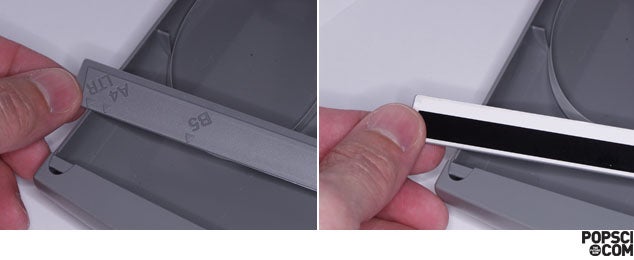

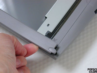

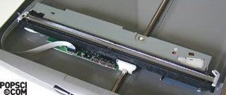

Carefully, remove the scan head from inside the CanoScan LiDE 25 scanner. Begin by removing the lid from the scanner's body. Next lift the glass out from the taped plastic guides along each side. Retain the top paper size guide for calibrating the scanner during startup. This piece has a black/white calibration strip along its underside.

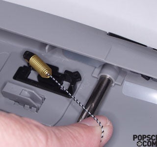

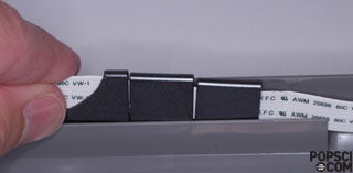

Disconnect the scan head from the reinforced movement cable. There is a set of five metal clips that hold the USB ribbon cable to the inside edge of the scanner. Slip these clips/cable out of the scanner's plastic edge. These clips are very poor quality metal and can be easily broken. Finally, remove the USB port from the rear of the scanner.

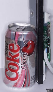

You now have a handheld 3D camera that can be tethered to the USB port of your notebook computer.

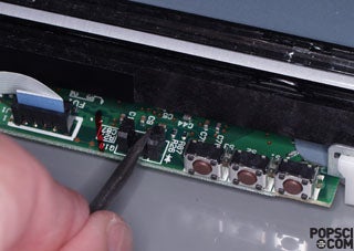

Connect the handheld 3D camera to your computer's USB port and start the SANE interface (e.g., command line, stand-alone GUI, or TWAIN driver). When SANE detects the handheld 3D camera (formerly a Canon LiDE 25 scanner), the scan head motor will start up. Quickly insert the blade of a small screwdriver tip into the photo sensor switch on the scanner's main circuit board (i.e., located next to the three tactile switches; diode Q18). This will stop the motor.
When you are ready to scan/photograph an object, place the paper size guide/calibration piece saved from Step 2 on top of the LED/sensor bar of the scan head. The scanner needs to "read" this guide prior to beginning a scan; otherwise the LED will shut down.

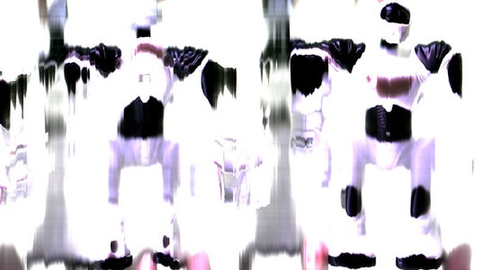

Now, click the scan button on the SANE interface. As the scanner reads the black/white calibration strip, the scan head motor will start up. Each time this motor starts, insert the small screwdriver tip into the Q18 photo sensor switch. This screwdriver insertion will stop the motor. On the final motor startup (as recorded in Step 1), don't insert the screwdriver tip, rather scan your 3D object.

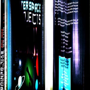

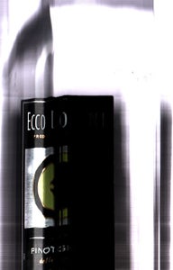

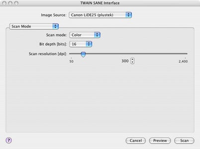

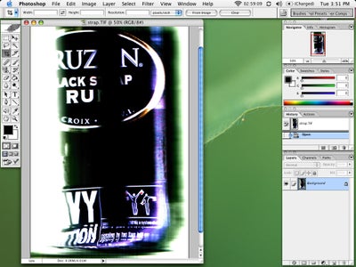

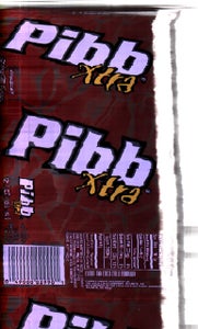

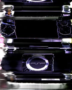

NOTE: None of these example images has been manipulated in Photoshop. Each image original is a 300dpi scan.

- keep the LED/sensor of the scan head in close contact with your subject

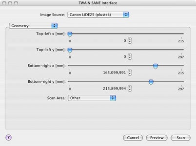

- set the dimensions for your "scanning" to the maximum size (i.e., called "Geometry" in SANE) that will allow you to cover the entire surface of your 3D object
- move your "camera" while the scan head motor is running; try moving in all directions--around, over, and under your object
