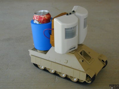

Controlling the movements of the plastic model tank are two Passive Infrared (PIR) sensors. Rather than sound an alarm, these motion detectors are modified to trigger a relay that, in turn, activates one of the tank's electric motors. Furthermore, a PIR sensor is independently tied to each motor. Therefore, crude turns and forward movements can be controlled by signals from a combination of both sensors. All is not bliss with Follow Me, however.
There are two significant and limiting parameters that govern the operation of the PIR sensor. First, there is a 15-second delay period following each sensor trigger. Therefore, sudden changes in direction might not be picked up by Follow Me.
A second limitation can be even more stubborn to overcome. Following a trigger by the PIR sensor, the relay is held closed for approximately two seconds. This duration translates into roughly 1-2-feet of travel. If a longer time of operation is desired delay circuits can be added to the relay's output. Instructions for this type of modification are supplied with each surplus PIR sensor.
During testing of Follow Me a range of 10-15 feet was needed for obtaining optimal sensor readings. Furthermore, the sensor is more sensitive slightly off center.

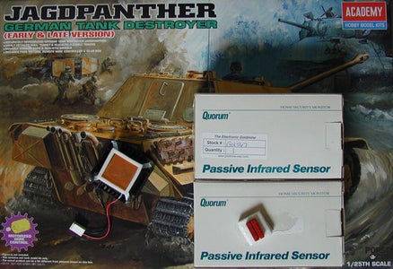

Parts List
- (1) 1/25th scale Academy Jagdpanther plastic model tank kit ($43.42; Squadron.com #MH1342 ) NOTE: If this kit is sold out; try substituting this Academy Panther-G tank kit; $57.09; Hobbylinc.com #acy1341 or this Tamiya tank kit: Tiger I; $83.85; Squadron.com #TM48202. Beware there is a non-motorized version of this Jagdpanther kit #13019.
- (2) PIR sensor ($5.95; Electronic Goldmine #G4567)
- (2) Coto SPST 5VDC reed relay ($1.00; All Electronics #RLY-475)
- (2) 100mf electrolytic capacitor ($.16; DigiKey #P12919-ND)
- (2) 1N914 diode ($.30 for 10 pieces; DigiKey #1N914-TPCT-ND)
- (1) Beverage "cozy" or "snuggy," holder ($1; various discount stores)
- Scrap perforated circuit board
- Mounting hardware
- Solder
- Wire
- (3) "C" batteries
- (2) 9V batteries
- Cable ties
- Peltier Junction cooling device ($7.95; Electronic Goldmine #G2201)

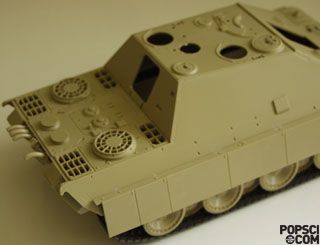

The first step is the easiest--build the model tank kit. Be forewarned, however, you don't need to add all of the armaments and accessories to the model. Only add the amount of detail that you need for a strong, stable mobile platform.

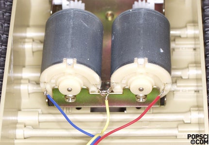

Install the two motors and gearbox inside the tank's lower hull.

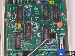

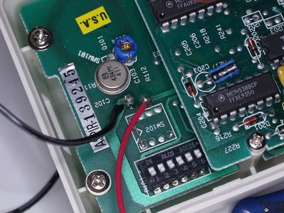

Each PIR sensor needs to be modified for driving a relay switch. Instructions for this modification are supplied with each surplus sensor. Use wire leads approximately 12 inches long for this modification.
The control wires for each sensor are routed out the screw hole in the case back. These wires will be added to the relay circuit that you will be building in the next step.
It's a good idea to test the operation of the sensor at this time (see NOTE below). Temporarily connect the two control wires to an LED with a current-limiting resistor. Install a 9V battery and wave your in front of the sensor. The LED should light for approximately two seconds.

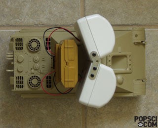

If the operation tests OK, the modified sensors are mounted upside down on the top of the tank. This orientation will ensure that the optimal angle of coverage for each sensor is deflected upwards from the tank. Also, the sensors' coverage should have a slight overlap along the centerline of the tank's cross section.

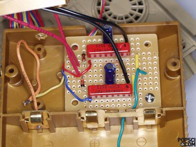

Step 4: Run a Relay Race

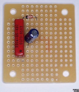

An independent SPST reed relay is tied to each PIR sensor. An electrolytic capacitor and diode help to smooth the on/off operation of each relay by reducing "chatter" on the PIR sensor control lines.
Each relay is also tied to one of the electric motors inside the tank.

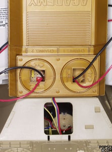

The tank kit's remote control box is used for housing the completed relay circuit board along with the motors' battery pack.
Step 5: Motor's Crossed
Using the wire from the tank kit's remote control, wire the motors and battery box to the relay circuit board.
When all of the wiring has been finished, bolt the remote control box to the top of the tank behind the forward-facing PIR sensors.

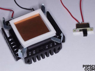

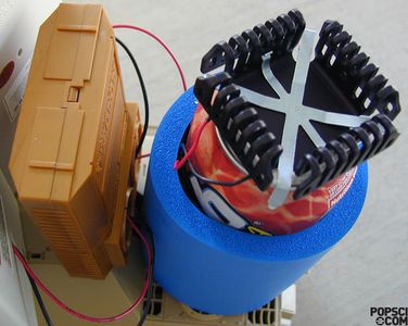

Step 6: Don't Drink the Water

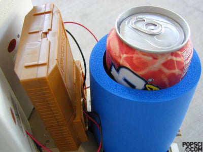

In the Jagdpanther kit, there is a step or shelf behind the non-movable turret that will hold one 12-ounce beverage can. Either attach an insulated cup holder with your drink or create a can chiller from a Peltier Junction.
There are a couple of safety points to consider when using the Peltier Junction circuit. First and foremost; watch out for excessive heat buildup. This heat can come from both the circuit's heat sink, as well as from current drawn through the battery power source. Make sure that both of these heat sources are insulated from the plastic parts of the tank kit and PIR sensors.
Another point to remember with this chilling circuit is to ensure that there is direct contact between the can and the cool side of the Peltier Junction. There's nothing worse than having a drink caddy follow you around all day with a drink that is too warm to drink.
