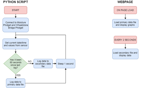

Step 3: Software Overview
As shown above, there are two main parts to this project:
  1. Python script
  2. Webpage
Let's start by taking a look at the Python script.

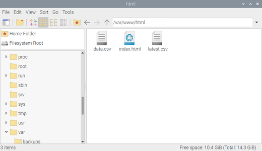

Step 6: Webpage Review
Previously, we mentioned using the Raspberry Pi documentation to set up an Apache webserver. This information is also covered in this project.
It may sound complicated, but there are only two commands to run:
  1. sudo apt update
  2. sudo apt install apache2 -y
After running the commands in your terminal, you are ready to view/edit your webpage. There will be a folder under /var/www/html that holds all of your web files. In this next step, we will be editing the index.html file to create graphs and labels that display the Phidgets data.
Note: /var/www/html is also where your Python script is now logging data. This is so that it can be served by the webserver and used by the website.

The website has two main parts:
  • Webpage load: when the webpage loads the main data file (data.csv) is loaded and the contents of the file are displayed on graphs
  • Every 2 seconds: there is a function that runs every 2 seconds (you can change this frequency) that grabs the small data file (latest.csv) and displays the latest data on the webpage AND updates the graphs.
