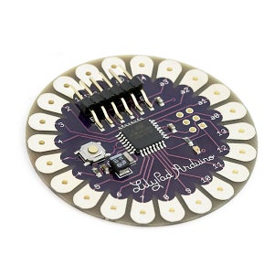

Lilypad Arduino - A sewable version of the arduino microprocessor
Breakout board and USB cord - connects lilypad to computer

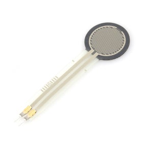

Force sensitive resistor

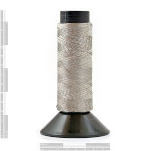

Conductive thread - 4 ply tends to fray, but has much lower resistance than 2 ply
Needle and threader - threader is vital for 4 ply thread

Picture 4 shows how to place the FSR inside the strap.
Picture 4 shows how to sew the FSR to one side of the strap.

Picture 2 shows the circuit diagrams for each comoponent. Specific Arduino pins are mentioned to ensure compatibility with the code.

Picture 4 and 5: I used a straight stitch to reduce thread length and resistance (picture 4), but I later learned that a diagonal stitch allows more stretch, so it is preferable (picture 5).
Picture 6: Stitch around the FSR pins to hold them in place

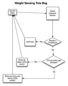

You can test the code throughout the sewing process, first by connecting petals with alligator clips to create the circuits, then with the fabric circuits themselves. You can download the code (Readinput.pde) or view a flow diagram of the program's logic (Flow diagram.jpeg).
The code consists of several distinct parts.
The variable declarations declare variables for the Lilypad petals, an array and reading variables for measuring the force, variables to control the LED pulsing, and a variable to keep track of excessive pressure.
setup() activates all the pins, and enables Serial (for debugging).
loop() checks the pressure, logs excessive pressure, and either issues a warning if there is excessive force, shows the level if the switch is pressed, or pulsates otherwise. It also calls printReading().
getReading() uses an array to record the pressure.
printReading() helps with debugging, by printing all the reading variables.
checkWarning() logs a continuous period of high force before triggering warning().
warning() causes the LEDs to blink.
level() shows more LEDs for larger force.
pulse() shows faster pulsations for larger force.
ledLight() helps light the LEDs for level() and pulse().
