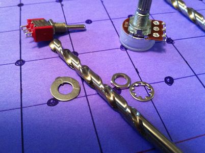

Determine the size of the holes:
There are several ways to measure the size holes you will need to make. The simplest way is to take the washer from the component and measure the hole. You could even trace the inside of the washer onto your pattern. Since I was eyeballing it, that is along the lines of what I did. You could be more exact by using a micrometer or a Vernier Caliper then choosing the corresponding cutting heads.
Caution with the cutting implement:
I had the good fortune of learning quickly not to use a standard drill bit to cut holes in plexiglass. The second hole I drilled cracked the plate in two when the cutting edge went through the hole and caught the edge of the hole and bit into it making the split. And so I did research on cutting holes in plexiglass. I discovered that about 1 out of 10 tries you will split the plexiglass. Thankfully it happened to me on my second hole instead of my 10th or on my final, the 19th hole, as fate usually deals out.
So if you can't use a drill bit then what do you use?
You have several options, any of which still may split the plexiglass; there is no guarantee.
The first bit I will mention is a Step Drill Bit with which you may progressively cut any size hole. This is good because it starts out small like a pilot hole and then you gradually make the hole bigger. I did not have one of these bits on hand and to buy one would cost between $18-$60 for a set. This seemed the best option as far as risk to splitting the plexiglass, but I had no budget to purchase the bit, plus I didn't want to wait to go and get one or order one.
The second option would be a chamber bit which is a like a sort of a cylinder saw you mount on the end of your handheld drill or drill press. Odds are that you will still split the plexiglass at some point. Now I'm sure there are alternative specialty bits you can buy to drill holes in plexiglass but that wasn't what I decided to do.
The third and preferable option to me was to use what dremel bits I had to grind out the size holes I wanted. There wasn't any time while I was cutting that I felt the plexiglass might split. The downside is that the friction of the grinding melted the plexiglass and put a coating of plastic on my bits. Some dremel bits can be expensive, but in most cases I was able clean the plastic off by grinding with the bit on a piece of metal. If you are concerned about it the be sure to use your cheaper grinding bits. I'm sure results will vary depending on the bits and the thickness of the plexiglass.
