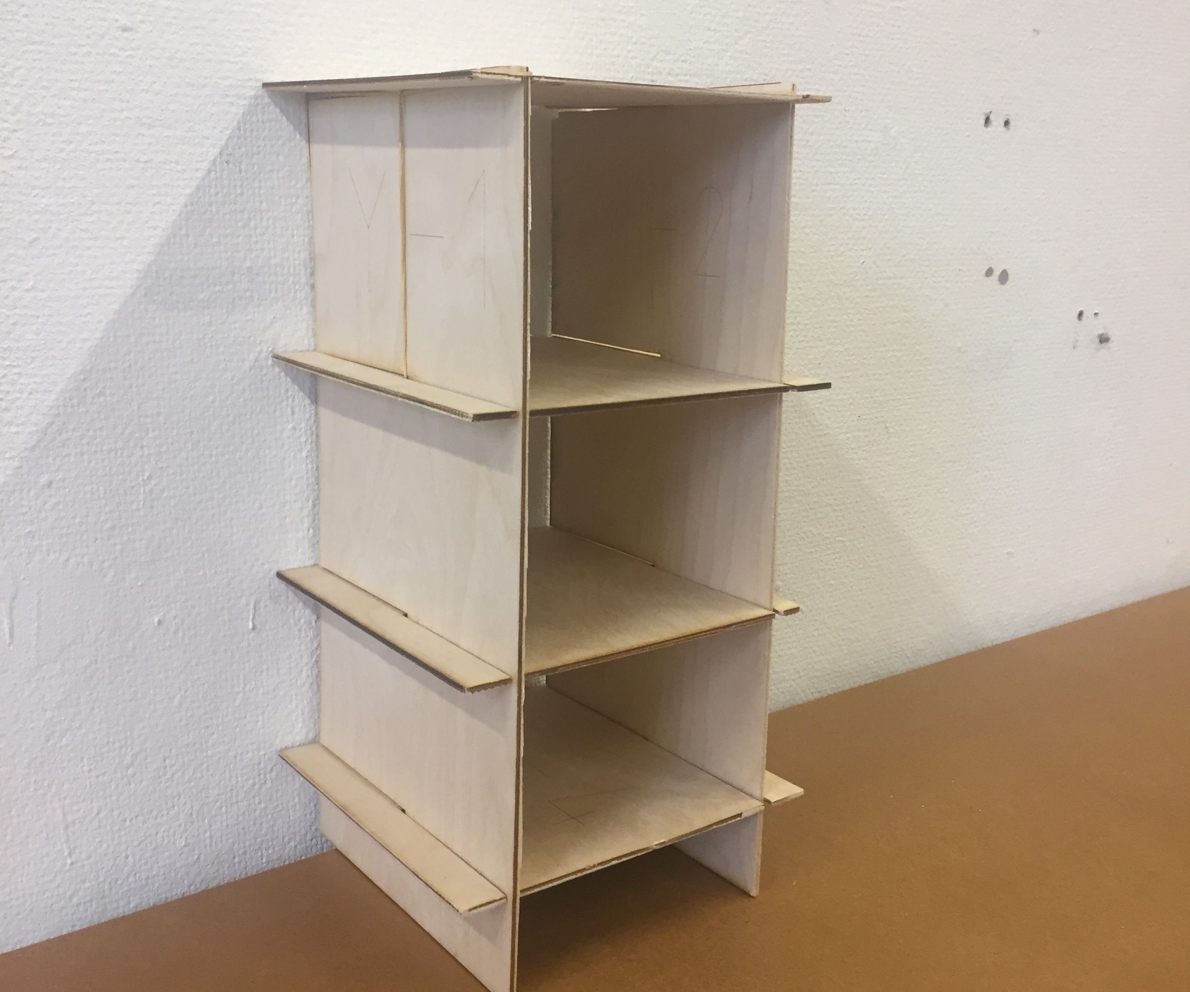

Step 4: Milling
After the file was ready I sent it to the machine for milling. This took a couple of hours because I was using the machine with other people. The material I used was a cheap plywood board, 30mm thick.
Step 5: End Result
After milling, I took out the different parts and assembled them. I polished the edges with sanding paper and cleaned the leftovers left by the bridges. This is the end result of my weird stool.
