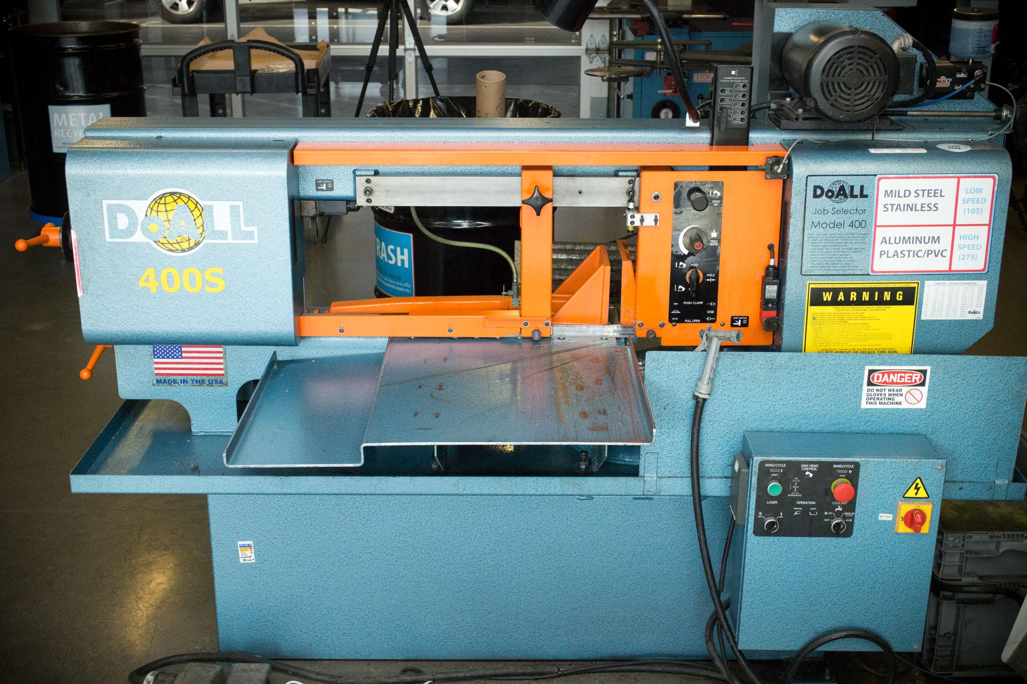

For this reason, I prefer to use a horizontal band saw for metal cutting. They are far more precise and versatile, certainly worth the investment if you are becoming serious about metal fabrication. They allow you to work quickly and cleanly and save a ton of time. The one pictured here is very nice, but in other shops, I have used much smaller (and affordable) bench-top monted metal band saws that can do the same job with the right jigging.

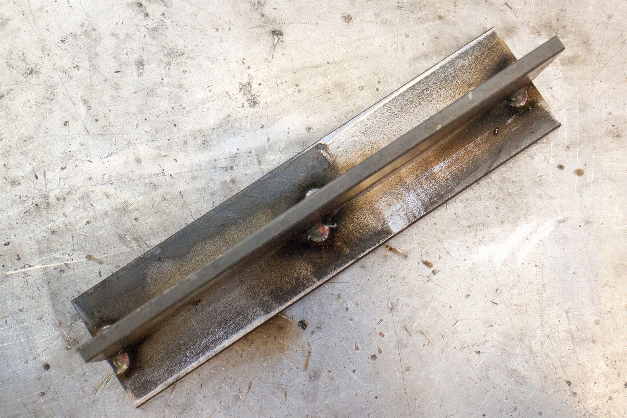

Be sure to check your square as you tack pieces together with a steel square tool. If your tacks are not keeping your material square, you should be able to bend and twist (or even bang and hammer) them back to square before completing your weld beads.
We tack our material to minimize heat distortion on our material. Rapid expansion and contraction will cause your material to shrink toward your weld bead, so alternating sides as you tack can help reduce this deformity.

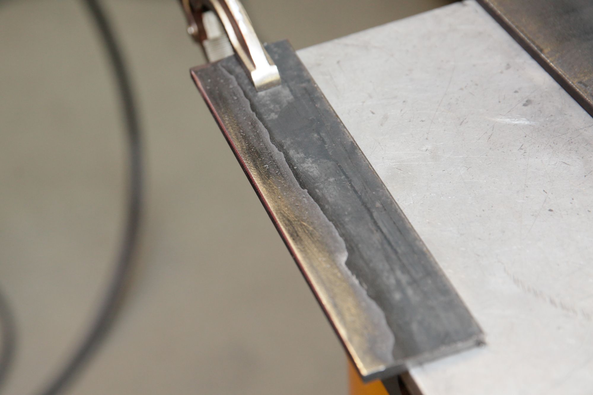

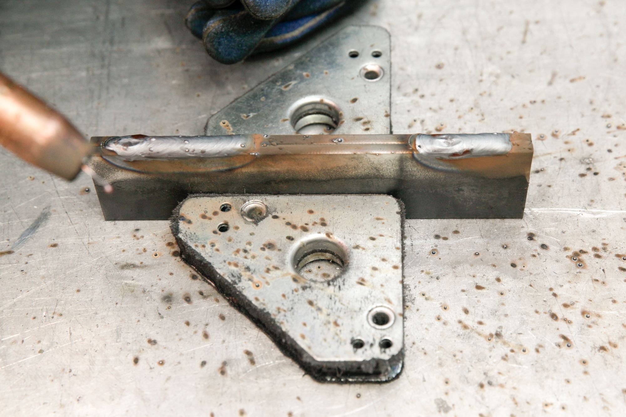

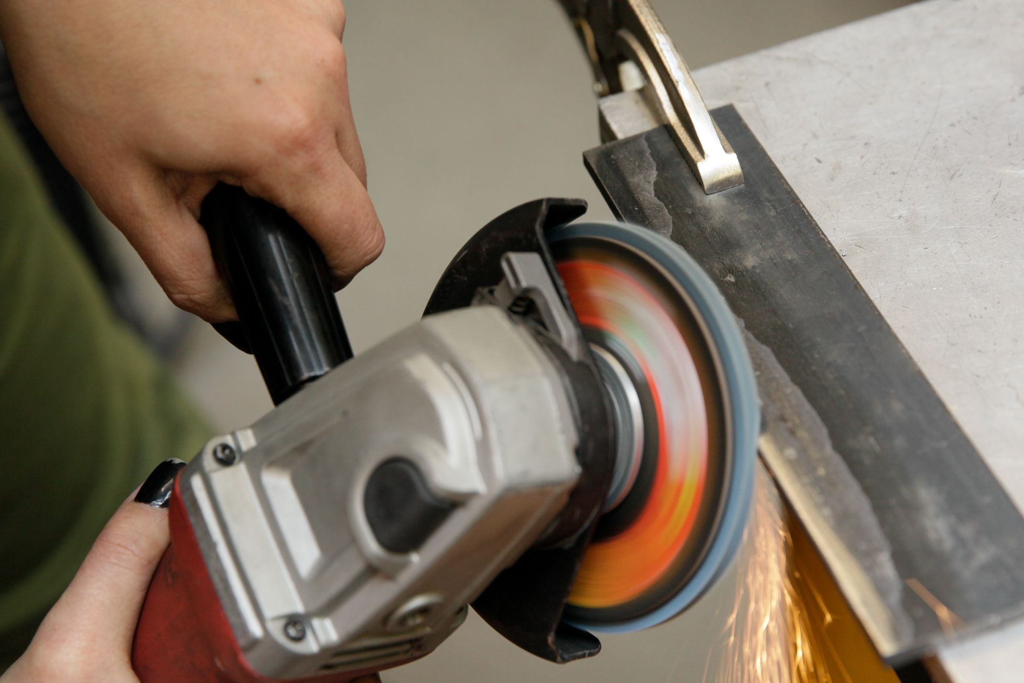

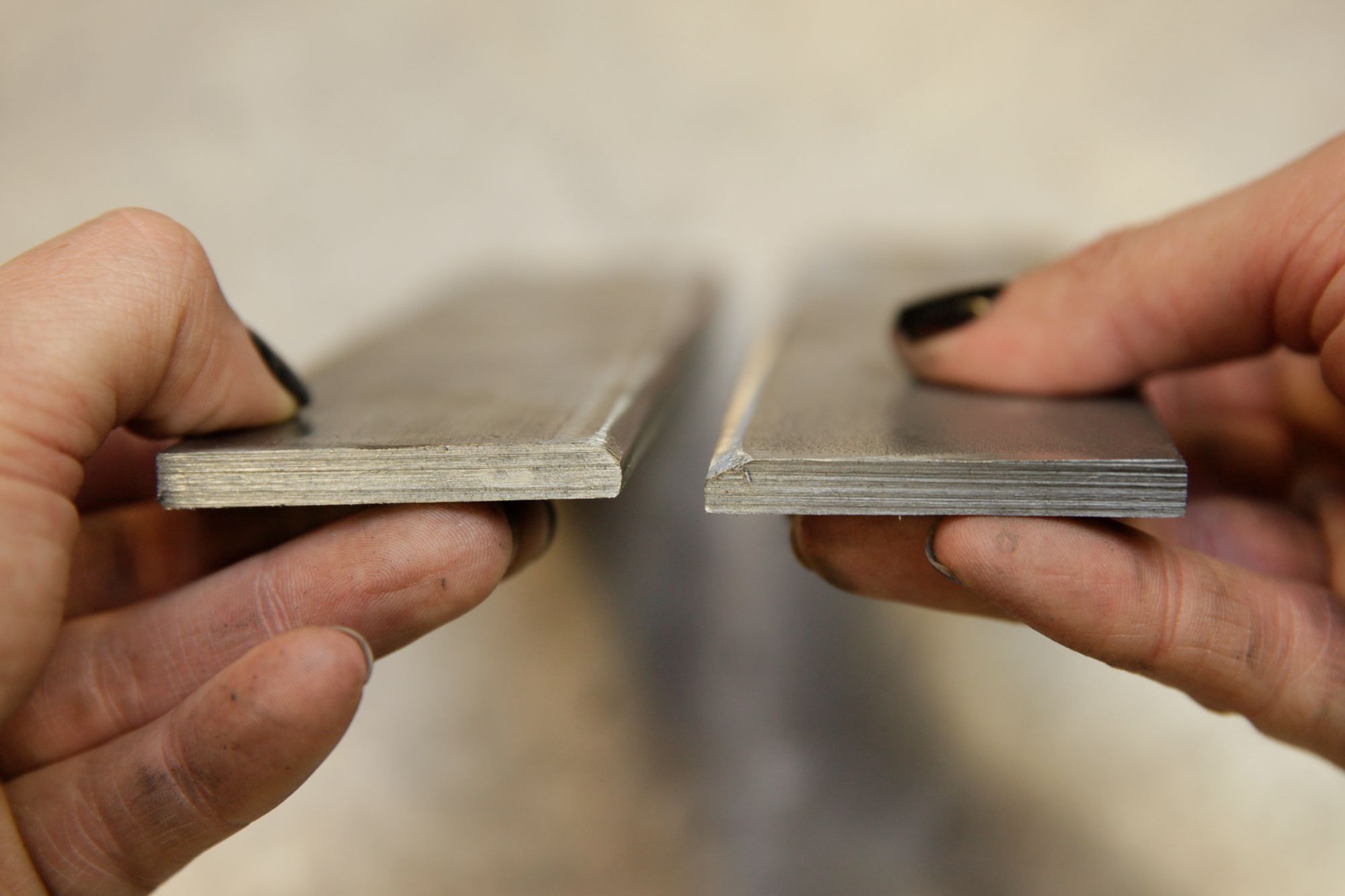

We prepare hot-rolled flat bar steel for welding by first grinding off the mill finish. This finish protects the steel from rusting while it is being transported from the mill to your workspace, but if it isn't removed, you will have a contaminated weld that could potentially break.
It is a good practice to use an angle grinder to bevel the edges of steel stock before it gets welded. By creating two bevels on the joining edges you create a tiny little valley for the weld pool to form in. Doing this for butt welds is a good idea to ensure good penetration.

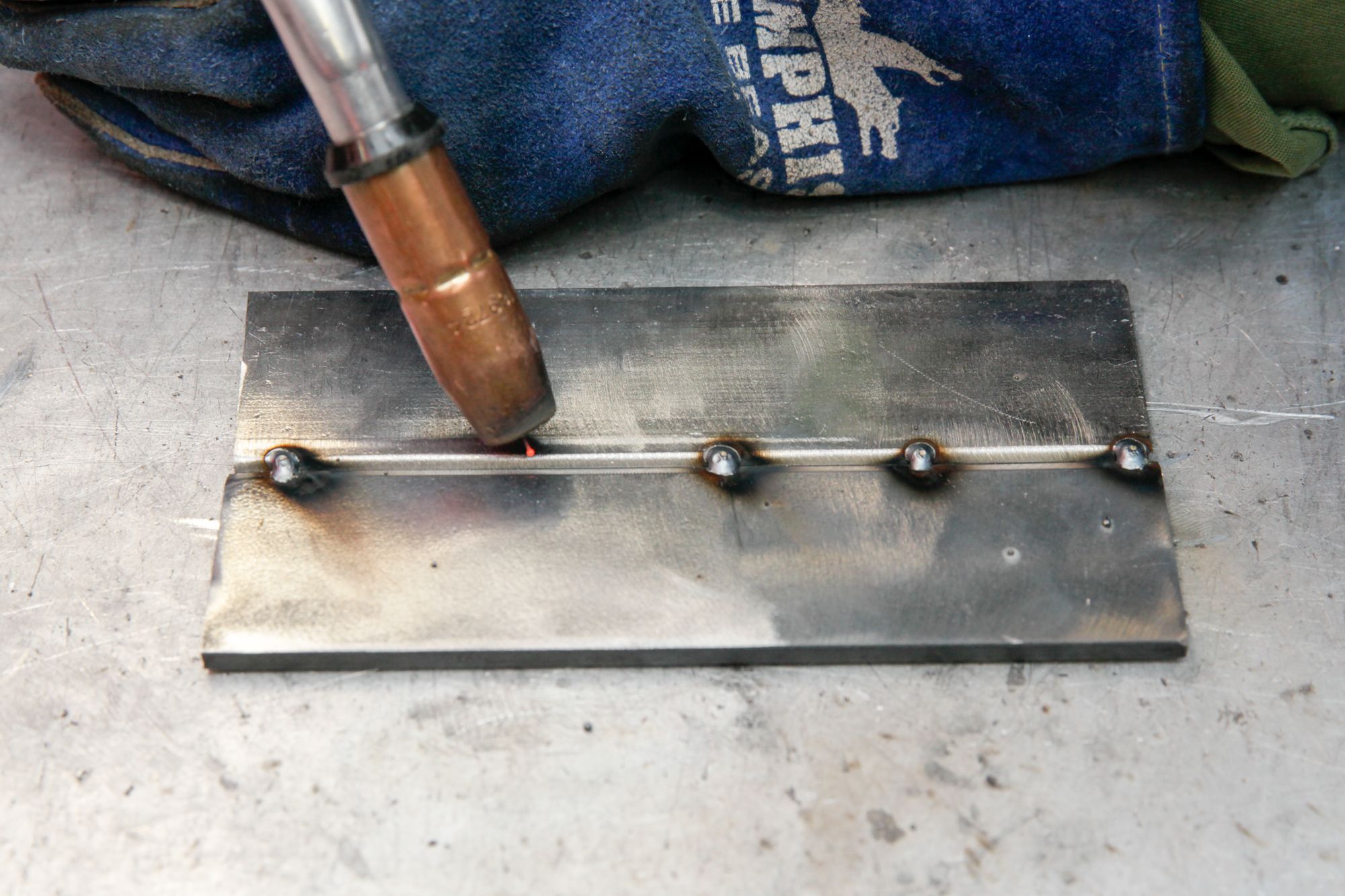

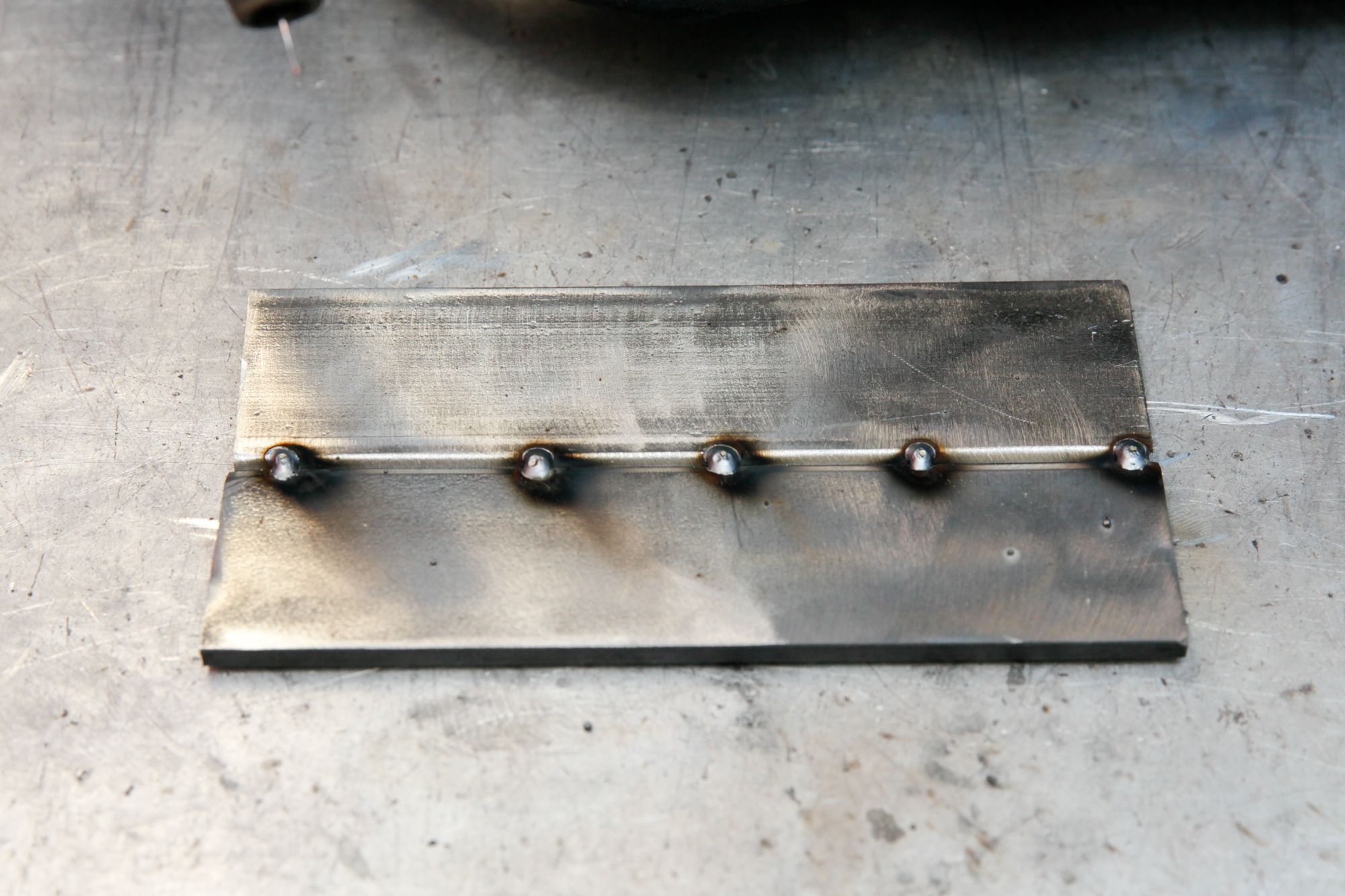

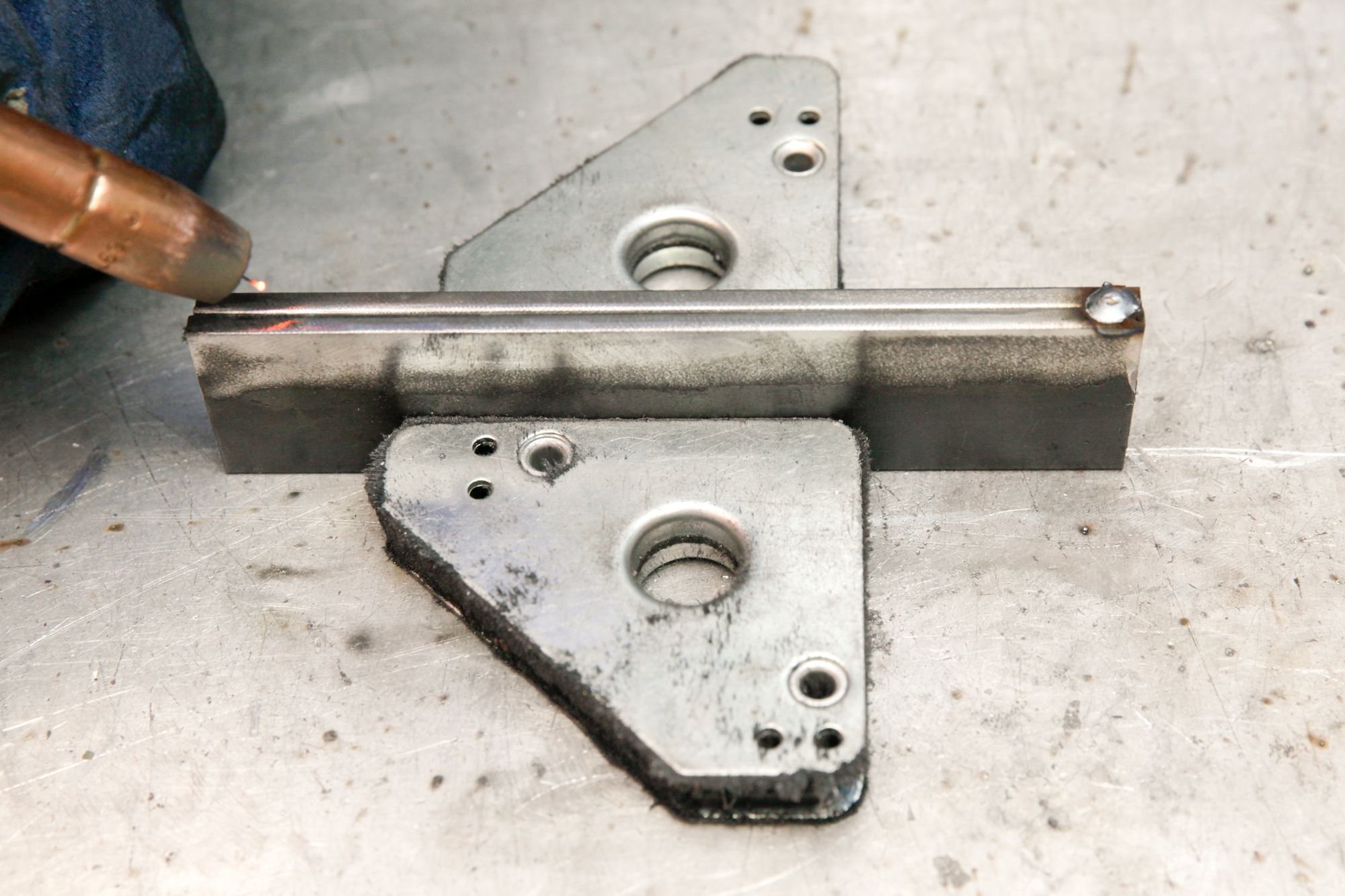

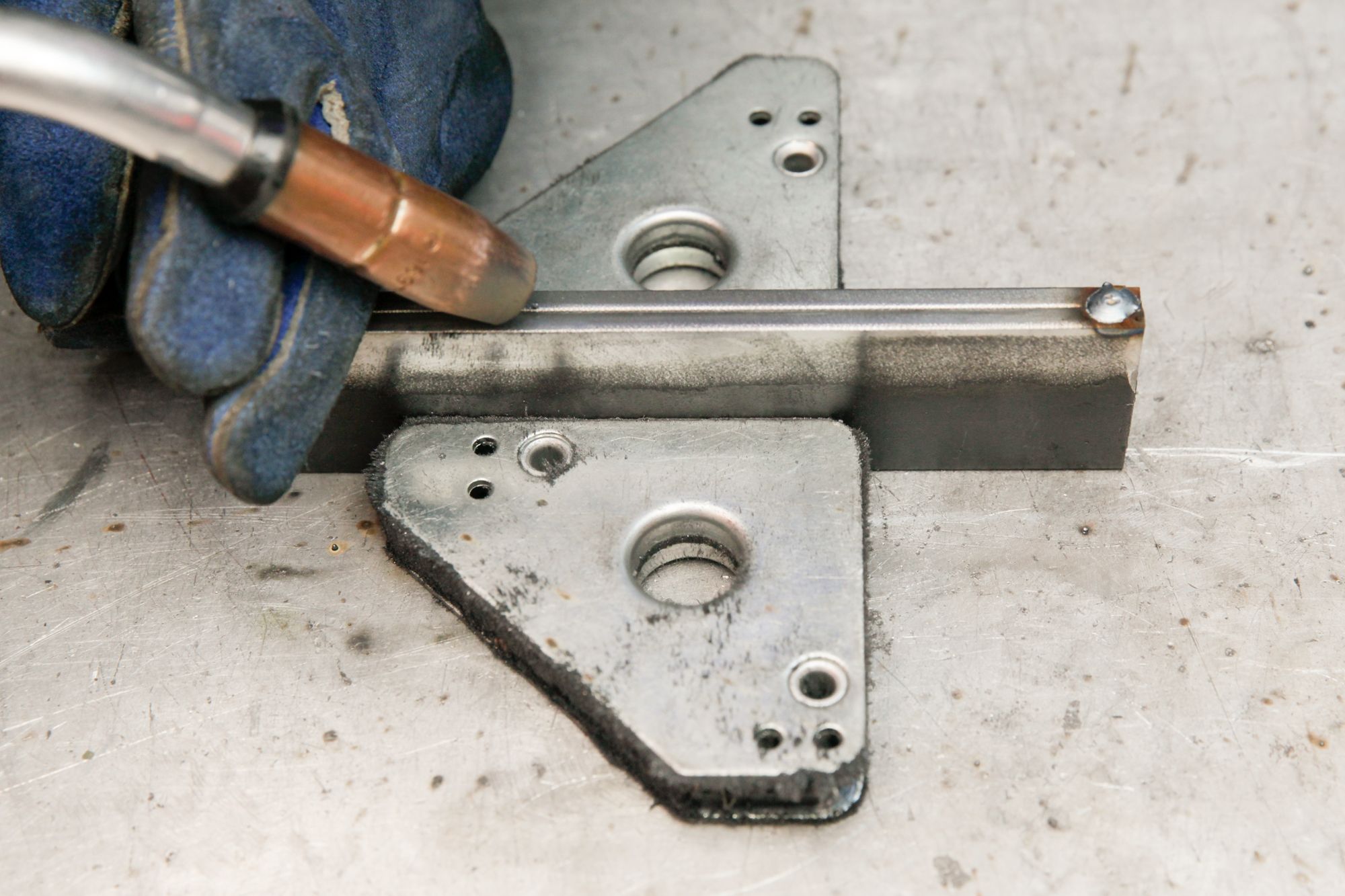

Complete your first tack weld. To do so, positon your electrode sticking out of the gun between the crevase of bevel valley you created with the angle grinder. Your wire should barely be touching your base material. Squeeze the trigger for two seconds, and complete the tacking loop motion.
Repeat this action, alternating side to side so that the heat spreads evenly until you have tacks spaced 1" to 1.5" apart across the span that is being butt-welded together.

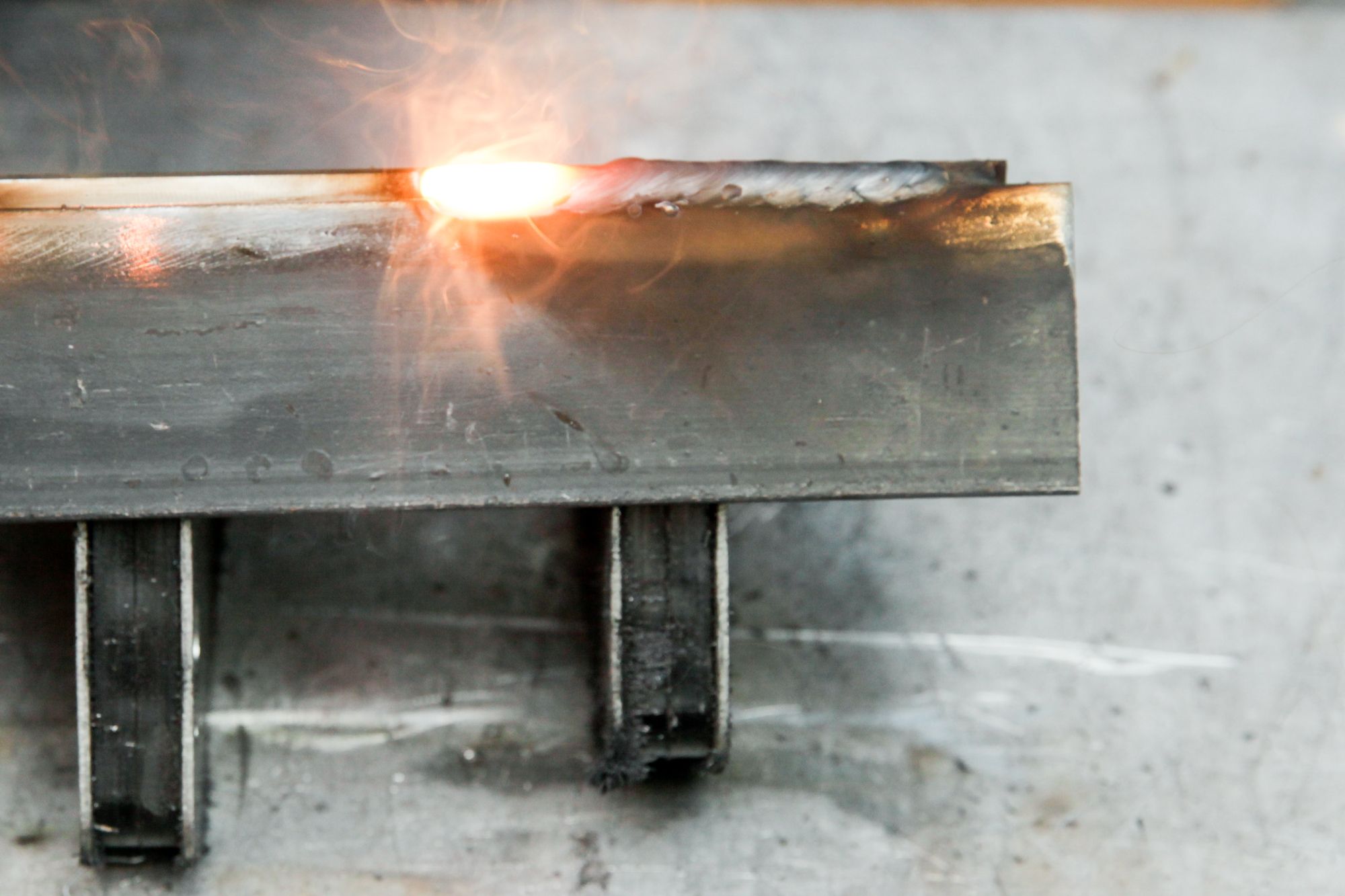

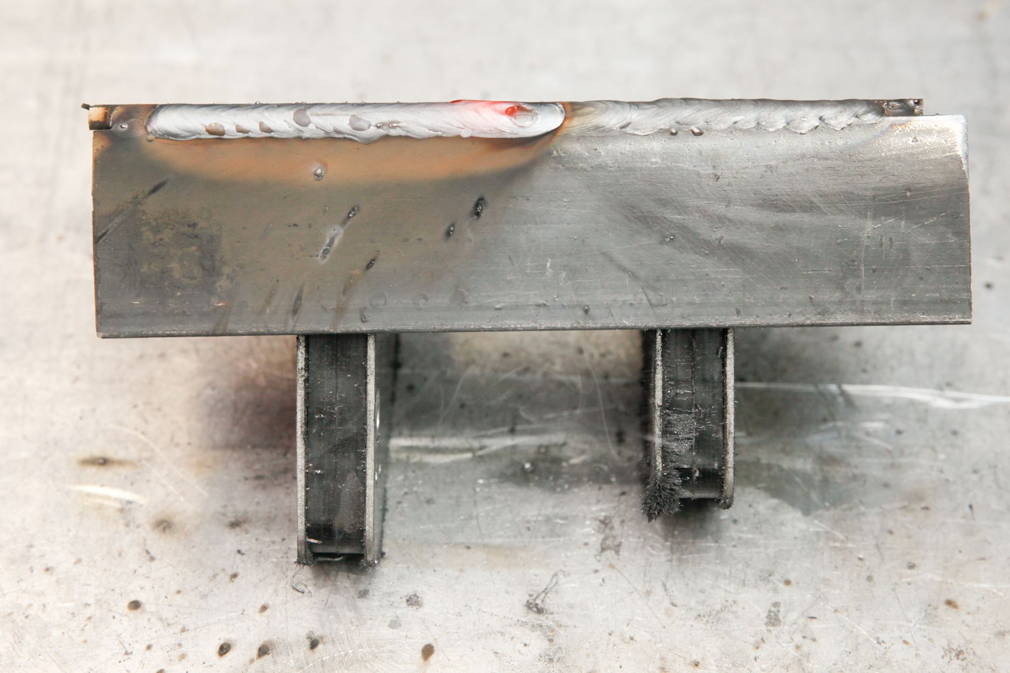

Run welded beads across your joint, start by connecting your tack on the outer edges than work your way towards the center. It's ideal to weld from the bottom of the stock up to the top, pushing the weld forward with the tip of the gun, however that isn't always comfortable or a good way to start learning. In the beginning, it's perfectly fine to weld in whatever direction/position that is comfortable and that works for you.
Once finished welding the the flat bar, you are left were left with a big bump where the filler material was added to the weld pool. You can leave that if you like, or you can grind it flat depending on what you are using the metal for.
If you find gaps ground in your weld, you may tack the gaps where the weld didn't penetrate properly, and grind the material down again. This typically means that you need to have more power and more wire to fill in the weld.

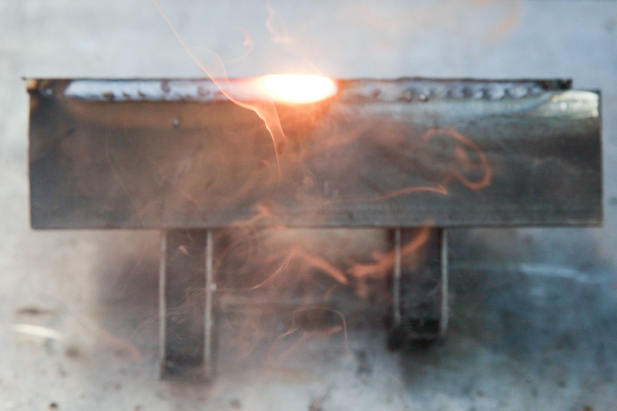

To learn the Tee joint, we first need to introduce the concept of fillet welding. Fillet welding refers to the process of joining two pieces of metal together whether they be perpendicular or at an angle. To perform a fillet weld, we change the way we position our welding torch against the material, so that we penetrate into the corner of our joint at an angle that will be well shielded and ensure strength.
The weld bead will not penetrate all the way through the other side of your base material like we see when we are welding on the sheet material from the Beginning to Weld Lesson.

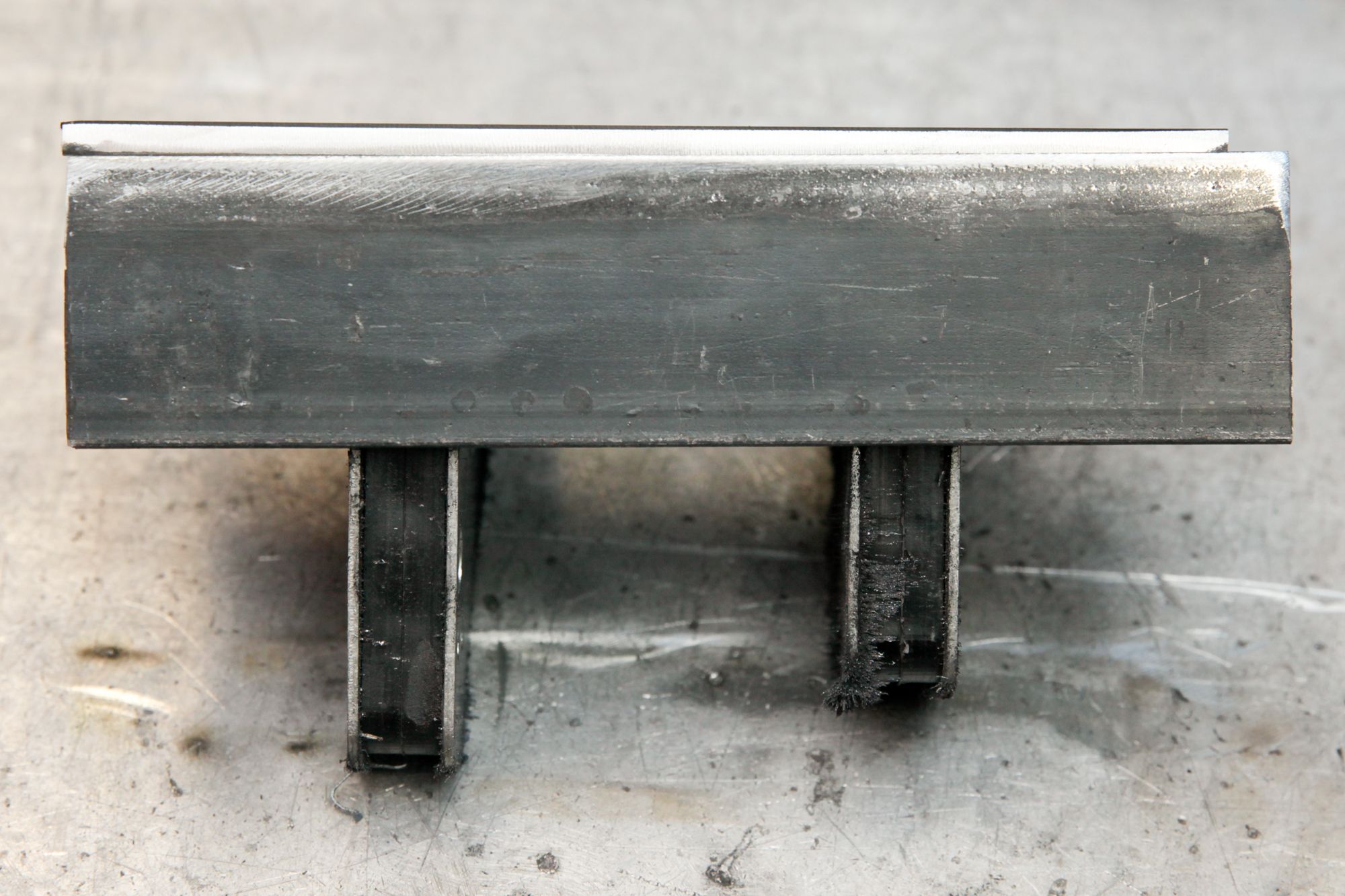

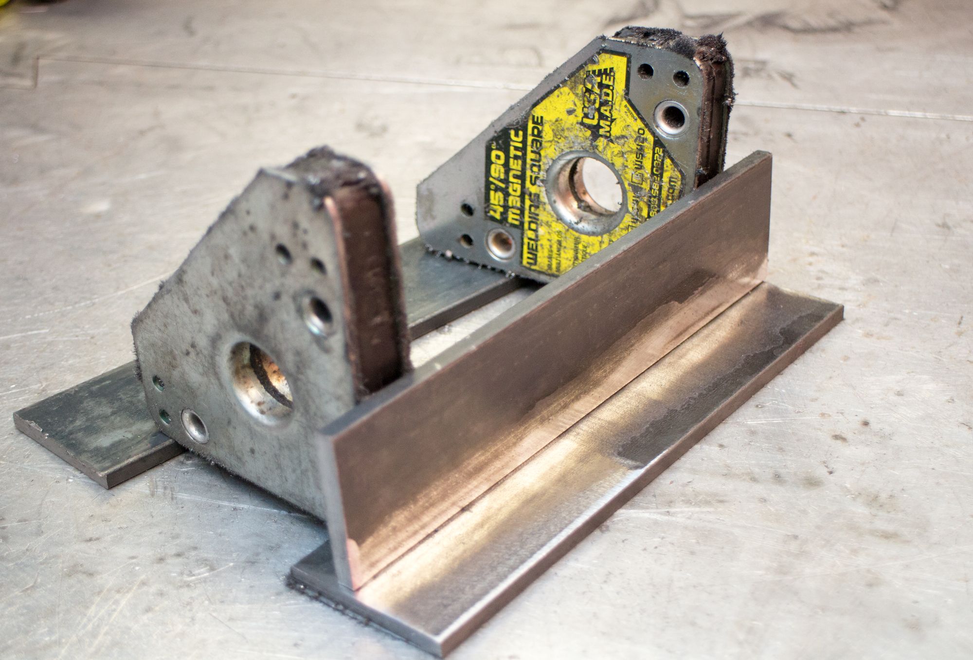

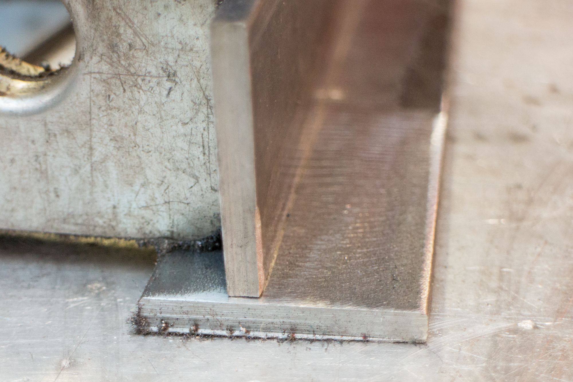

The tee joint is when two pieces of metal are perpendicular to each other at a 90 degree intersection. Prepare your metal for welding by grinding off the mill scale finish. You only need to grind off the mill finish where you intend to weld, remember to keep considering how to minimize your grind time.

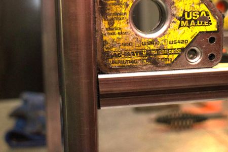

For a clean and close fitting weld, I recommend using magnets that will hold your material square to one another while you are making your first few tacks. Be sure to check your square between tacks using a slide rule or metal square.
Start by tacking each end, placing a tack weld on either side of the tee. Complete a tack in the center, before tacking the opposite side of the tacks you already placed in the center. Finish by tacking the back side of your previous center tack.
A fillet weld motion is not quite the same the chain of loops like we did for our butt weld, instead it is more like a rounded zig-zag shape, where we grab and melt the edges of the base material as we run the weld puddle across our joint. Run beads in sections along your joint, alternating side to side and back to front, working your way towards the middle. A nice fillet weld will form a neat even triangle shape between the pieces of perpendicular material.
