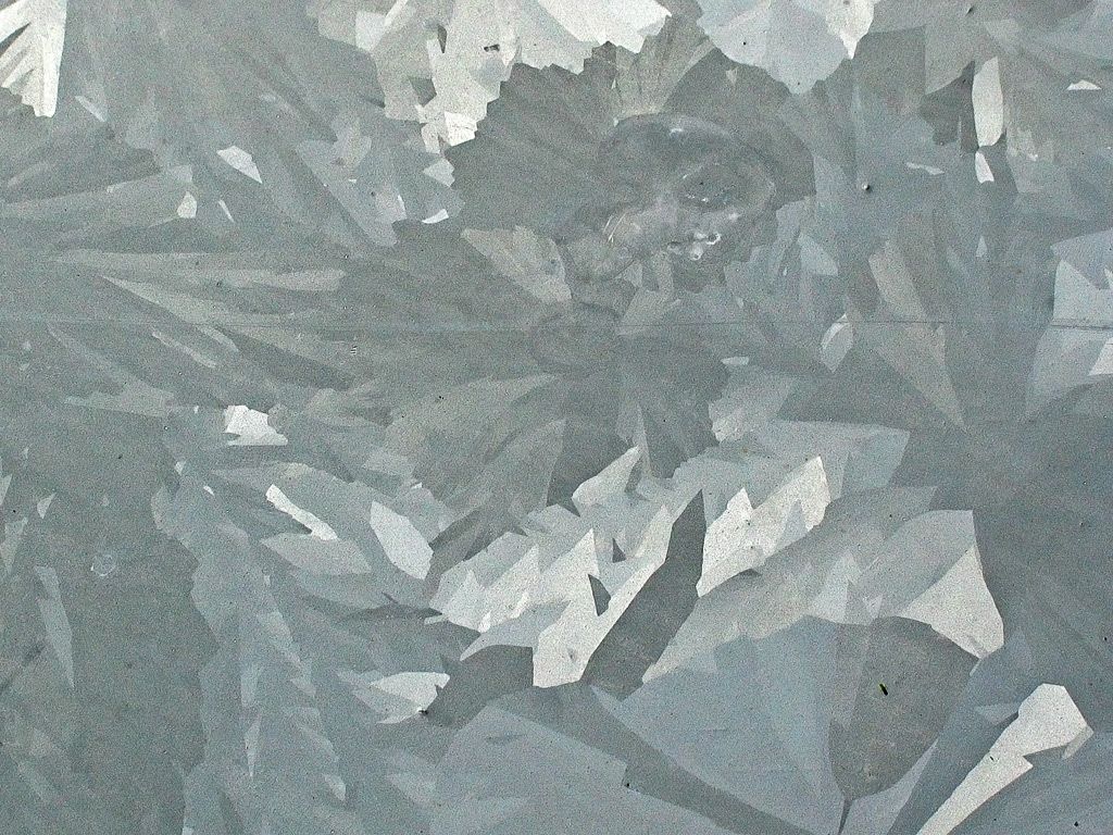

DO NOT WELD GALVANIZED STEEL. Galvanized steel contains a zinc coating that is applied to industrial steel to prevent rust over a prolonged period of time. (Think streetlamps, and bridge supports) This zinc coating produces carcinogenic and poisonous gas when it is burned. Exposure to the immolated coating can result in heavy metal poisoning also known as 'welding shivers'. These are flu-like symptoms that can persist for a few days, but that can also cause permanent damage. This is not a joke. I have witnessed someone who has welded galvanized steel out of ignorance and immediately felt the effects and had to be rushed to the hospital, so don't do it!

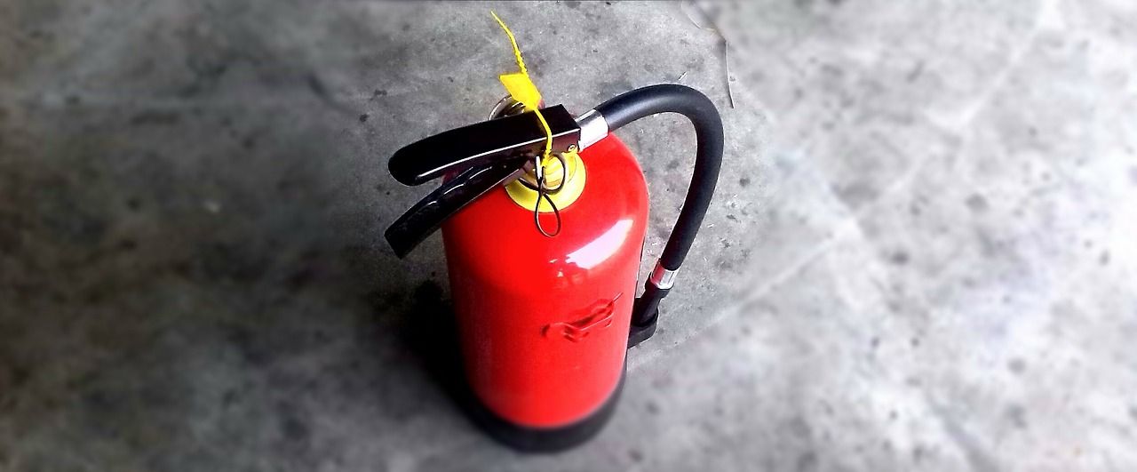

This is a good precaution for any shop, but keep a fire extinguisher beside the exit door from your workshop. CO2 extinguishers are the best type of extinguisher for welding. Water extinguishers are not a good idea in a welding shop since you are standing next to a machine which essentially transforms wall power into lightning.

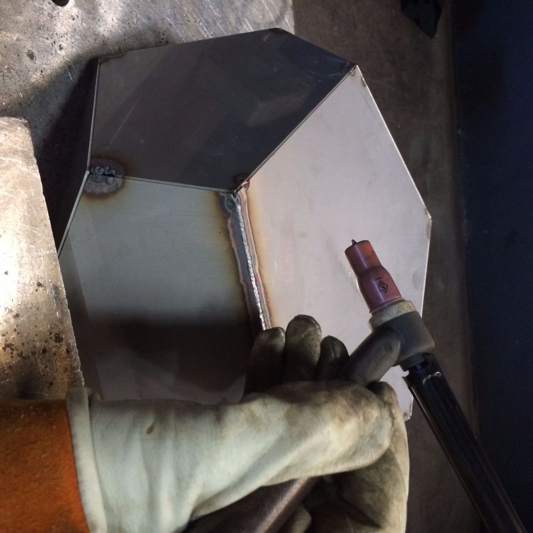

GTAW (Gas Tungsten Arc Welding), or more commonly Tungsten Inert Gas (TIG) welding is comparable to oxyacetylene gas welding and needs quite a bit of hand/eye/foot coordination from the operator. TIG welds are best suited for out high-touch work, such as sculptures and architectural features. TIG welds provide a superior finish that needs minimal clean up by sanding or grinding.
TIG welding provides a very clean way to weld. In one hand you wield a torch electrode and connect ground to your base material. You activate the flow of current with a foot pedal and control the amount of current on the welder. Instead of a consumable wire feed being burned from the torch, the person welding gently feeds filler material from a rod into the welding pool. Since you control the feed of material, slag splatter is minimal. If you are interested in learning more about TIG welding, check out this Instructable.

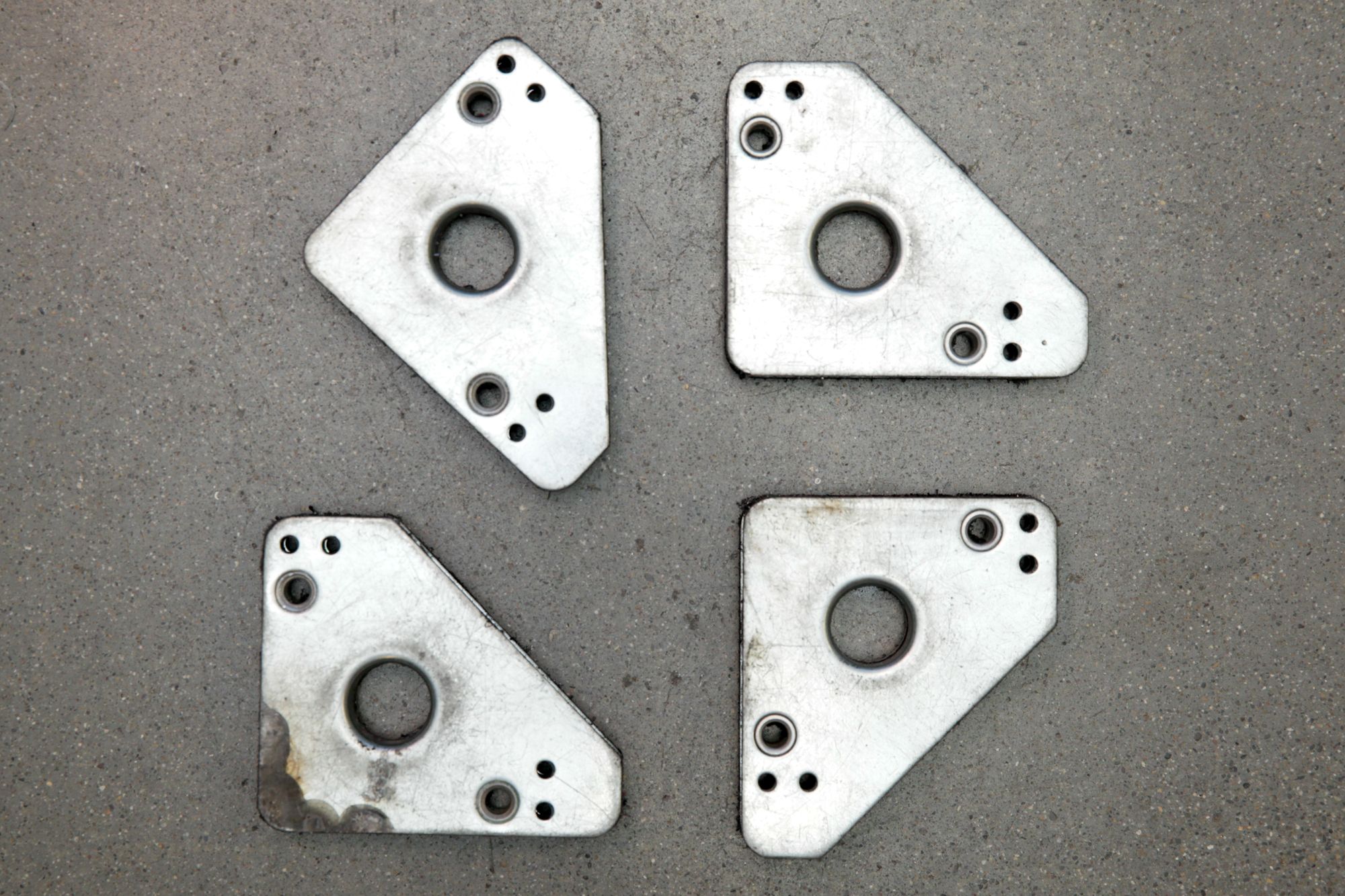

Tight joints are key when welding pieces of metal together. Using welding clamps and grips will allow you to set your work piece up firmly while welding it together. Clamps and grips come in all shapes and sizes, so be sure to find the right kinds of clamps for your job, I swear there is a clamp out there for every kind of job.
If you are wanting to work quickly, or don't need extensive jigging for holding your pieces together, consider using welding magnets. Welding magnets hold pieces at a variety of angles, but most commonly at 90, 45, 60, and 135.

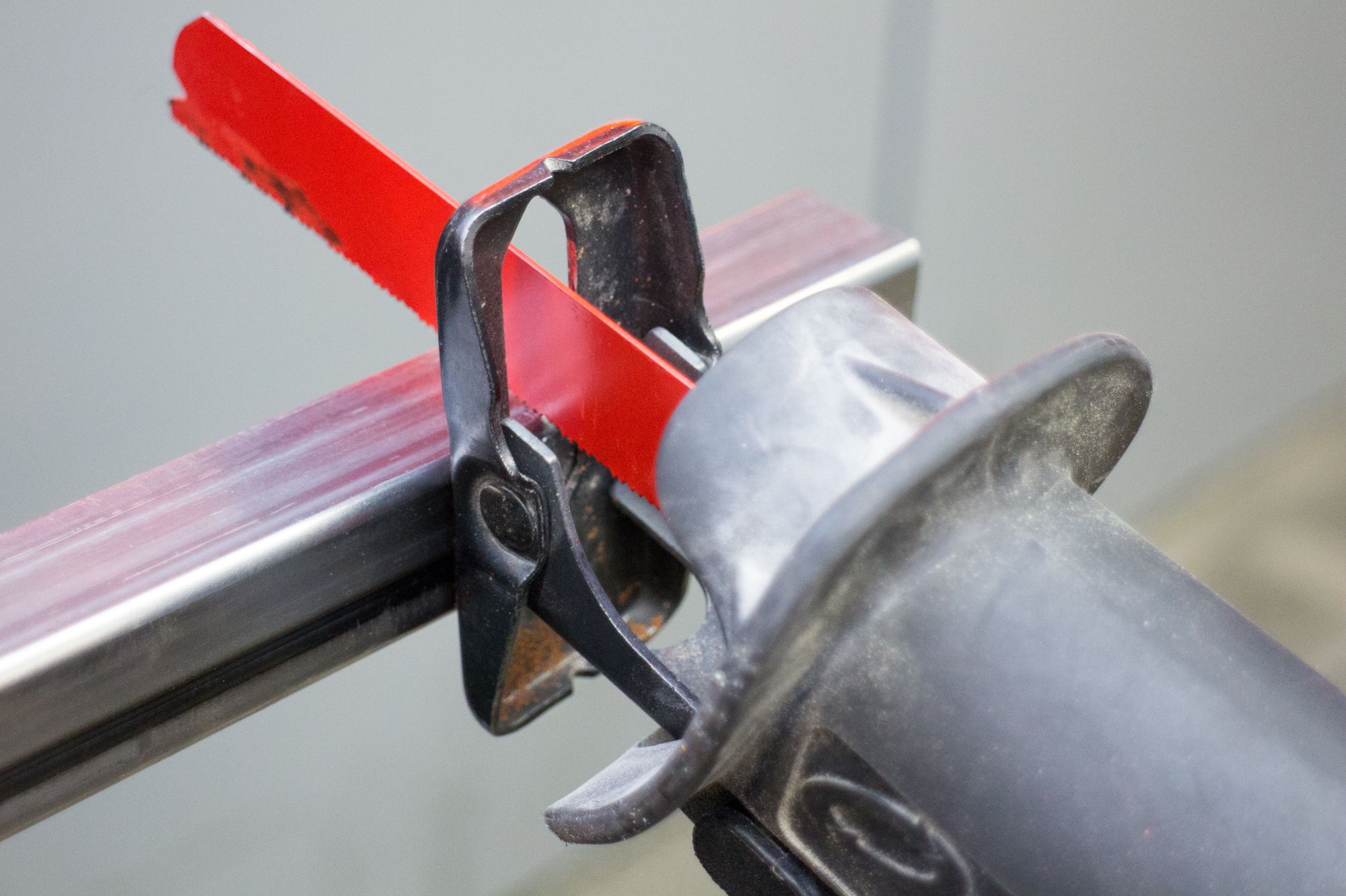

Another affordable power tool you can use to cut metal is a sawzall . Sawzalls with the correct blade for your material cut through a metal tube like butter. I find that if I score my material with a straight line using a cut-off wheel, this creates a groove for the sawzall's blade to follow. After scoring the grove, rotate the material 90 degrees and begin cutting with the blade following the grove. This yields a pretty quick, mostly square cut, that will require minimal deburring.

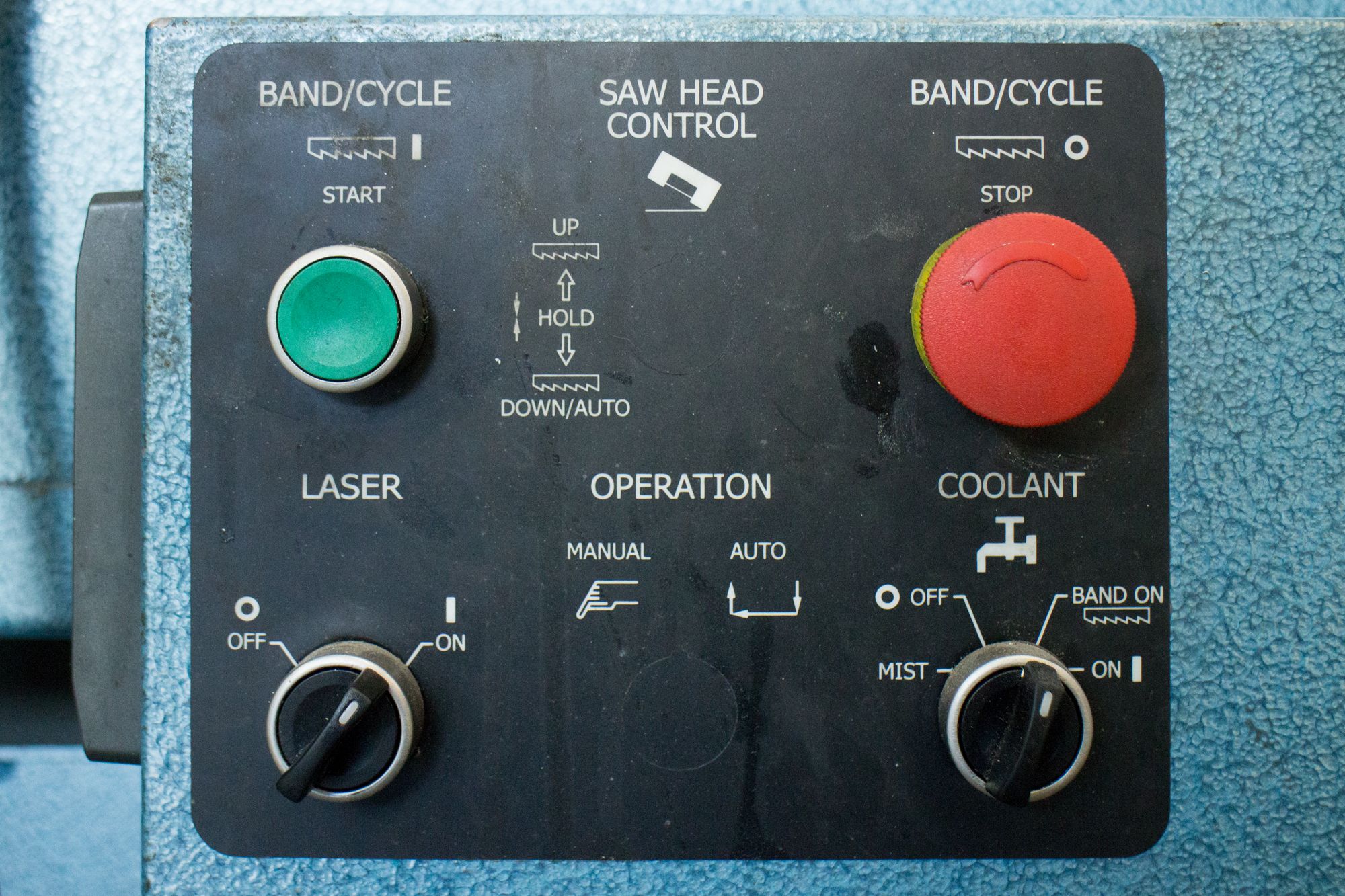

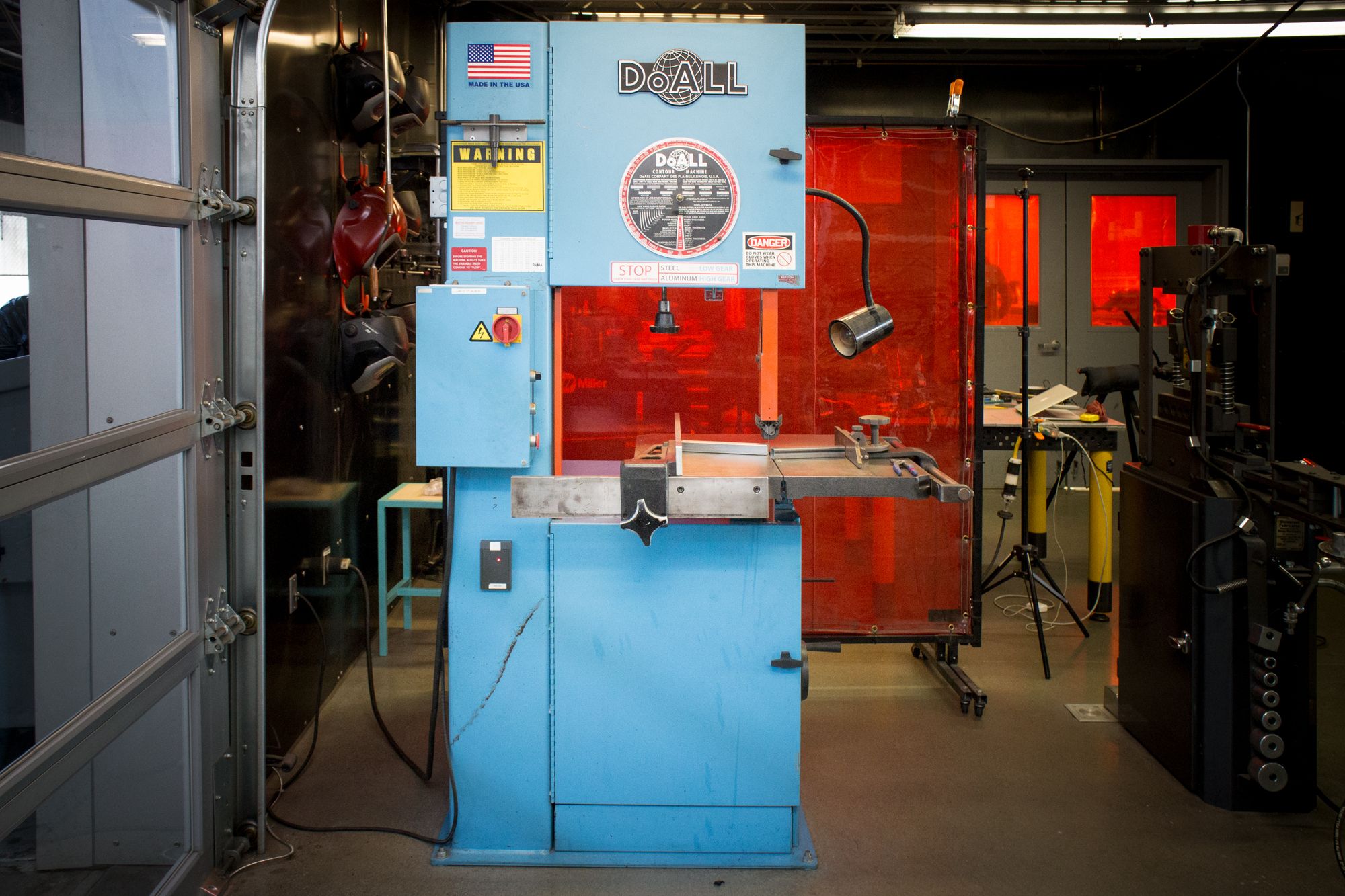

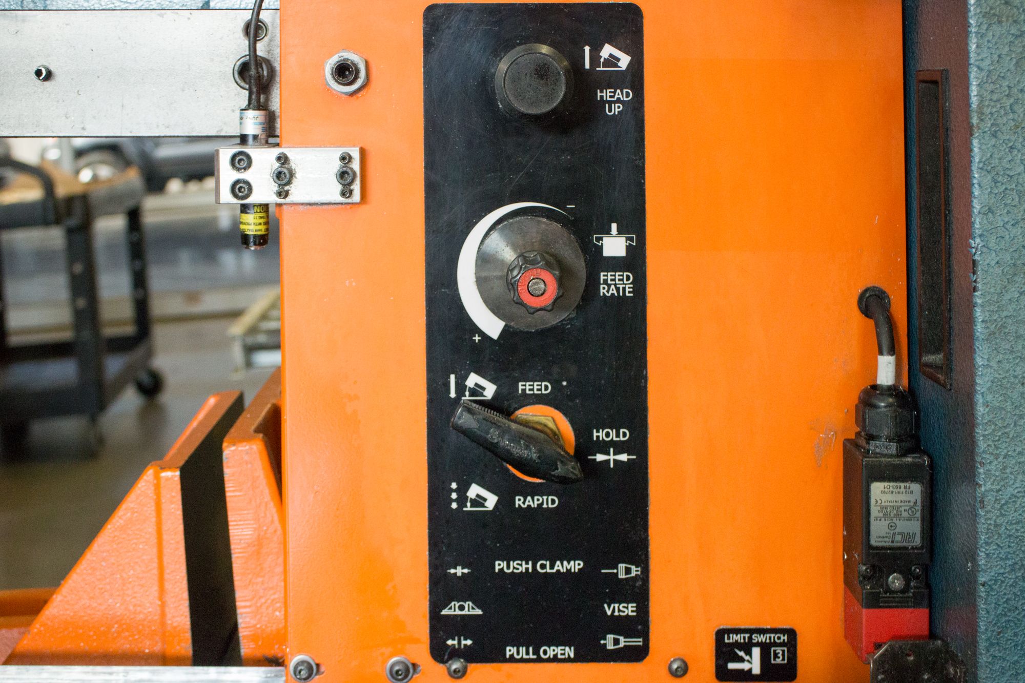

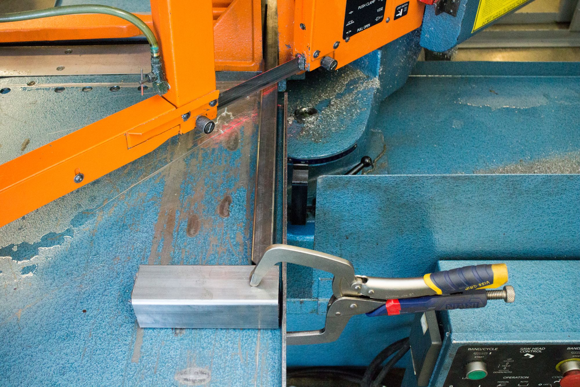

Lastly, let's go over bandsaws. Above you see a vertical bandsaw(left) and a horizontal bandsaw(right). The vertical bandsaw is great for making small cuts in solid material, but not advised for larger jobs, or hollow tube. The horizontal bandsaw is, in my opinion, the best tool a welder could invest in for cutting metal.
This bandsaw gives the operator the most control and reliability in making cuts. You are able to set the speed of the blade, the angle of the cut, and the speed of which the blade descends into the material. You almost never have to debur a cut made on the horizontal bandsaw, and if you do, its becuase your settings are too fast.
Often, if I have to make cuts of the same length over and over again, I will clamp a piece of material to the outfeed table at a set distance from the blade. This makes fast work for getting precise cuts over and over again. All I have to do is feed the material I am trying to cut until I hit the stop-block of the clamp, then I vice the metal and make the cut.

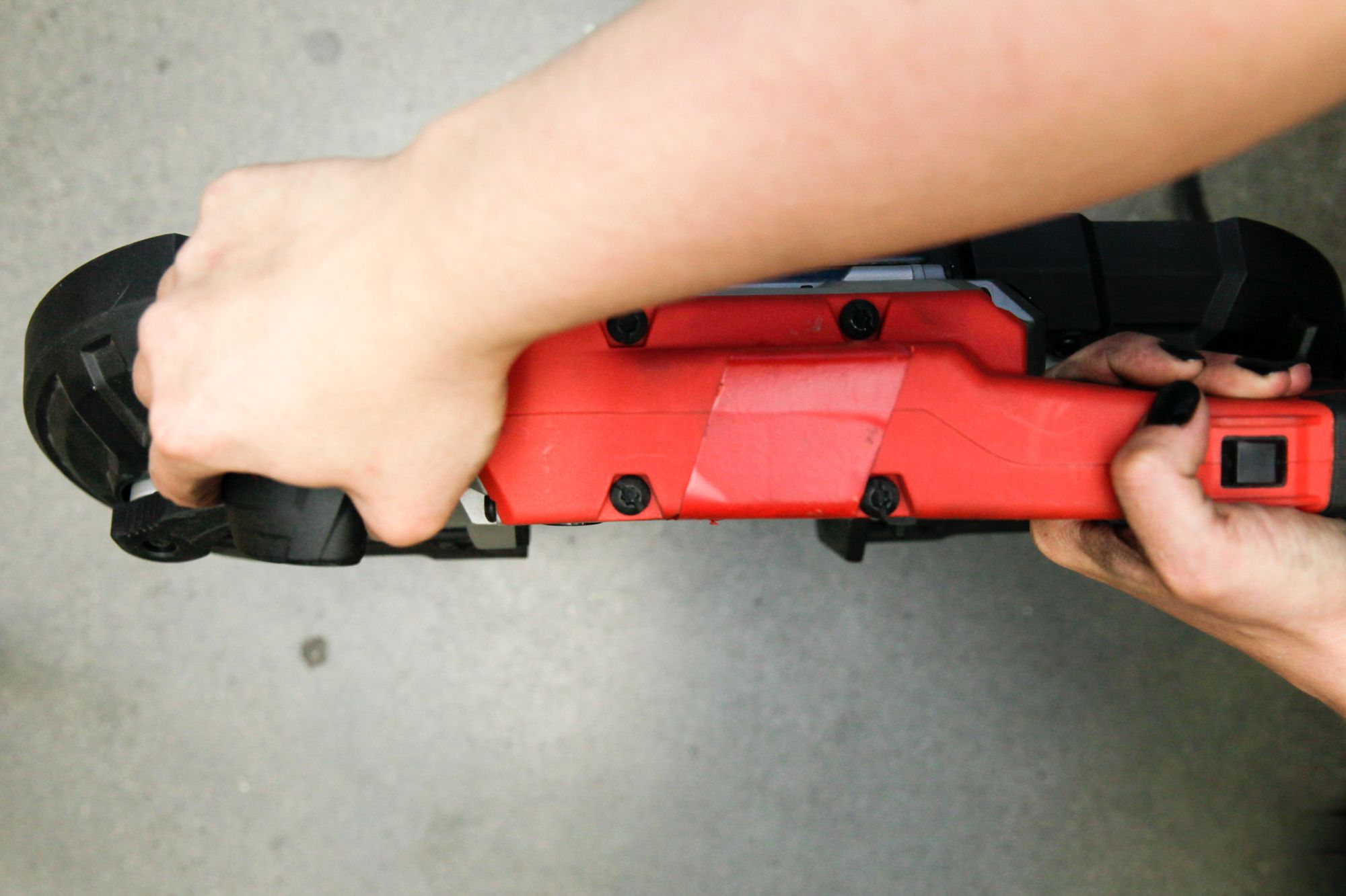

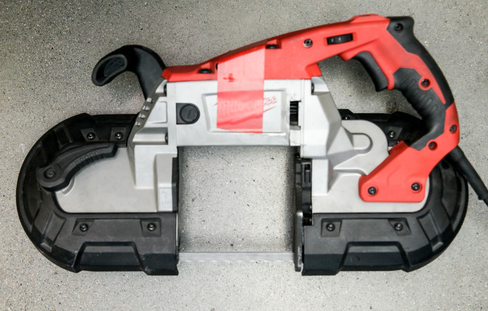

If you need to make accurate cuts on a jobsite, consider a portaband saw. They yield straight cuts that require minimal deburring, and often have variable speed control so you can set the blade speed for your material.
