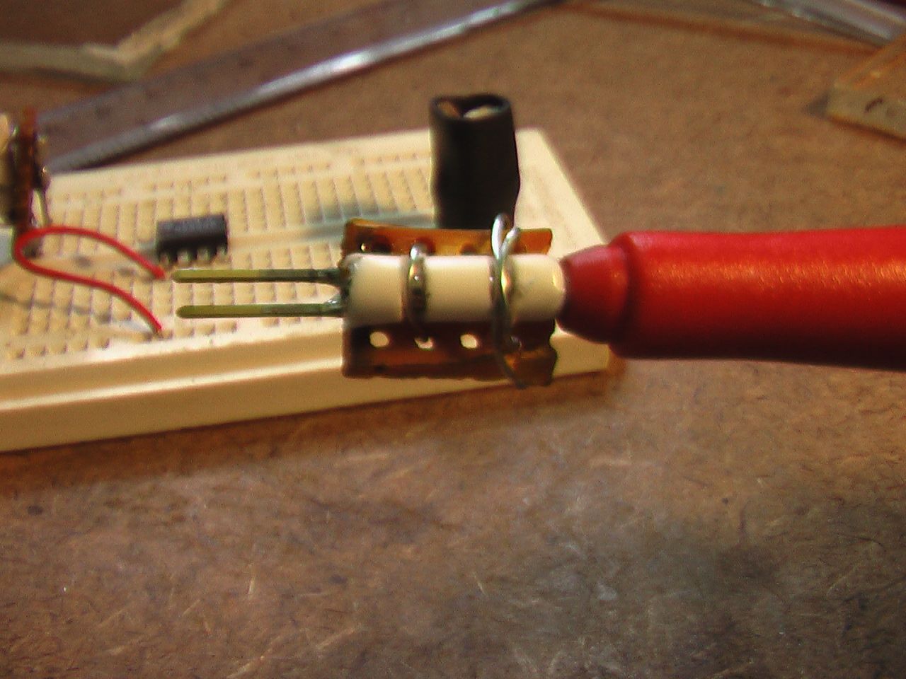

Step 2: Remove Screws and Remove Element From the SP40L.
Now you need to remove the 3 screws on the sp40l's heating element. That's all that holds it in there, along with the wires of course. Once you get the screws off, take a small flathead and gently poke at the bottom of the iron where the AC cord comes in. Pop it out of place into the iron handle so you can the remove the connection between the AC cord and the element.
Now, you have a replacement element ready to go.

Step 4: Connect the Wires to the New Element
Now that you've got everything apart, connect the 2 wires from the WLC to the new element.
The new element may have one shorter wire, but thats ok. I just used electrical tape on one end and kept the screw on connector cap on the other.
Fit everything back into place and screw in the first 2 screws of the WLC100 then screw in the 3 that secure the element in place.
You now have a (virtually) brand new iron and you didnt have to go online and wait a week for it to be shipped to you.
