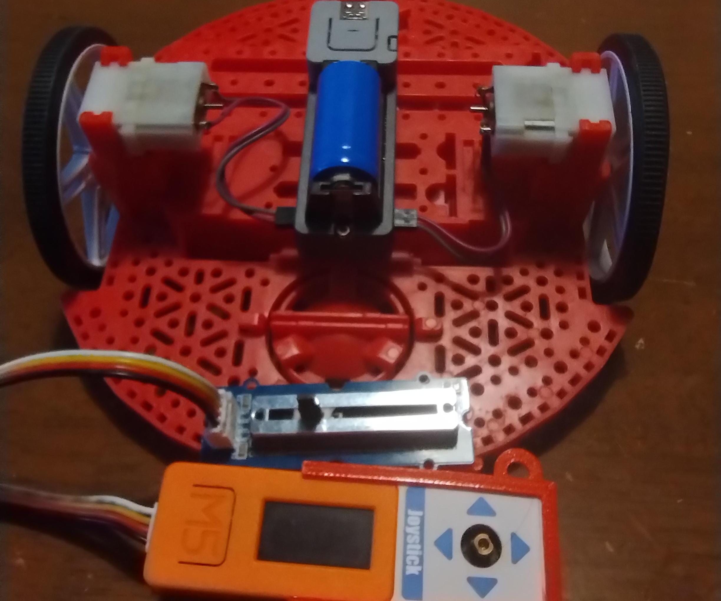

Step 2: The Pololu Romi Robot Chassis Build....
I choose to use the Romi Chassis because a local company had it on sale for a good discount, (I wish I had bought more now).
The kit comes with motors (120:1 HP offset output with extended motor shaft which is important later) and wheels which were designed to work with the Romi encoders we will be using later.
A different chassis can be used, but you may have some problems using the encoders.
The Romi Chassis is a easy to build, snap together kit - it also un-snaps pretty easy making it easy to expand, and replace parts.
It's made from a soft plastic material, and has plenty of holes for mounting various controllers and other item. Unfortunately for our build none really matched up with the D1 Mini Dual Base shield. (Which is easy to over come. but that is later in the instructable.)
First let's just build the chassis. The above video shows my build, which took about 20 mins to do - with the longest time spent on getting the rubber 'O' ring on the wheels.
The Pololu Romi Page has great build instructions. https://www.pololu.com/product/3500/resources
