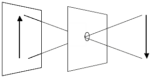

Why do we see an upside down image in a pin-hole camera?
The rectilinear propagation of light refers to the straight-line movement of light rays in a vacuum. In a pinhole camera, light travels in straight lines from the objects in the scene and passes through the small pinhole, creating an image on the opposite wall. The light rays passing through the pinhole are bent (refracted) slightly, but the bending is negligible because the pinhole is so small. Ensuring the box being used to make the pin-hole camera is completely black/dark can greatly reduce the chance for light to be reflected as well.
Because the light rays are essentially unaffected by the pinhole, they maintain their straight trajectory, creating an image on the opposite wall that is upside down and reversed from left to right. The image is inverted because the light passes through the pinhole and projects an image from the opposite side, and the image is reversed because the light enters the camera from the front and projects an image on the back.
So, the rectilinear propagation of light explains how pinhole cameras work by demonstrating that light travels in straight lines and can be used to form an inverted and reversed image of a scene on a surface through a small aperture.

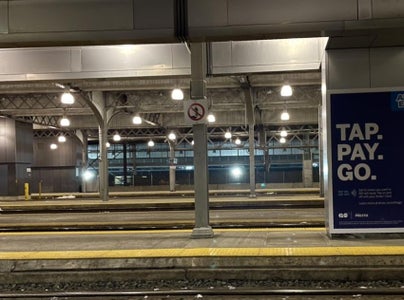

Step 2: Building a Large Pinhole Camera
Step 3: Building a Small Pinhole Camera
Calculation: d = c * √(f * λ) = 1.56 x sqrt(0.305 m * 550 nm) = 6.389*10^-4 = 0.025''
I selected a range of drill hole sizes to construct several apertures.
