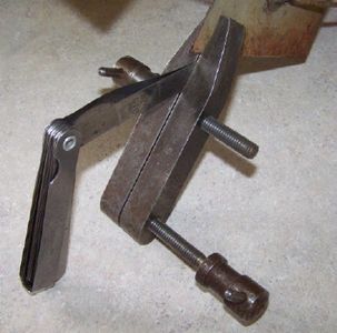

Needed: I do not have a micrometer. I used a machinist's clamp and a feeler gage set. You also need a sample piece of steel or wire you want to size.

Step 1: Place the Clamp
Attach the machinist's clamp to the steel or wire you want to size. As best you can, make sure the jaws of the clamp are parallel to one another when the clamp jaws are tightened.
Step 2: Measure the Gap
Place blades from the feeler gage set into the gap between the jaws as close to the steel or wire held by the clamp as possible. In this case, I was able to slide two feeler gage blades into the gap. The two together amount to 0.026 of an inch.
