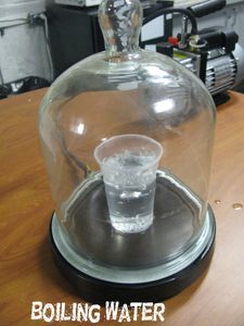

Step 1: Why Is Our Atmosphere Important to Us?
Materials
  1. Cup of water
  2. Bell jar
  3. Vacuum pump
Directions
  1. Place a cup of room temperature water in the vacuum chamber.
  2. Cover with jar and reduce pressure until water boils.
  3. Uncover and stick your hand in the previously boiling water, note the water should still be room temperature when you put it in ( do not stick your hand in recently boiled water in any other case )
Why?
Matter exists as either a solid, liquid, or gas (sometimes plasma). Air pressure from the atmosphere keeps water molecules on Earth’s surface compressed in a liquid state. If there’s not enough atmospheric pressure pressing the water into a liquid state, then there’s also nothing holding the water molecules together. In the vacuum of space the molecules are able to spread out, and begin to boil.

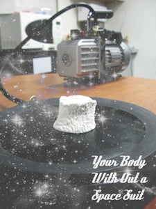

Step 3: What Would Our Bodies Look Like After Being Exposed to the Vacuum of Space?
Materials
  1. Bell Jar
  2. Vacuum pump
  3. 1 Marshmallow
Directions
  1. Place the marshmallow in the bell jar
  2. reduce the pressure and watch the marshmallow swell up
  3. Remove the bell jar and watch the marshmallow wrinkle up
Why?
The marshmallow represents humans' soft tissues, like those in our skin and organs, which contain water.
A vacuum will cause the water in exposed parts of our body, such as the eyes and mouth, to evaporate quickly, and eventually all the water within us would evaporate, leaving behind what is essentially a dried-out mummy. You can see this in the last picture.
Even if the pressure returns to normal, your body would not be the same after spending too long in space. This is because your cells themselves contain water which would evaporate, and since space is extremely cold, you would freeze and crystallize.
