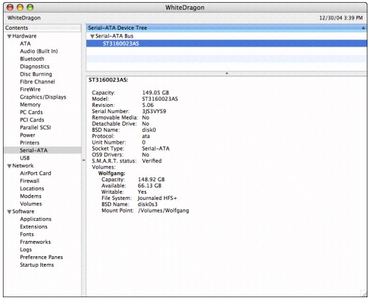

OS/X: (textedit to view)
You can go to the system profiler and output a text list of the hardware.
More info at:

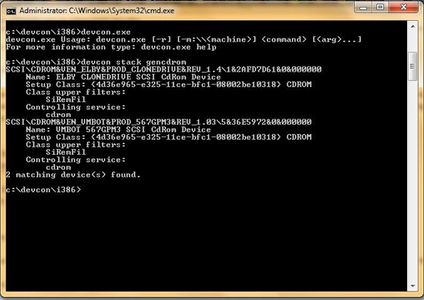

Microsoft windows: (notepad to view)
A script for older systems: http://richardspowershellblog.wordpress.com/2007/07/21/hardware-reporting-script-vbscript-and-powershell-versions/
For MSWindows 7, I am told you can use the Devcon utility to print out to a file of the hardware. More information at:
http://msdn.microsoft.com/en-us/library/windows/hardware/ff544746%28v=vs.85%29.aspxhttp://superuser.com/questions/278035/windows-7-device-manager-in-text-mode
