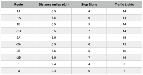

The Routes. The five routes and their designations are shown in Figure 1. The outbound (to work) routes and the number of times data were recorded for each were 1A (N = 8), 1B (N = 10), 2A (N = 10), 2B (N = 8) and 3 (N = 10). The inbound (back home) routes were -1A (N = 8), -1B (N = 9), -2A (N = 9), -2B (N = 8) and -3 (N = 9). The number of inbound trips was not the same as the number of outbound trips for each route in some cases. This is because it was not always convenient to drive directly home after work. The A and B versions of the routes only differed by a small deviation of choice not far tom the end of the outbound route (see Figure 1). The paths taken on the inbound and outbound routes were the exact opposites of each other. The characteristics of each route are summarized in Table 1

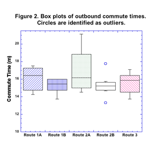

Outbound Commute Times. Box plots showing the minimum, 1st quartile median, median, 3rd quartile median and maximum commute times for the outbound and inbound routes are shown in Figure 2. Open circles on the plot are considered outliers (points whose value is either greater than the upper quartile + 1.5 * inter quartile range, or less than the lower quartile – 1.5 * inter quartile range).

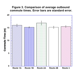

Comparison of the average commute times for the outbound routes, irrespective of departure time, are shown in Figure 3. One-way ANOVA analysis of the outbound commute times with Tukey”s HSD resulted in a p-value of 0.08732 indicating there likely were significant differences in the commute times (Figure 4). However, this is because route 2A tended to take more time than some of the others, not less time. Of the other routes, none required significantly less time than another.

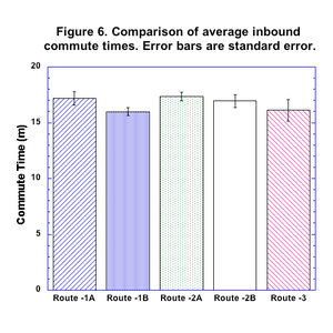

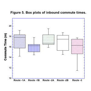

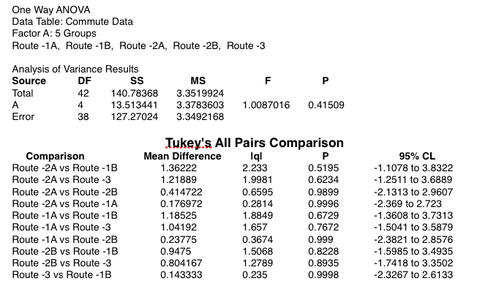

Inbound Commute Times. Box plots showing the minimum, 1st quartile median, median, 3rd quartile median and maximum commute times for the inbound routes are shown in Figure 5. Comparison of the average commute times for the outbound routes, irrespective of departure time, is shown in Figure 6. One-way ANOVA analysis of the outbound commute times with Tukey”s HSD (Figure 7) found no significant difference between the routes (p = 0.415).

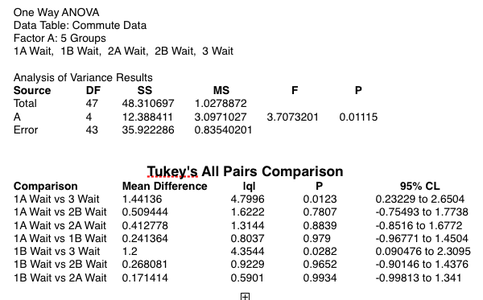

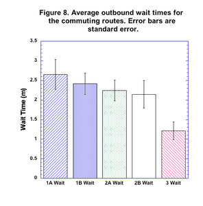

Outbound Wait Times. The average wait times for the outbound routes are compared in Figure 8. One-way ANOVA analysis of the outbound wait times showed that there was likely a significant difference (p = 0.011) with route 3 having less wait time than the other routes (Figure 9).

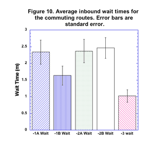

Inbound Wait Times. The average wait times for the inbound routes are compared in Figure 10. One-way ANOVA analysis of the inbound wait times indicated a clearly significant difference between the routes (p = 0.005, data not shown) with route 3 once again having the lowest wait time. Although the average wait time for route -1B was lower than the others it was not significantly lower (p = 0.32 - 0.41). In addition, there was no significant difference between route -1B and route -3 (p = 0.59).

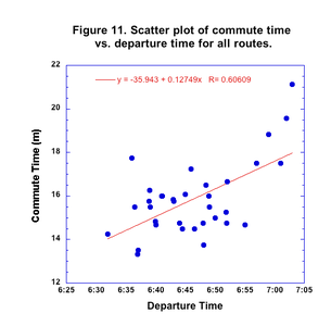

Effect of Departure Time. To see if there was a relationship between commute time and the time of departure, all the outbound morning commute times between 0630 and 0705 were plotted against their departure times. Figure 11 shows that there is a generally increasing trend in commute time, with later departure times. An additional analysis where each of the route commute times were individually plotted against departure time showed that in all cases a line of best fit had a positive slope indicating a trend of increasing commute time with later departure times (data not shown).

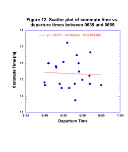

Since most of the departure times from 0640-0655 seemed to result in similar commute times an additional analysis of commutes with only those departure times was conducted and shown in figure 12. The slope of the curve fit is close to zero indicating that departing at any time between 0640-0655 resulted in about the same commute time.

As might be expected, earlier departure times seem to result in shorter commute times in the morning (See Figure 11), but only up to a point. This could be because there is less traffic at that time of day, the operation pattern of the lights either changes at some point, or the lights are encountered at more favorable times when leaving earlier. Further analysis would have to be done to determine the cause.
