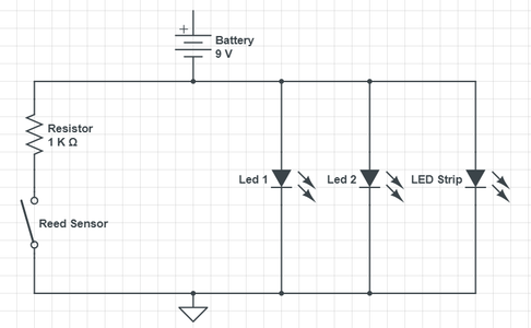

The flower component and the bee component each had their own separate board, so in total the project used two arduino boards to create multiple interactions for its audience. The flower has leds and a led strip coded in that light up using a reed sensor that reacts to magnets. I put magnets in the bee's head, so that when the bee's head get close to the reed sensor within the flower the reed sensor sends a signal to the arduino board telling the leds and the led strip to light up.

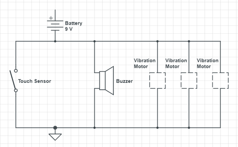

The bee component allows for the user to make the bee buzz and vibrate, ultimately symbolizing the real aspects of a bee and giving kids a closer look and feel of what bees are like within them having to experience a potential bee sting. Inside the stinger of the bee is a touch sensor, so when the user touches the stinger the touch sensor sends a signal to its arduino board to tell the vibration motors to vibrate and the buzzer to make buzzing noises.

Step 1: Circuit Schematic
The circuit with the leds is my flower circuit, and the circuit with the vibration motors is my bee circuit. Both circuits are running with a 9 volt battery source. The flower circuit has an input of reed sensor, which is either open or closed. When the reed sensor is closed, the leds and led strip will receive power and light up. When the reed sensor is open, the leds and led strip will receive no power. In the bee circuit, the input is a touch sensor. When the touch sensor is closed, the buzzer and the vibration motors will receive power. When the touch sensor is open, the buzzer and the vibration motors will not receive power.

Step 3: Flower Circuit
For my flower circuit, I have two green leds, a led strip, and a reed sensor all hooked up in the final view. In the final view all the green cords, with the exception of the led strip (yellow cord), are all leading to the flower. I tried to keep my board neat and use reds for power and blues/blacks for ground. In addition, I also have a 9 volt battery hooked in the final photo. My reed sensor is hooked up to pin 3. My two regular leds are hooked up to pins 4 and 6. My led strip is hooked up to pin 10. This board allows for the reed sensor to send a signal when it detects magnets; When this signal is sent, power is distributed to the led outputs.
Step 4: Bee Circuit
For my bee circuit, I have a touch sensor, a buzzer, and three vibration motors hooked up in the final result; in addition, I also included a 9 volt battery so that the bee can be mobile and make my project much easier to interact with. In this circuit, I tried to follow my example in the flower circuit and mostly use red jumper wires for power and black jumper wires for ground. In the final photos, I used blue to indicate my outputs (my buzzer and my three vibration motors). My touch sensor is hooked up to pin 3. My buzzer is hooked up to pin 10. My three vibration motors are hooked up to pin 5, pin 6, and pin 7. This board allows for the touch sensor to send a signal when it is touched; when this occurs, power is distributed to the buzzer and the three vibration motors.
