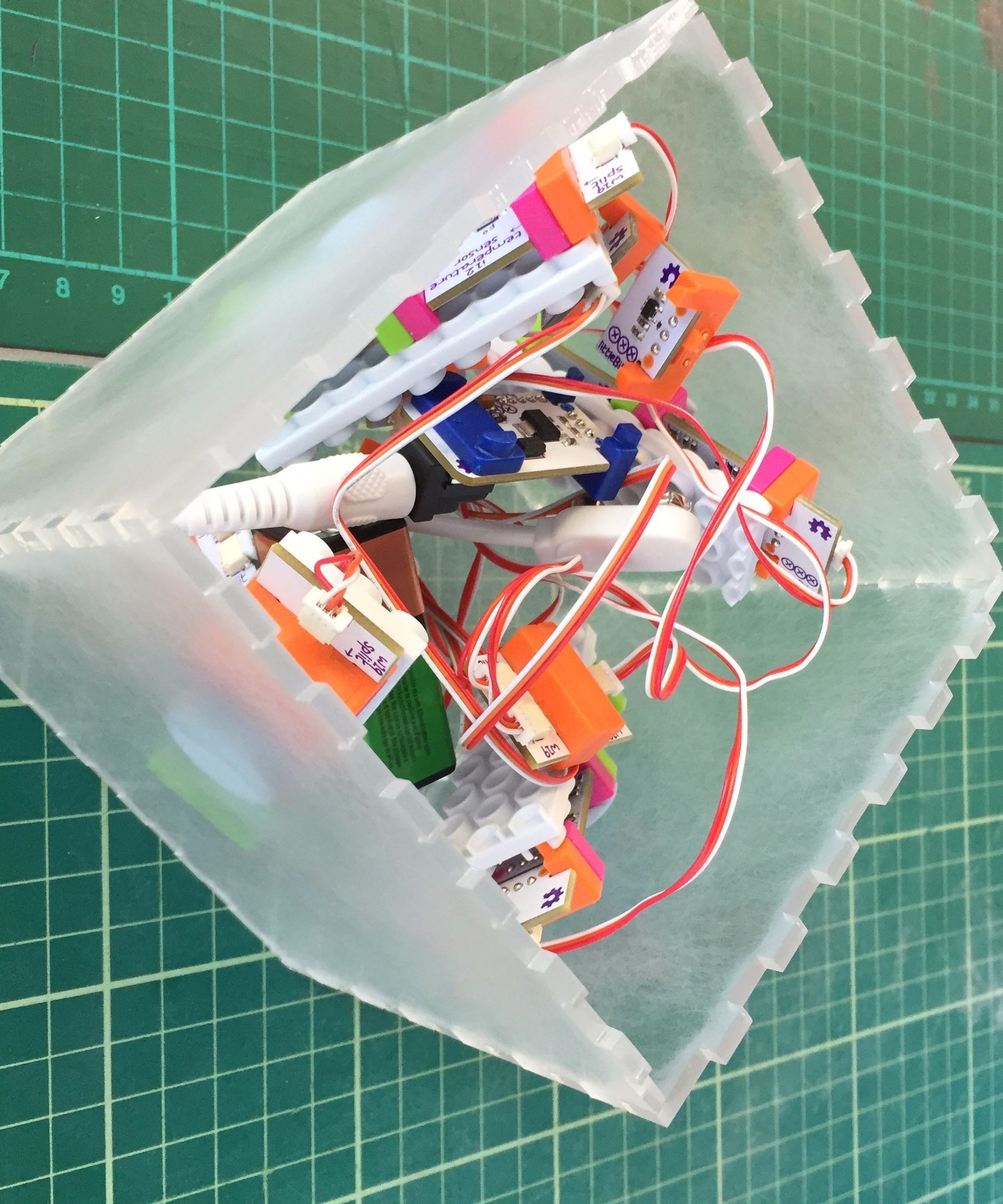

If you do not have a inverter bit to hand, improvise! I only had a NOR bit so I used this instead. The purpose of the gate is to have either the cloud light on or the sun light on at a time, depending on the output of the cloudbit. Test the logic out using a button in place of the cloudbit. I added some bright led bits connected to wires to make the light brighter.
Step 5: Assemble and Mount
Stick the sun and cloud together with glue. Place the littlebits on the mounting board and stick the leds behind the cutouts so they glow from behind. Place the mounting board on a table and stick the cutouts on the wall. I covered the lights on the power and cloudbit with bluetac to not confuse looking at the other lights. Add a title of ‘weather tomorrow’ above if you want other people to understand your cryptic sun and cloud!
