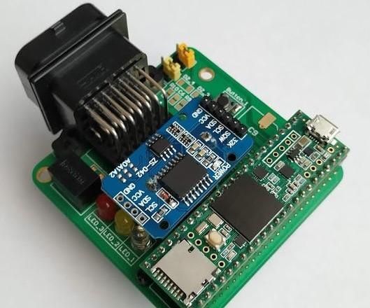

Before proceeding with the manufacture of the PCB, the developed schematic was tested on breadboard in order to validate it to make sure that the module would work as intended. For this, the schematic was mounted on a bench where an adjustable power source was used to simulate the car battery and power the module and a CAN module to send information and simulate the vehicle's communication bus.
Step 3: Design PCB
Taking into account the application of this module, since it is to be in the formula type vehicle, there was a need to develop the PCB with the smallest dimensions possible. For this purpose, very small sizes were defined for the thickness of the PCB tracks (0.18mm) and tracks (0.35-0.7mm) in order to save space and the components were positioned in order to minimize the free space on the PCB. As a final result, the PCB shown in the figure was obtained with the following dimensions 45x24 mm.

As the last step of this process, after receiving the PCBs sent by the manufacturers and gathering all the necessary components, the final assembly of the modules for implementation in the car was carried out, as shown in the figure.
Then is welding carefully every component to the PCB and test to evaluate if everything works fine :)
