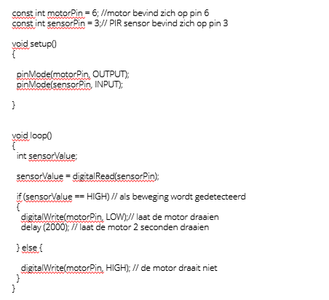

Step 2: Add the Code
Then open arduino and add the code:
const int motorPin = 6; //motor bevind zich op pin 6
const int sensorPin = 3;// PIR sensor bevind zich op pin 3
void setup()
 pinMode(motorPin, OUTPUT);
 pinMode(sensorPin, INPUT);
void loop()
 int sensorValue;
 sensorValue = digitalRead(sensorPin);
 if (sensorValue == HIGH) // als beweging wordt gedetecteerd
   digitalWrite(motorPin, LOW);// laat de motor draaien
   delay (2000); // laat de motor 2 seconden draaien
 } else {
   digitalWrite(motorPin, HIGH); // de motor draait niet

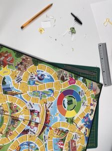

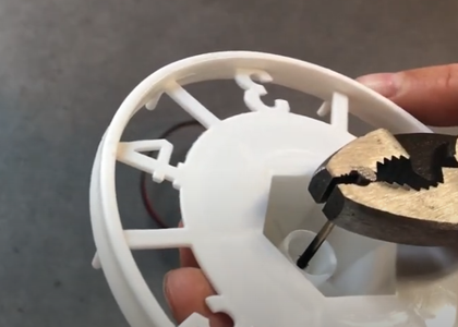

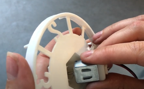

In order for the wheel to turn by the dc motor, the wheel must be adjusted so that the dc motor fits in it. For this I used pliers and a hot needle, this hot needle melts in the wheel a hole in which the rod of the dc motor fits.
Test the wheel first if it will turn with the dc motor, if it is too heavy it will not turn.
Also cut holes from the board game where the DC motor and motion sensor should be.
I decided to put the motion sensor in the middle.

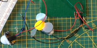

Step 4: Solder the Circuit
The circuit that was made in step 1 is now finalized by soldering it together, I used a printed circuit board for the L293D.

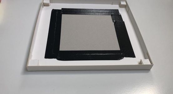

Step 6: Make a Bottom for the Board Game
Now that the circuit is glued to the board game it can't go back in its original box and also because it is unstable on the floor I made a bottom. This can be done very simply by measuring the dimensions of the board game and using it. I also cut out the bottom of the original box and glued it to the new bottom to keep something of the original box. Along the corners of the bottom I also added elevations for the board game to lean on.
