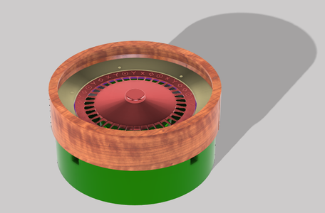

Introduction: Wheel of Fame: Modern Roulette Wheel
Project T.E.G.L. (Tyler, Enzo, Gavin, Logan) have unanimously agreed to recreate French Inventor Blaise Pascal's most celebrated creation: The Roulette Wheel. Eye-catching, fun, and safe!

Step 1: 3D Printing

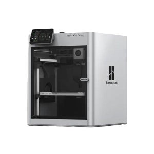

First, my favorite part: 3D printing! Preferably use a Bambu Lab X1 Carbon 3D Printer for smaller parts and a Bambu Lab H2D for larger ones.
Caution: This build requires mountains of filament, but end result is worth it.

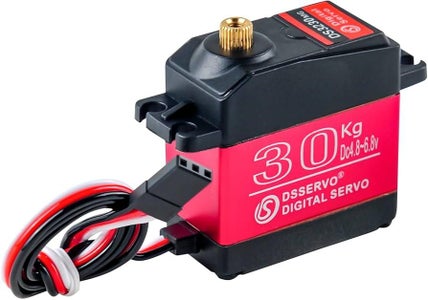

We then had two servos on our device: a 25kg servo to move our motor out of the way and an MG90S micro servo to move the IRIS module.

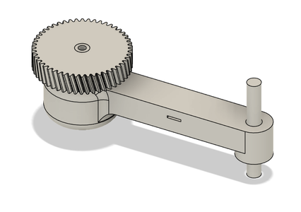

Step 5: Motor Holder Shaft
Print out the 4 parts. Attach them together by referencing the Fusion. Now, screw in the Drone Motor into the appropriate socket.
Attach the servo arm to the motor holder shaft using a strong metal wire (i.e. paperclip) by threading it through a rectangular hole in the middle of the MHS_MainShaft.

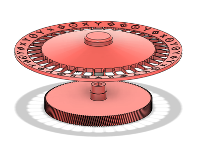

Step 8: Main Spinner
Print out the 4 parts. Use hot glue to attach the MS_TopShaft, MS_MainSpinny, and MS_MainGear together.
Attach the MS_30Tooth gear to the 5V Stepper Motor 28BYJ-48 attached to the casing.
