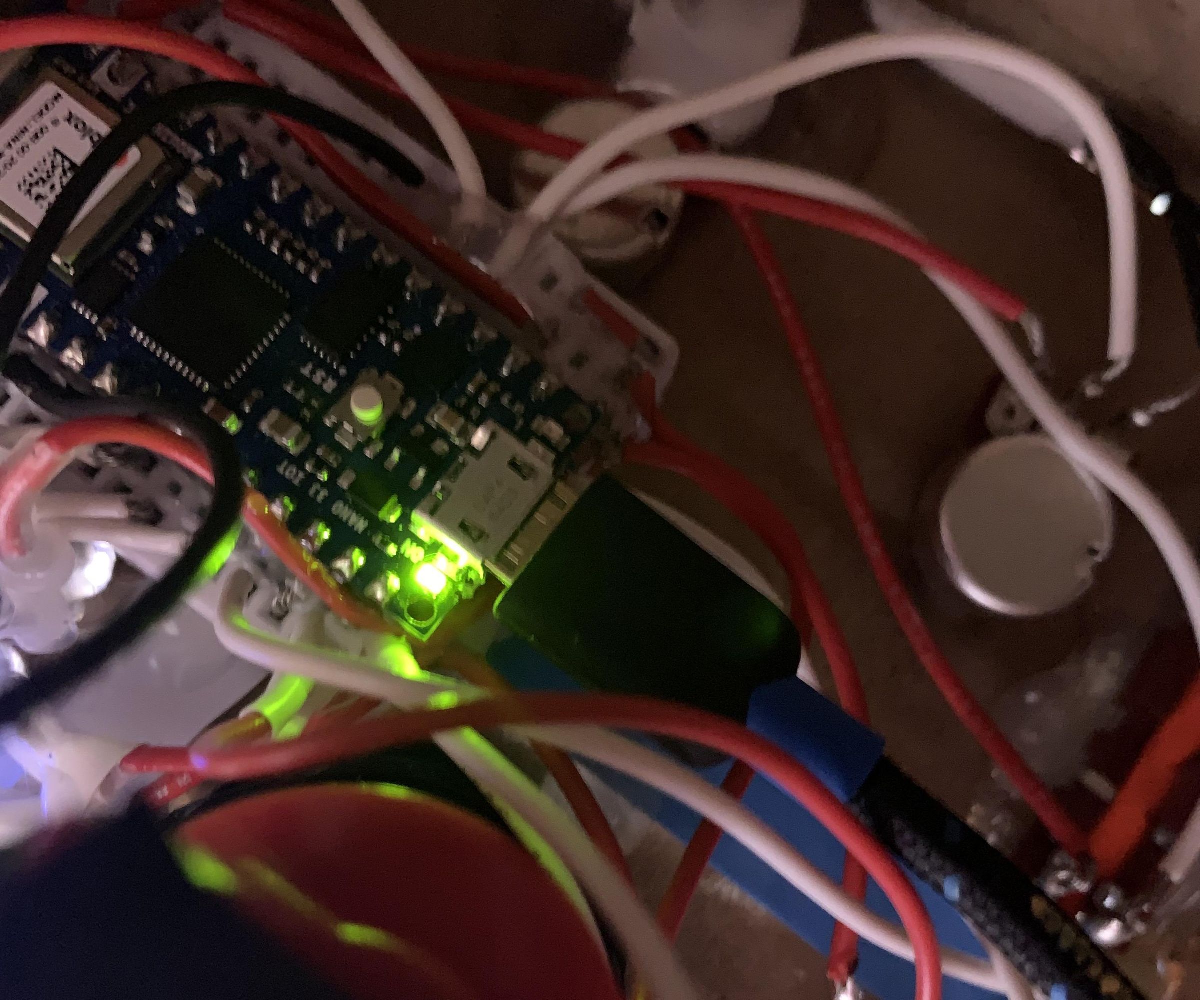

The circuitry and code for this project are fairly straightforward and include a relatively small number of parts, the main focus should be on creating clean and well-organized circuitry. When starting off making your circuit I recommend using a regular breadboard so that you can make sure all of your components are working before getting into soldering. For programming the neopixels I used the FastLED library, which makes neopixel programming easy and, well, fast!
I began by choosing a color for the LEDs that I enjoyed. FastLED lets you use the HTML color library to define neopixel colors, and so I was able to filter through a range of colors quickly to choose the right one. Because the point of this project is to express your personality through your wheelchair, make sure that you're picking a color that suits you, I went with Indian Red. Once I had picked the color, I then added gamma correction to make it more rich and vibrant. Using FastLED doesn't allow you to use gamma correction functions that are built into the neopixel documentation, so I had to create a separate gamma correction function that I could call to correct the LED color before it was displayed. I then created a simple moving light animation within the main LEDs. Adding this animation makes the neopixel look more natural as it is actuated by the tilt sensor, rather than turning the whole LED strip on or off.
Once the neopixels were programmed, I then had to actuate them with the tilt sensors. Most of the tilt sensor code was pulled from the Adafruit tilt sensor documentation, and was then modified slightly to incorporate the strip of neopixels rather than a single LED. Rather than turning the neopixel signal on and off, it is easier to simply put the brightness at full or at zero, which has the same effect. By attaching the tilt sensor to the wheel, it will actuate as the wheel turns which is a simple way to make it appear as if the lights are turned on by the movement of the wheel.
Once you have gotten all of your components working on a breadboard, it's time to move everything over to a solderable board. When soldering your board, it's important to make all of your wires as small and clean as possible so that they won't get caught or tangled by the movement of the wheels. I recommend using regular PVC wire for most of your connections and using silicon wire for your neopixel connections which allows you to place the neopixel strip more easily.
The final step for completing your circuit is incorporating an external battery. To do this, all you need to do is create connections on the ground and battery pins of your trinket, and then connect those to an external battery. I would recommend using a lipo battery because it's rechargable.

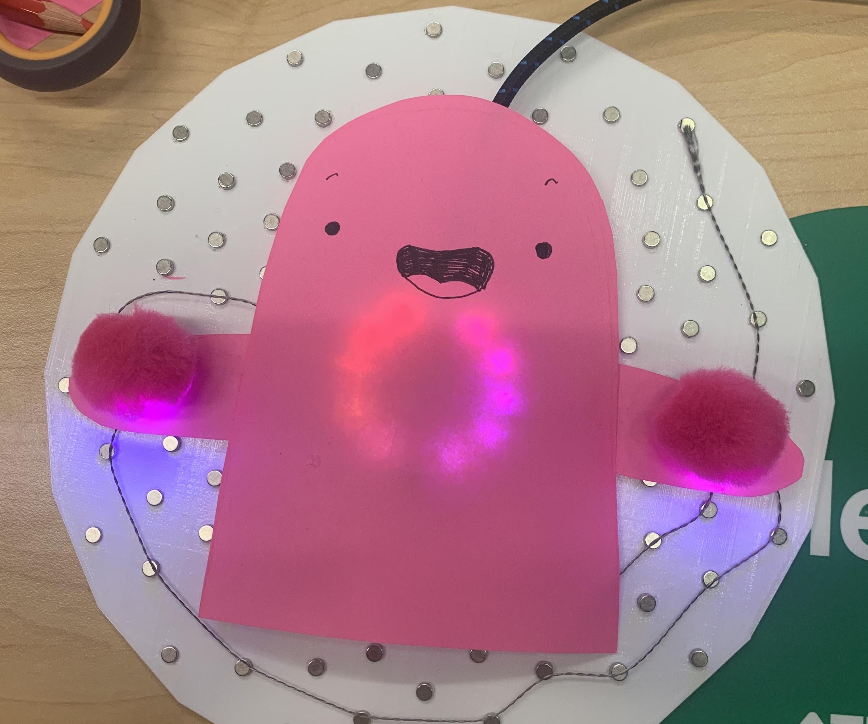

Step 2: Attaching the Lights
When making your spoke covers, you need to start out by laser cutting a piece of frosted acrylic to the size of your wheels. Measure the diameter of your wheels (within your grips), this will be the size of your outer cut -- I recommend decreasing the size by a few inches to make attachment easier. Then measure the diameter of a small circle around the hub of your wheels, this creates an area for your circuit board to fit through and attach to your decor.
When you have your acrylic cut, you now need to attach your neopixels. You can change the placement and size of your neopixel ring depending on the length of your strip, just make sure that you change the number of LEDs in your code depending on the length of your strip. For this design, you need to use the waterproof model of neopixels because it comes in a flexible casing that allows you to attach the neopixels on their sides.
Place your neopixels in their desired location and shape, and then lightly trace their shape. Set the neopixels to the side, and lay down your E6000, following the traced lines, and then put the neopixels on the E6000. Make sure that the LEDs of the strip are facing outwards, this will make the glow shine in a wider area rather than just a small circle.
To keep the neopixels in a circle, I recommend feeling your hookup wires through the casing of the opposite side and then cutting a small hole to pull them through. This not only holds your LEDs in a circular shape better but also protects the connections. If you do choose to use this process, you must do it before soldering the wires to your board.
Once the neopixels are laid down on the E6000, you can stabilize them more by adding glue to the inner sides of the circle. This creates more points of attachment and helps to keep the strip upright. If glue leaks to the outer side of your circle, you can clean it up by waiting for the E6000 to become tacky, and then cutting and removing it with an Xacto knife. Depending on the size of your central decorations, this may or may not be necessary, so it is a completely optional step.
The final step for your spoke covers is adding self-adhering velcro to the inside (the size where you have attached your neopixels). You must make sure that where your velcro attachments are line up with the layout of your spokes. If your wheels have two layers of spokes, making your velcro strips long enough to go through both layers of spokes makes attachment easier. Once you've laid out your velcro placement, glue them down to your acrylic with E6000. To hold them in place while they dry, I recommend using alligator clips.
