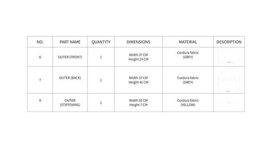

Step 2: CUT FABRIC BY SIZE
LINING (FRONT) 37X24cm
LINING (BACK) 37X41cm
POCKET (BACK) 32X19cm
POCKET (FRONT) 27X19cm
LINING (STIFFENING) 91X17cm
OUTER (FRONT) 37X24cm
OUTER (BACK) 37X41cm
OUTER (STIFFENING) 91X17cm

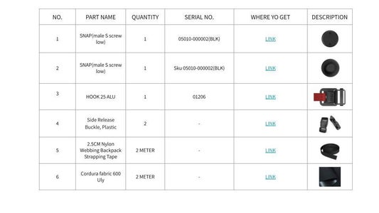

Step 5: SEW STRIPS TO CLIPS
Take the straps and thread each one into the clips and fold down as in the pictures.
Note: Sew so that the rest of the strap is at the back. (see materials list)

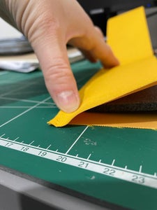

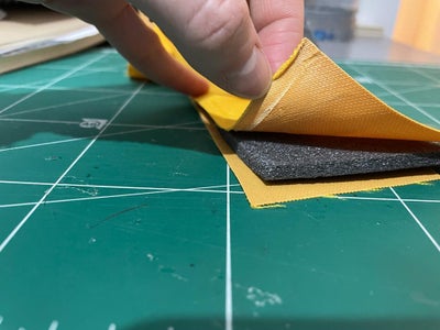

Step 10: STIFFENING
Take the two pieces of fabric named STIFFENING (OUTER and LINNING) and sew them together when the spong is leying between the two layers.
See attached images.
