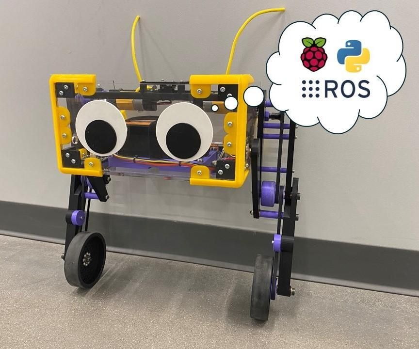

Introduction: Wheeled Self Balancing Robot: ROCKO!
For those who want to experiment with robotics, ROCKO provides an interactive platform for people to experiment with PID control tuning, joystick driving, autonomous navigation with vision sensors, and more! It was developed to provide a next step for those who have some basic programming or robotics experience already and want to dive into more advanced topics.
What makes ROCKO different from other robotics projects?
  1. Can stand on two wheels in balance mode using a pitch and velocity PID controller
  2. Legs fold up to convert to a tank drive mode with joystick
  3. Runs on a Rasberry Pi 5 implemented with ROS2, an industry standard middleware for robotics
  4. Opportunities for adding more sensors like LiDAR for vision and autonomous navigation
  5. Program in Python or C++
