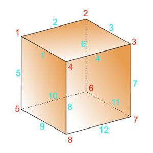

Number of Vertices and Edges of a Cube
A cube has: 8 vertices, 12 edges, and 6 faces.
Let’s plug these values into Euler’s formula:
8−12+6=2
2=2
Thus, Euler's Formula confirms that a cube is a valid polyhedron as the values substitute correctly into the equation.

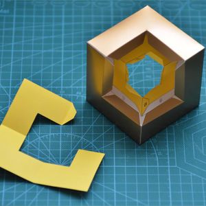

For visual understanding, we suggest assembling a model of such a polyhedron from cardboard. You can download the layout for assembling the cube with an edge length of 66mm here:
To assemble our model, we will compile it from three parts!
First Step: Take the first part and connect it to form a ring!
Second Step: Now glue the second part to our ring.
Third Step: And the final step! Attach the third part.
We obtain a toroid based on a cube.
